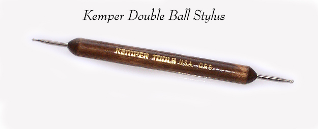

    Was wondering what and where I may find pieces for a knot tying tool kit. I'm improvising but can see I may be doing damage to paracord as I try to wedge in there (I'm defalting to fly tying tools )
    Any suggestions as to where and what one should have for knot tying? Trying to think of tools that have dull points etc.

    Thanks A few of the tools I often use with knot work are:
    Hemostats/forceps, which are good for pulling/tucking cord. They sometimes come with somewhat sharp/jagged teeth that need sanding down a little bit around the edges, so they don't catch/snag on the paracord.
    Clay stylus, which have a rounded point at the tip which helps work slack out of monkey's fists and turks head knots.
    Perma-Lok lacing needles for working/feeding cord around turks head knots, and half hitching/needle hitching projects.
