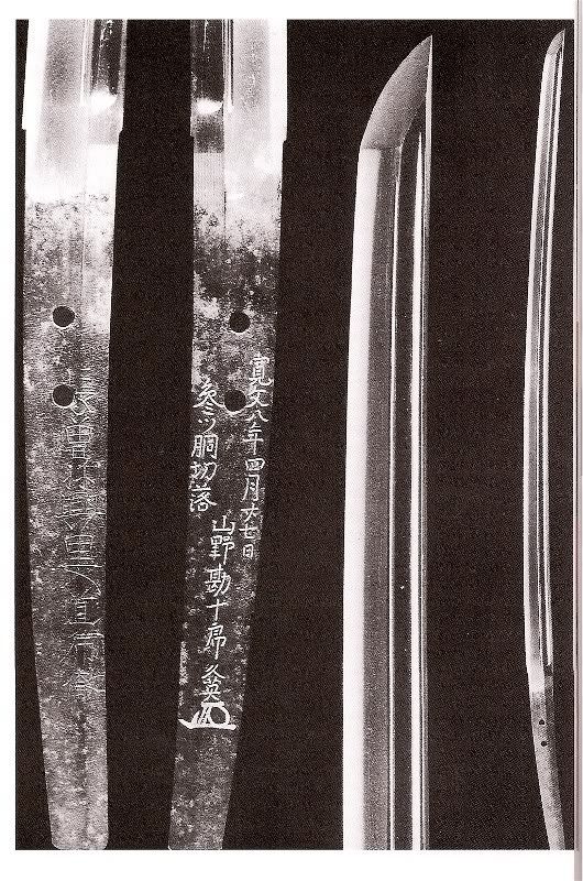

    Keeping in mind you’re a sword maker so as not to ramble on to much since your interested in mainly cutting performance I would start by researching a 17th century smith by the name of Nagasone Kotetsu. His swords seem to be held in high regard for cutting ability.
    This is one of his swords. The Tameshigiri inscription says it cut through three bodies. Tameshigiri at that time was performed on live prisoners or criminals.
    The handle and furniture on the swords were subject to change. A change in rank might require a different handle wrap as well as different fittings. The sword might have two handles one for EDC and one for court. The material used for the furniture varied greatly from horn to silver, gold and iron, in addition simple or complex designs also effected the weight of the furniture. The balance of the sword can be affected buy theses changes. Presumably an attempt would be made to match the handles so as not to effect the balance to greatly but then again maybe not.
    Very complex swords...

    neat, the fullers are very deep, any idea how thick swords of this time were? looking at the way the planes intersect they must not have distal taper....

    Quote Originally Posted by wnease View Post
    There usually is distal taper in Japanese pieces, but one thing to bear in mind when examining nihonto is that since the sharpening process removes an entire skin from the blade, those blades that have come down to us may be a lot lighter or thinner than they were when new. It always presents something of a puzzle.
    I have not ran across any hard stats on the blade thicknesses. It is true that the polishing process does remove material however you must also take into account that polishing is not done frequently. These blades were taken exceptionally good care of during their working life.
    This blade was designed for exceptional cutting and looks to be fairly long. The fullers would have been necessary to help reduce the overall weight. While not immediately apparent in the photo the blade probably has a distal taper. Mass distribution in the blade is controlled with fullers, distal tapering and tapering.
