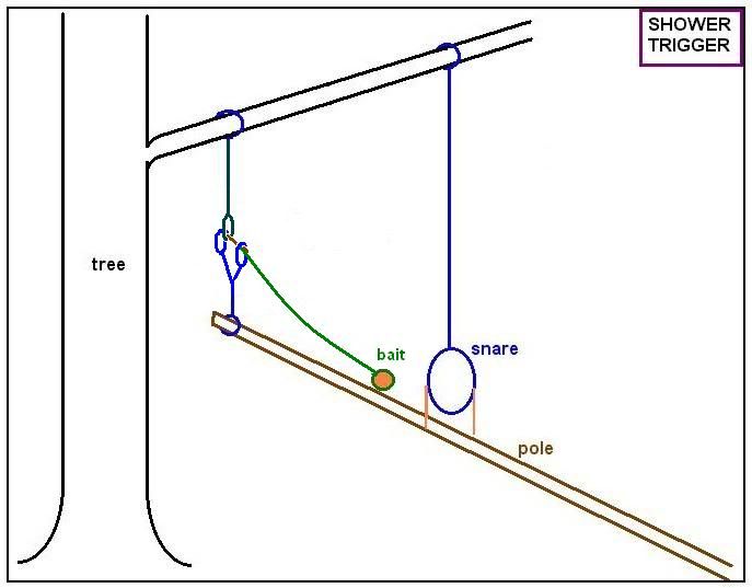

    Next, a simple lifting-pole neck snare, triggered by the bait being disturbed - I think Coote's pictures, demonstrate this well.

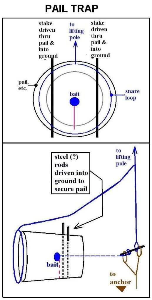

    A pail trap, to ensure the critter sticks its head through the noose. The angle of the snare to the lifting pole cord would not be as extreme as shown by the drawing.

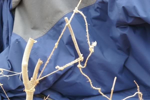

    A few years ago, Slasher, Phil and I were camped out and decided to play with the nail trap trigger. Here's a picture of it made with Wood Nettle (Laportea canadensis) cordage and a stick. You might notice that this was the original method I used to locate the anchor loops. It was tied to an old cut off shrub shoot.
    The reason I had the coat behind it was

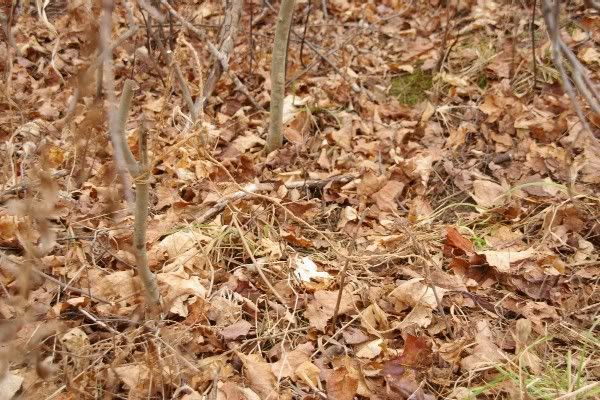

    tied with natural cordage, you can barely see it in front of the leaf litter.
    Anyway, however you tie it or set it, the Nail Trap Trigger is a beauty. Give it a try, the next time you're outdoors. Set it properly and you should have it nailed.

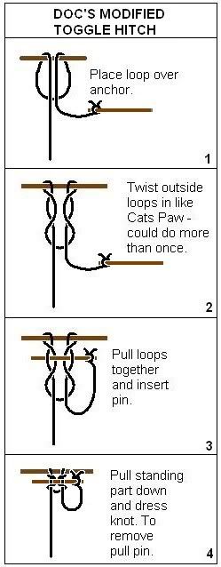

    Hey chopchop, while I was waiting for my wife (in WalMart) I was thinking about your attempt to make the anchor loops with a single loop around a stick. It gave me an idea, which I tried, and it works!
    Basically, I positioned the ends of the loop, so that one end would be longer than the other, and I secured this adjustment, with a modified Marlinspike Hitch, keeping in mind not to make the anchor loops too long (or the lower loop will continue to slide off).
    At the moment, I can't think of any advantages it has over the Bowline in a Bight, but I'm going to think on it some more.

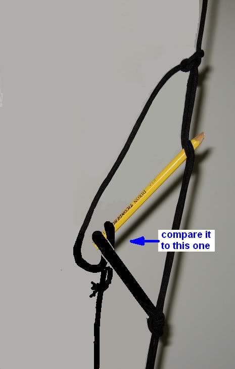

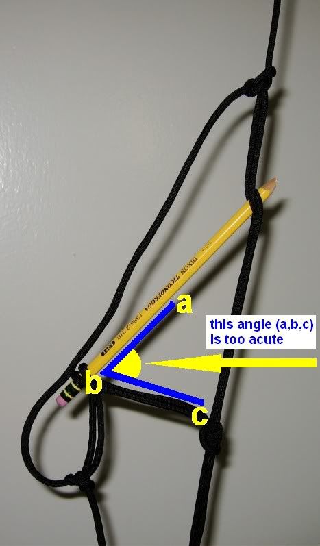

    Finally got a bit of time to play with this a little more. Weather's not great here though, so I'm playing with it at home. Nothing crazy today, I just wanted to get the basic trap working. I did get it triggering this time.
    Set-up:
    Videos I wanted to include slow-motion playback of the trigger with the first two videos, but, apparently, my version of iMovie doesn't allow me to play with speeds.
    Triggering:
    Close-up of trigger:
    I still need to work on sensitivity. As demonstrated in this vid, sometimes it seems a bit of tension is required to tripper the trap. Actually, now that I'm thinking about it, the paracord could just be getting caught on the metal collar at the end of the pencil. I'll play around with it more.
    Suggestions for improvement, Doc (or anyone else)?

    Nice. I really like the look of these various toggled knots. I'm going to have to play with them and see what happens.
    One advantage might be that it could be easier to untie if you've left it out for an extended period of time. Does a bowline on a bight bind under load? I don't think a marlinespike hitch will. On the downside there could be problems with the snare getting hooked on the spar if it's windy or something.

    Russell,
    The angle between the anchor loop and the pencil is too acute. It's the same problem you had with your first attempt. Compare the two pictures, below. Also, if you're going to use a pencil, have the rubber on the upper end - it provides more friction than the wood.
    chopchop, depending on the type of cordage you're using, but normally there wouldn't be that much load to jam the Bowline in a Bight.

    Yes, I was paying attention to the wrong angle. For some reason, I thought the angle centered on C had to be 90. I should have reviewed your earlier critique before trying again I understand why angle ABC has to be 90 or greater, and I'll fix it next time.
    As for the pencil, it was just something at hand. I'll be using a found stick next time.
