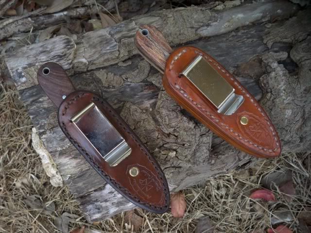

    I'm getting ready to start an order for a boot dagger. Found a couple pictures of leather sheaths that I'm going to draw inspirpation from. The metal boot/belt clip is held to the back of the sheath with a sewn piece of leather. It's held to this piece of leather with a rivet (or eyelet on one of the pics I have).
    Do you usually select a rivet as close to overall thickness as possible or slightly smaller?
    Also, another question on this sheath. I can't tell if the belt/boot clip is only secured to the sewn leather piece or if it is riveted all the way through the backside of the sheath?

    These two pictures are from a Al Stohlman book, where among many other things, he illustrates the proper length for rivets. Hope this is helpful.
    The reason for mounting the belt clip to that piece of leather is so that the back of the clip is sandwiched between two pieces of leather, thus keeping metal away from the knife. So the rivet is also sandwiched the same way.
    Hope this is clear.

    That square on the back really isn't necessary if you line the inside of the sheath, the look is much cleaner.
    I use a 3 ounce lining leather on the inside and 7/8 on the outside. The rivet is the "small" size, I can measure out one if you need. The head is smaller than the standard ones as well. Now Tandy carries an ultra small rivet, tiny little buggers, I cant for the life of me figure out what they are for.

    Since the first photo in the OP's post is mine and of a sheath I made, I'll comment
    The clip assembly is riveted only to the patch of leather.
    No metal comes near the blade.
    The other reason for the patch was a recess that I cut into the leather to allow the clip to securely lock in. There is a rectangular hole right where the bend in the clip contacts the leather of the patch.
    In the past I've had these clips ride or slide off of a thin belt or waistband of my pants.
    I got the patch with slot idea from my Gerber Mark 1 sheath.
    I'm flattered that you saved the shot of my sheath and used it here.
    If my explanation wasn't clear enough I can shoot a better photo.
    Good luck and post up your finished piece.

    Thanks for the responses! Eb, when I was first looking for boot sheaths, yours is the first I found that really struck me as a nice piece, and one that I wanted to replicate. Leatherman, yours are extra nice too, thanks for the picture!
    In both of your experiences, are the standard boot clips 'thick' enough to accommodate a boot top? All I have found measure .25". The sheath is going to be for a police officer and will have to work for the type of boots they wear.

    Yes, the type of clip shown on my sheaths there are new from Tandy, they offer a wider bend to accommodate a thicker material to clip to. SWAT boots have a heavily padded upper therefore you need a clip that will easily go over that. Just don't tell the fellow that the extra room was originally intended for purses. These also don't have that "hump" in the lower part that is so difficult to work around. I can get the item number off one if your curious, they also come in black. I use both the "hump" version and this shorter version quite a bit. The ladies, and well most everyone else, loves the short clip for its wide bend, it clips to so many more things than the narrow bend ones do.

    Yea, they are very stout little clips, fully as wide and strong as its stablemate. At the thickness of leather I use, 7/8 oz, the hump all but vanishes and becomes useless but for a pain in the neck to cut the slot in the right place.
    part number is 1240-00 for the nickle plate
    1240-24 for the black
