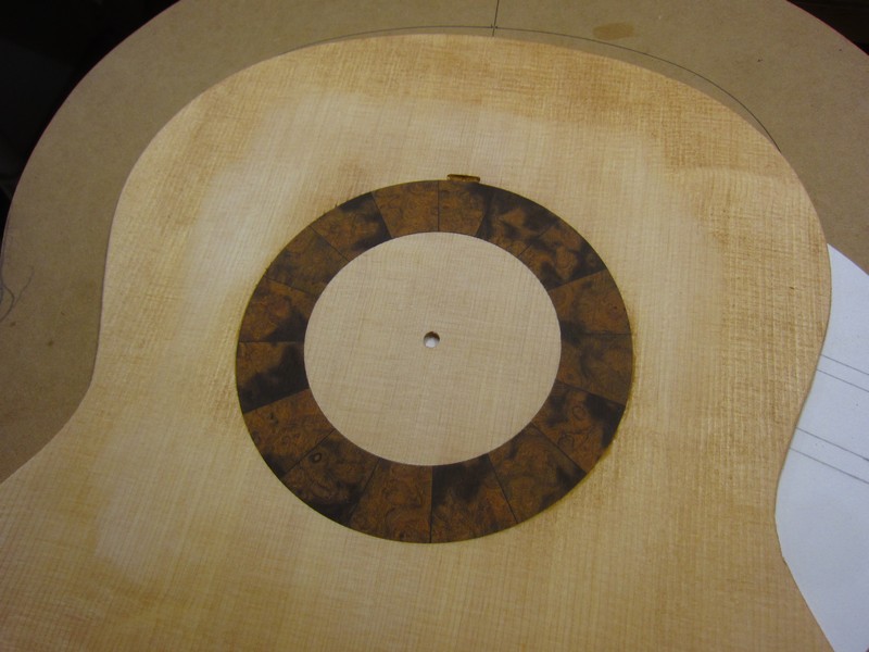

    I'm using osage orange (which grew in my backyard) for the back and sides, and the soundboard is Sitka spruce. The neck is mahogany, and the binding is curly maple. The bridge, fretboard, and rosette are desert ironwood.
    This isn't going to be a real in depth thread, because I don't have the time right now, but hopefully some will find it interesting or helpful.

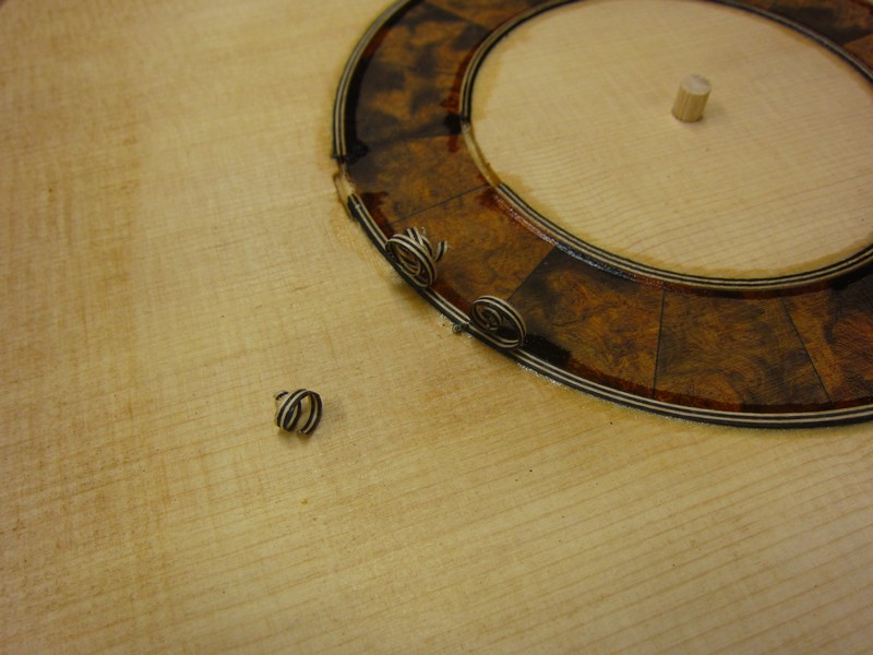

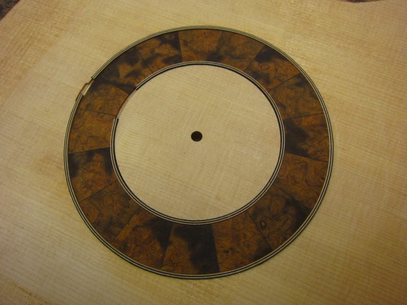

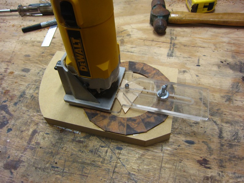

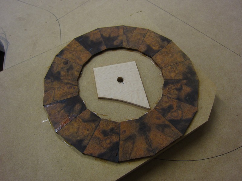

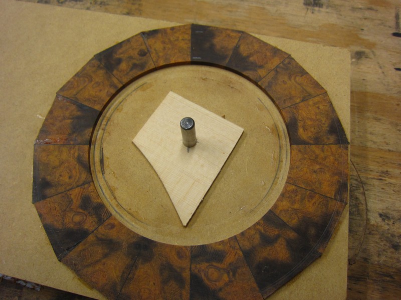

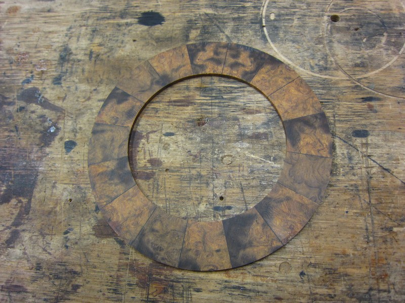

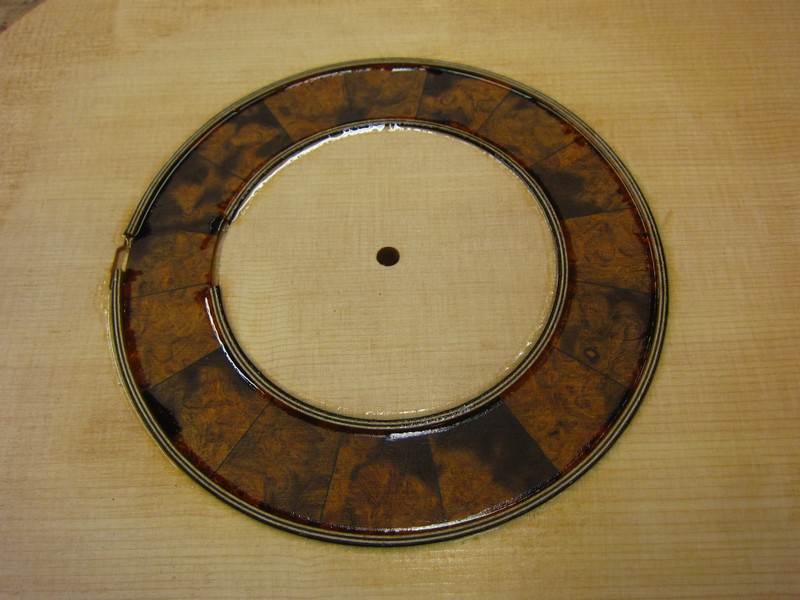

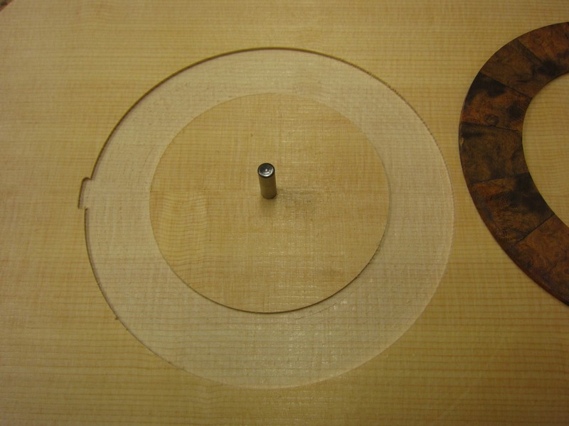

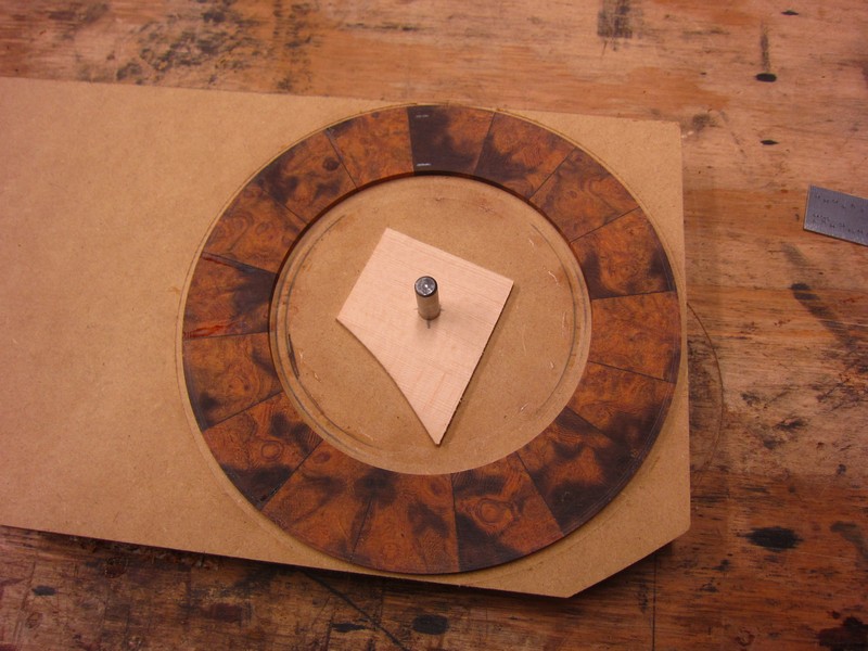

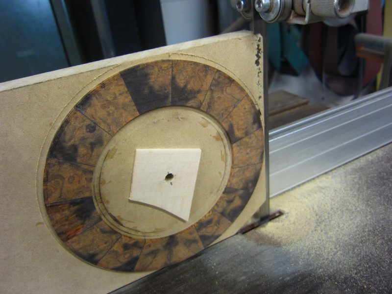

    One of the first things I do is the rosette. This one is what’s called a radial rosette. It’s made by cutting a bunch of wedges of wood (desert ironwood burl, in this case), and gluing them to a sacrificial board with some black strips in between:
    Then a router with a circle cutting jig is used to make it round on the inside and out:
    Now the ring is cut free of the board:

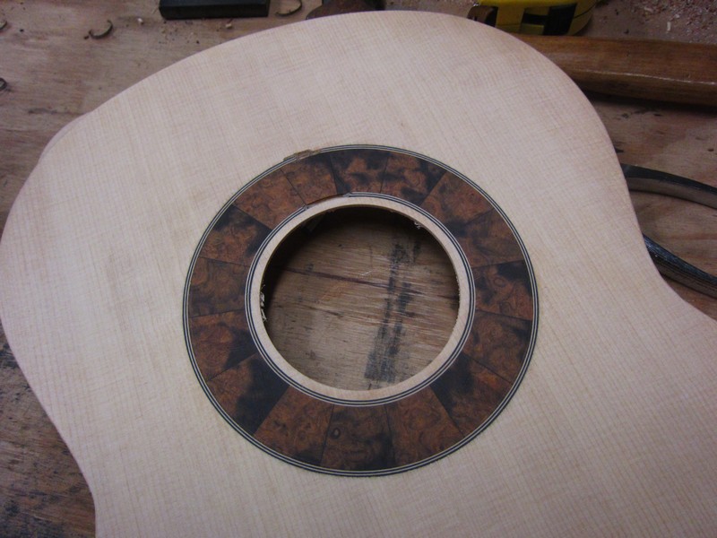

    Now the channel is routed out on the soundboard:
    And the ring is glued in:

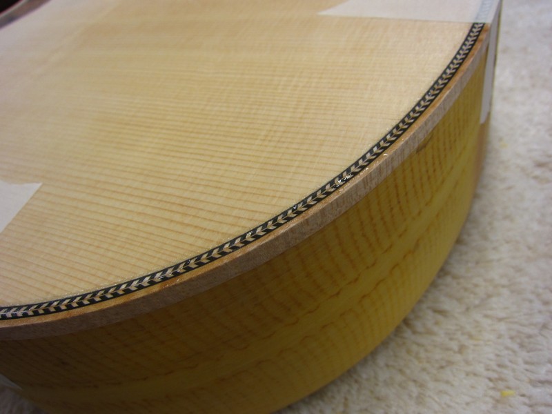

    Next, the main ring is sanded flat:

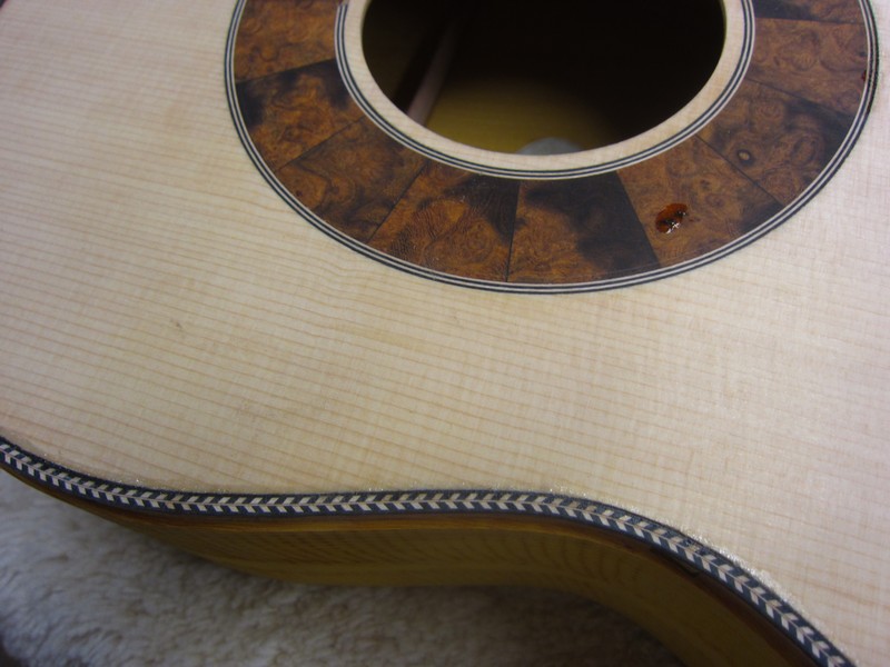

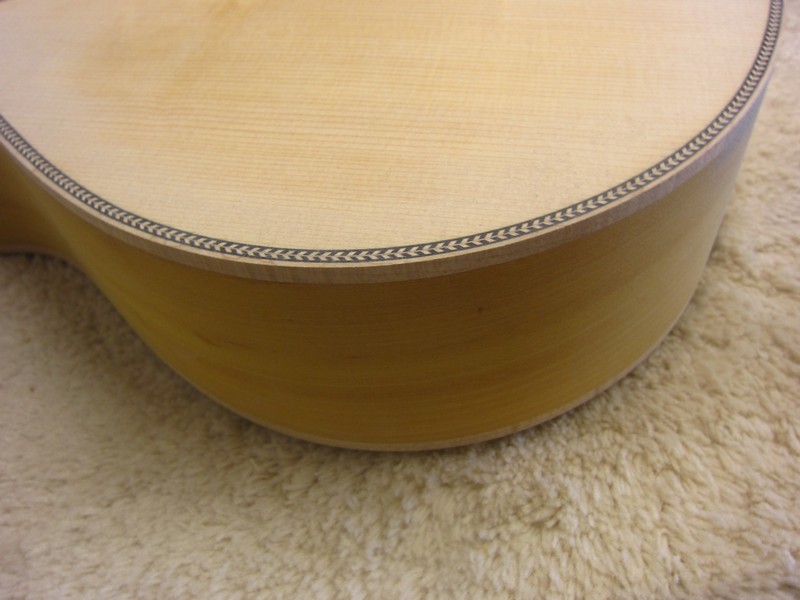

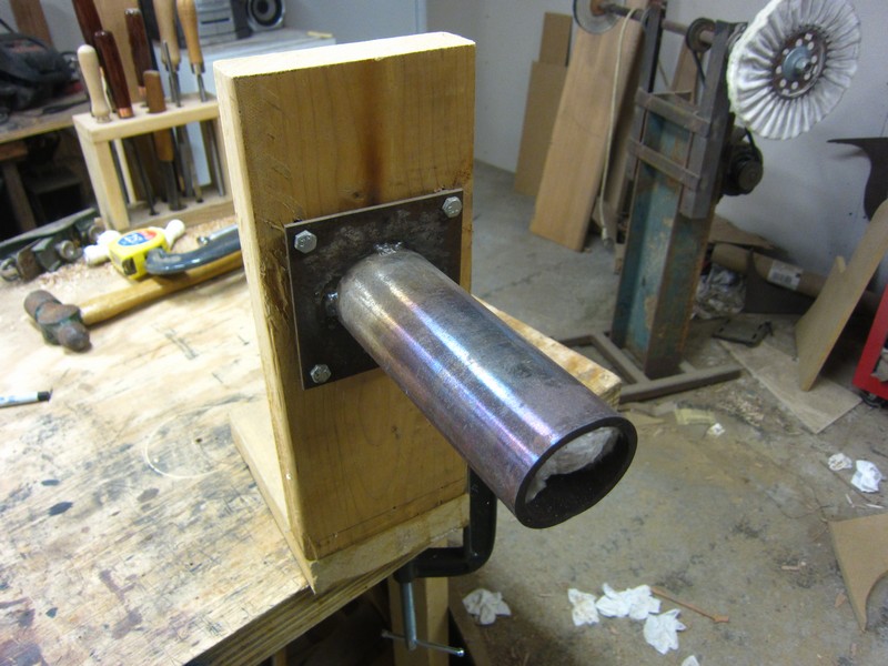

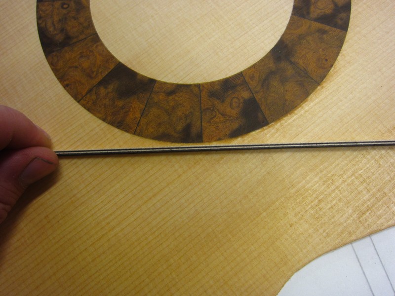

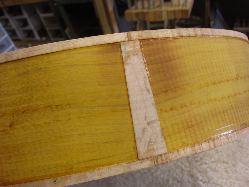

    Now there are two rings (called purflings) that go around the inside and outside of the main one. These are white and black laminated veneers:
    As you can see, it’s straight. So, I have to bend it. I used my bending iron, which is heated with a propane torch:
    I didn’t get pictures of routing out the channels, or bending, but here’s the purflings in their channels:
    Now the purflings are flooded with Crazy glue:
    After the glue is hard, the extra is carefully trimmed off with a chisel:
    Then it’s all sanded flat:

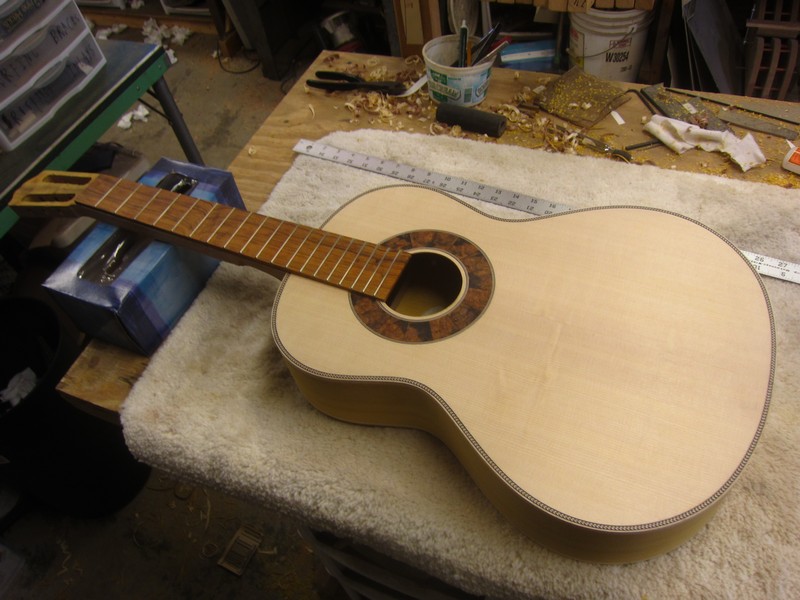

    Now it’s ready for bracing. The figure of this will really pop when finish is applied.

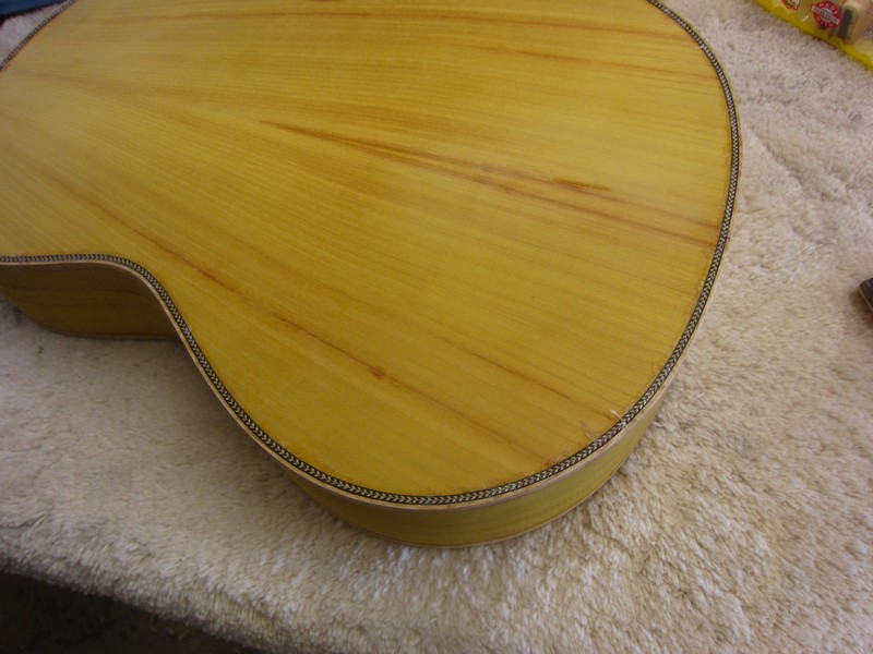

    So, here's some more pics.

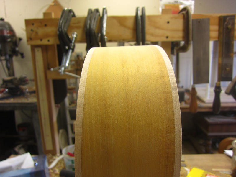

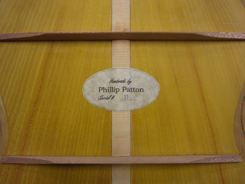

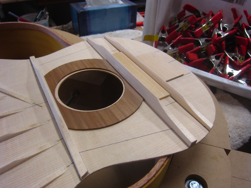

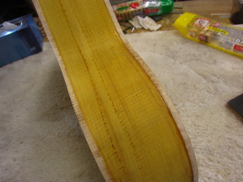

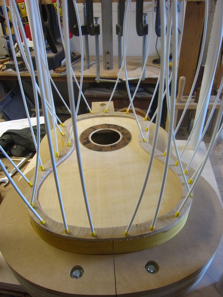

    The bracing:

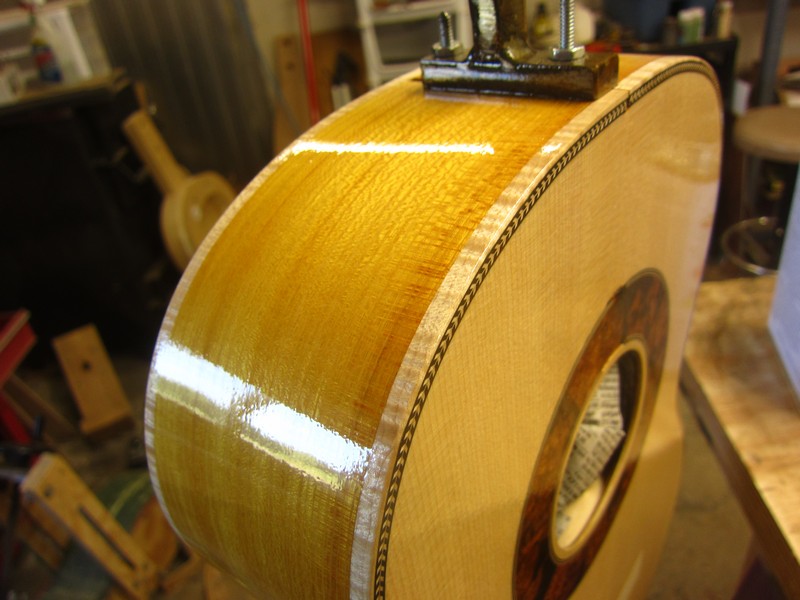

    Gluing the top to the sides in my new go bar deck:
    My label:

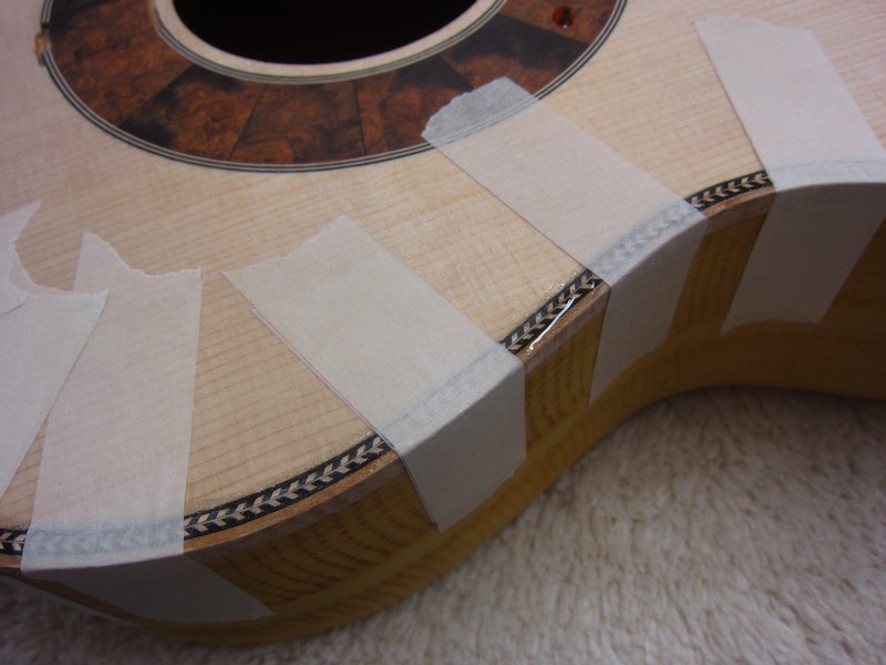

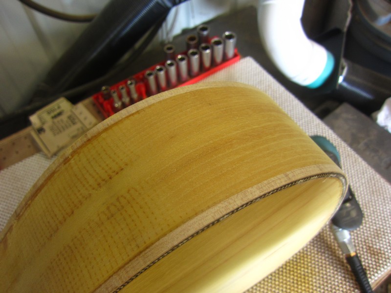

    Putting on the binding and purfling:

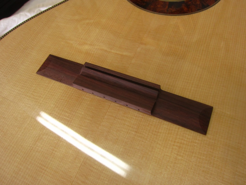

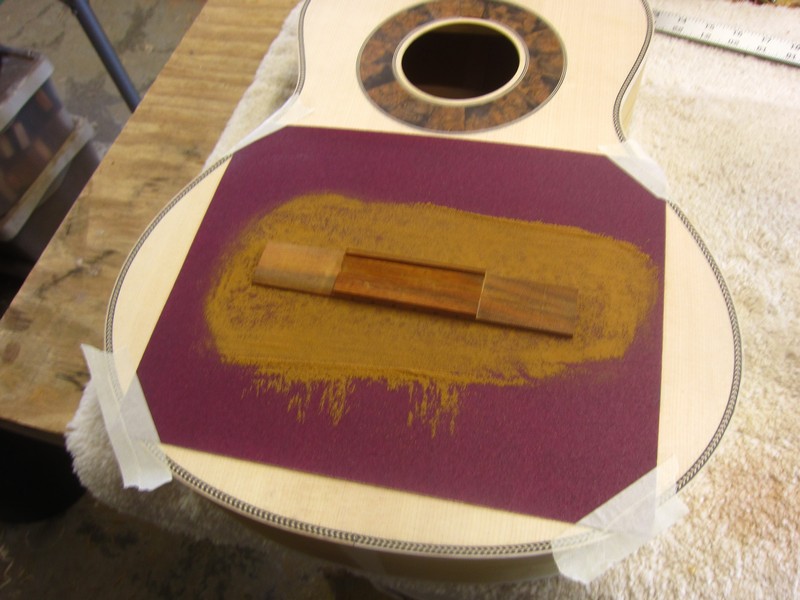

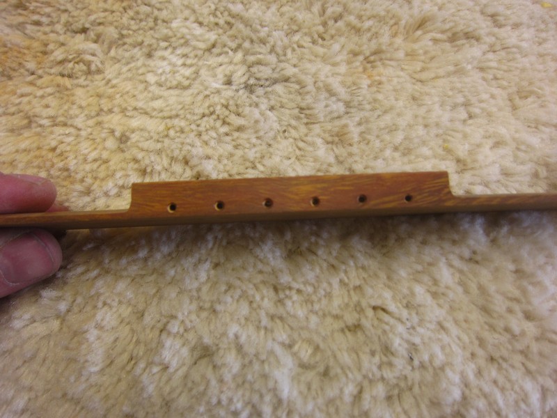

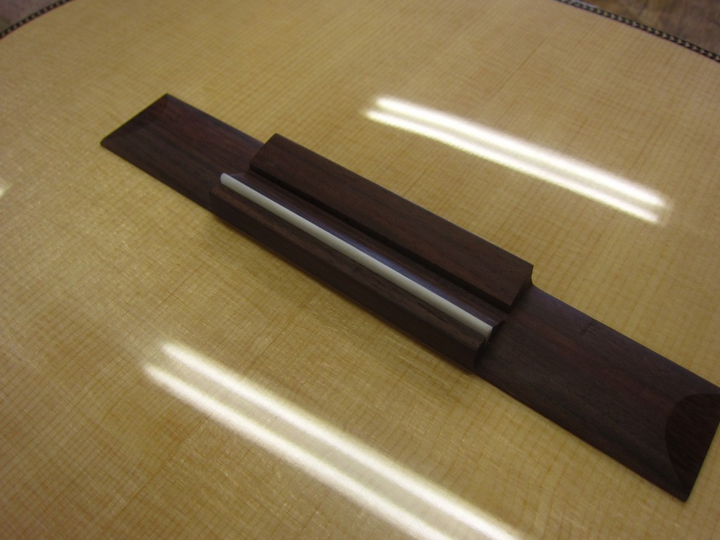

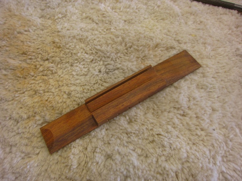

    The bridge:

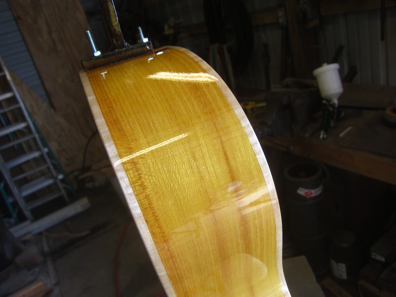

    Spraying:

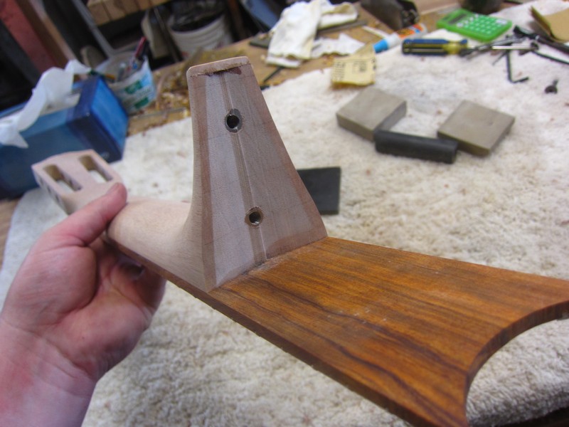

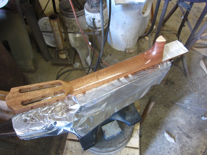

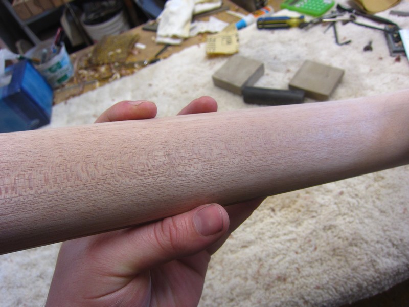

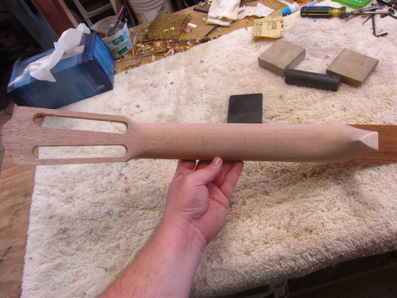

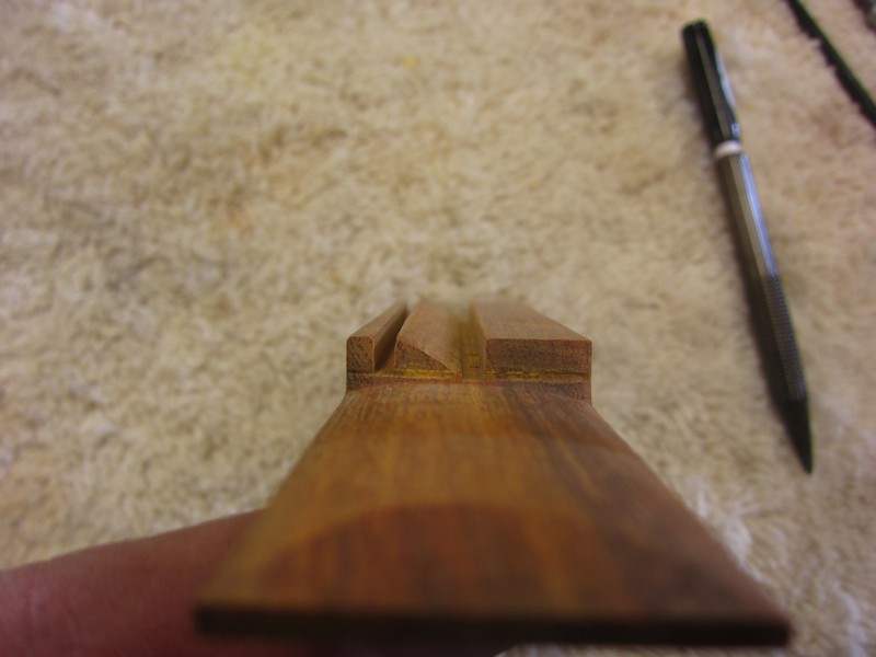

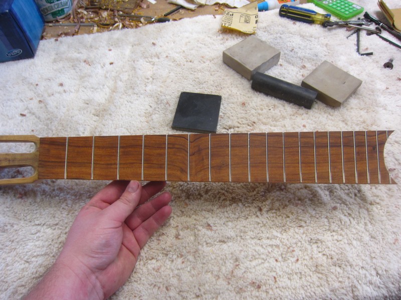

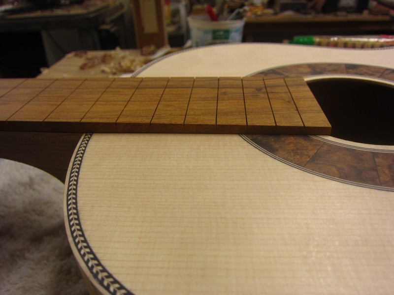

    The neck/fretboard:
    And that's all the pictures I have for now. In a week or two, if the lacquer is hard enough, then I'll finish it.

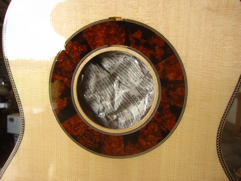

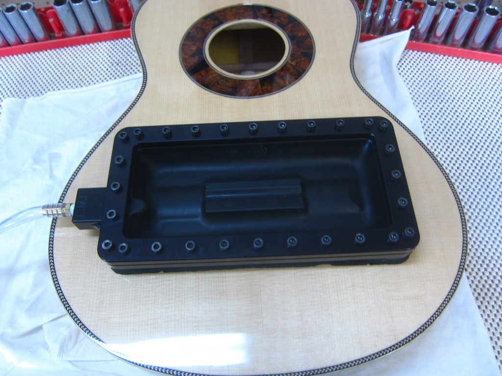

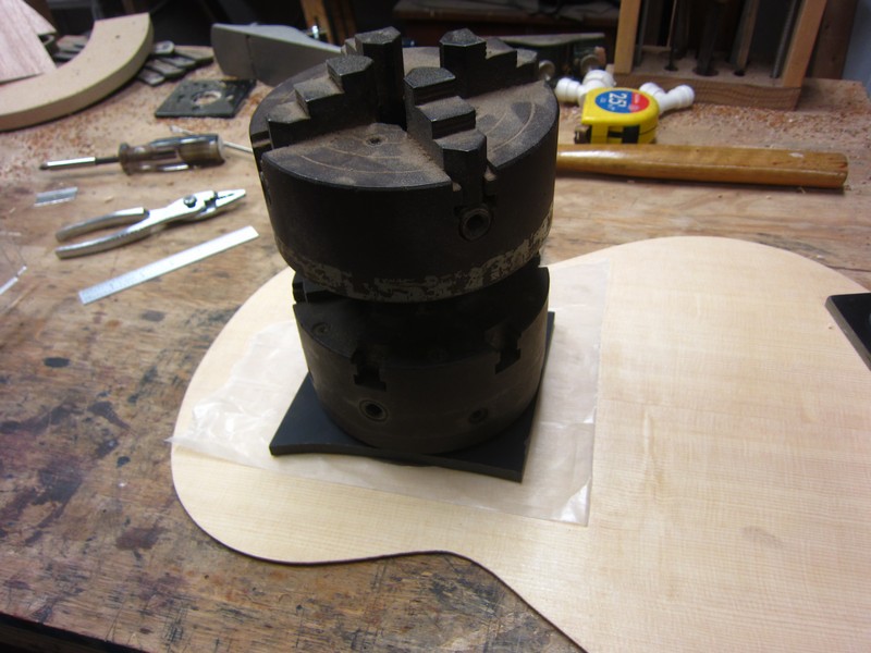

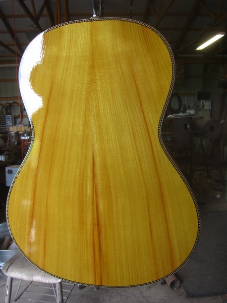

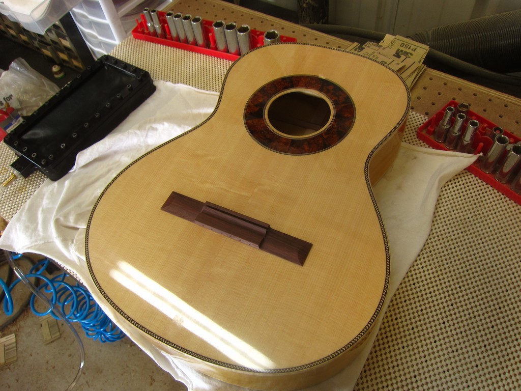

    Here's some more pics. Yesterday I "finished the finish". I used an orbital sander with 400 grit to level the lacquer, then 1000 grit to remove those scratches. I usually go higher, but decided to quit there and see how it looks. It's not too bad. If this were for a customer, I'd put more time into it, but this is for me, so I'm stopping there.
    Then it gets buffed to a mirror shine.
    Then the bridge is glued on. The bridge I showed earlier was desert ironwood, but I decided to make one out of rosewood for a couple reasons. One, DI is too heavy for a classical bridge, and two, I made the saddle slot too close to the edge, and I'm afraid it might split there.
    I used to use deep c-clamps to glue the bridge one, but now I use a vacuum clamp, which is soooo nice:
    The way it works is, you apply glue to the bridge, put it in place (a masking tape border is used to make sure it doesn't shift around) put the clamp on for 10 minutes, clean up the glue squeeze-out, then put the clamp back on for 20 minutes.

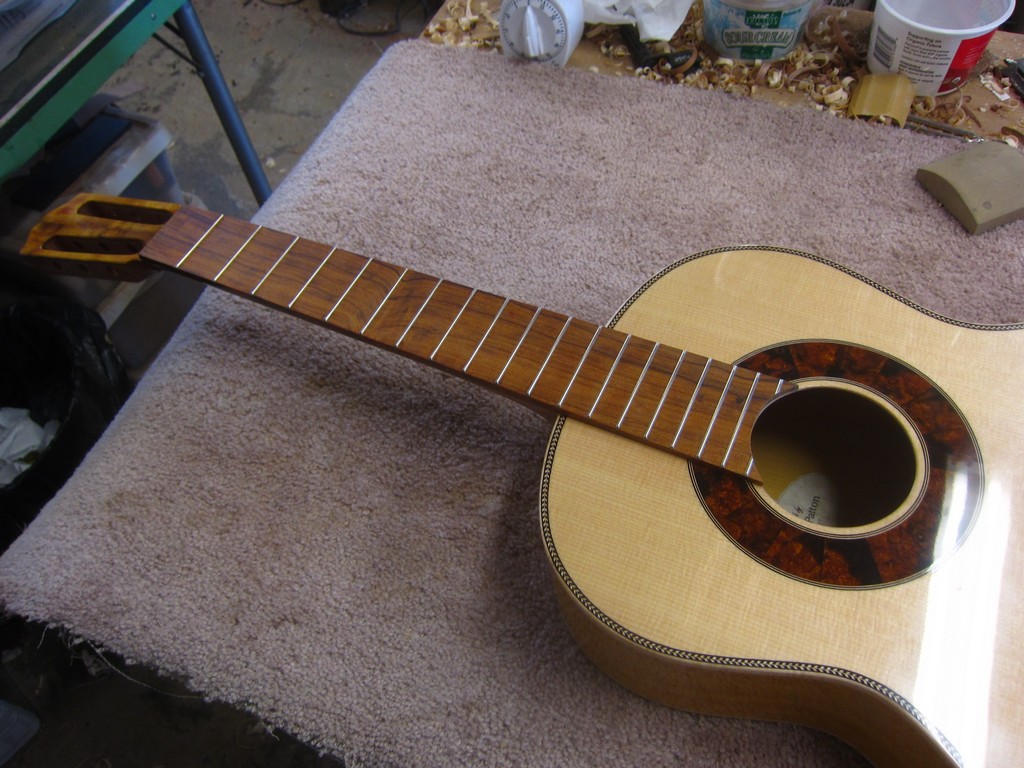

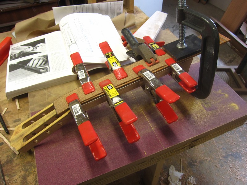

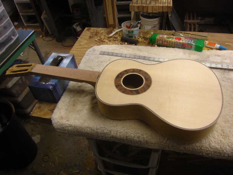

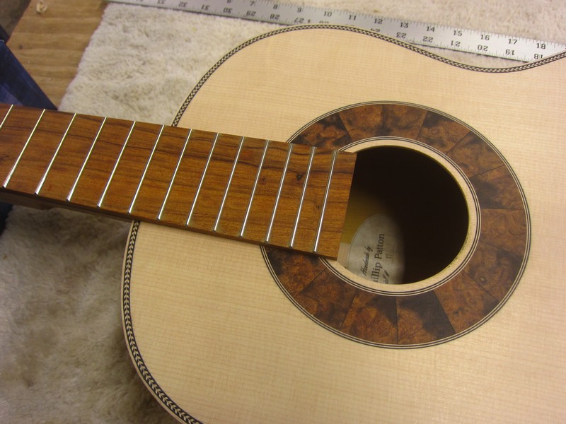

    Now I've got the neck bolted on:

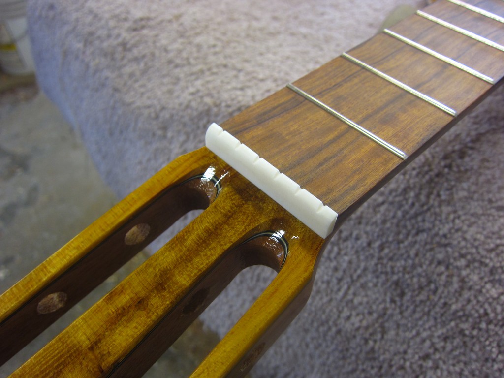

    the (bone) saddle made:

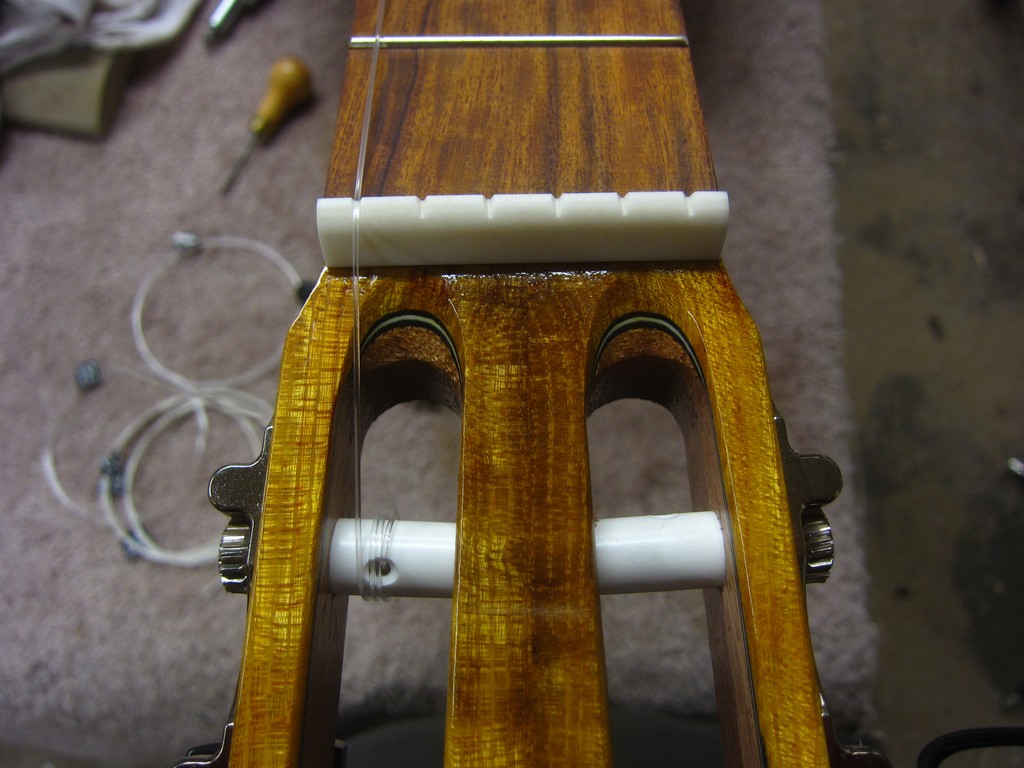

    and the nut (also bone) made:
    That's all I can do until the tuners arrive Friday.

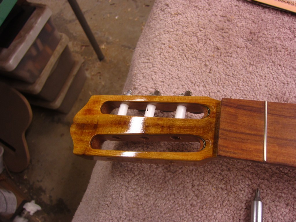

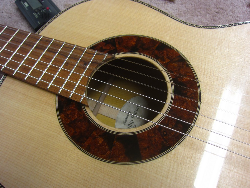

    OK, here's the semi-final batch of pictures. I need to find some good lighting to take some glamor shots, but here's some of installing the tuners and stringing it up.

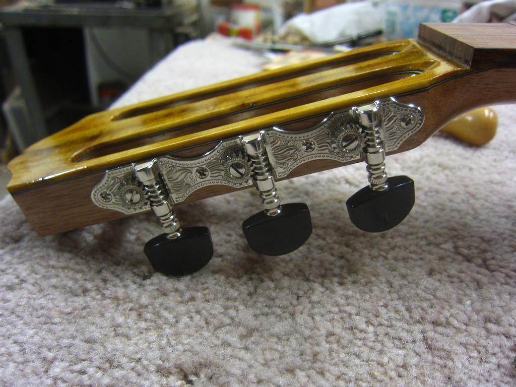

    First tuner:
    Both tuners:

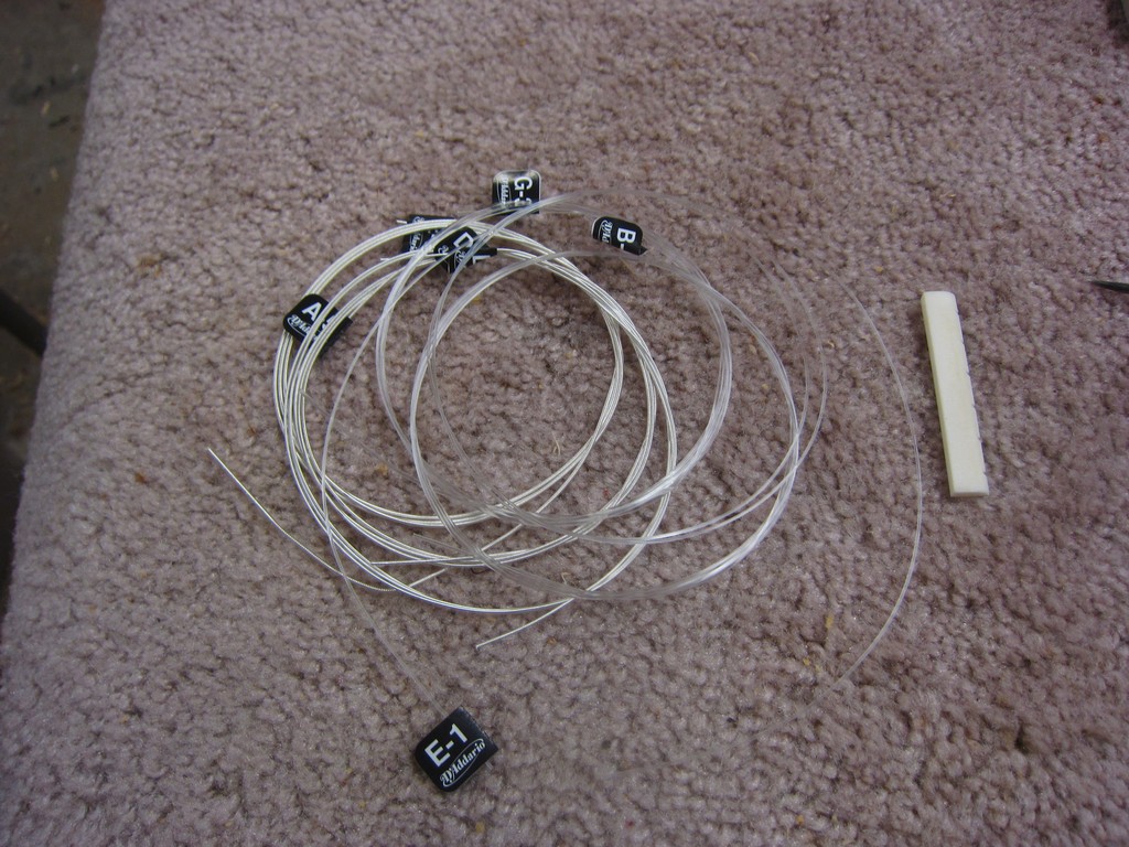

    Now, I put the tuners on the wrong sides. In my defence, I looked, and one was marked "L", which I took to mean "left", and one was marked "R", which I took to mean "right". Sounds logical, right? Well, I installed the one marked "L" on the left, and the one marked "R" on the right, and it was obviously wrong. So I took them off and put them on correctly. Now there's a couple screw holes to fill.

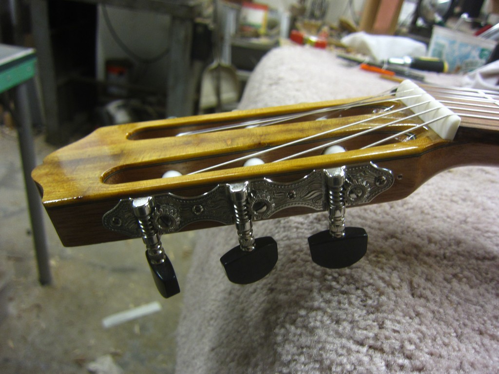

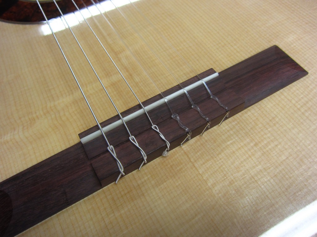

    The strings:
    Putting them on:
    Then action is too high, so I'll have to adjust the neck angle, but that was expected. I'll let it settle in for a couple weeks before I do that.
    They say you shouldn't judge the sound of a guitar right away, because things will change over time, but it does seem better than my previous classicals. It's louder, and the trebles and bass are more balanced.
