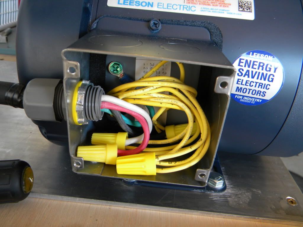

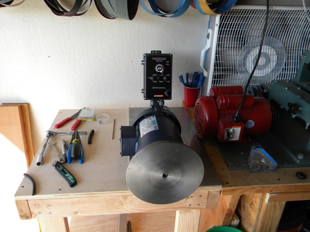

    Ok, here are a couple pics of the disc grinder installed....
    Getting motor wired up:
    The box all finished, ready for cover to be reinstalled:
    All fnished and clean....time to get it dirty!

    If you haven't done it already, just swap those wires, red for white on the motor, and your switch will behave like you want it to.

    Done. I feel better now

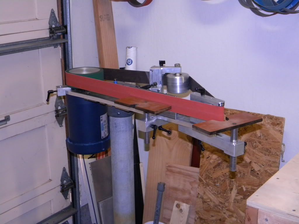

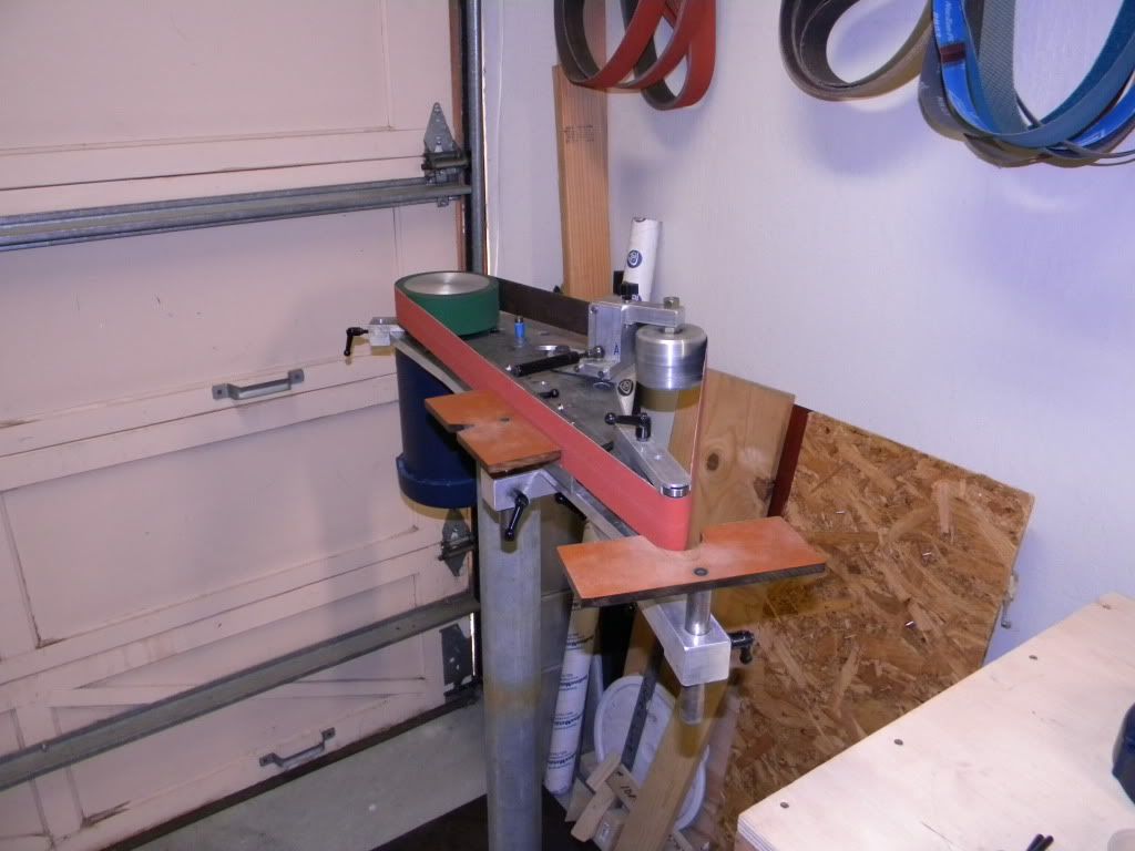

    Okay, my buddy was able to get me the pipe this weekend and we welded it up to some 3/4" plate to complete the stand for the horizontal grinder. Seems like a good fit and it feels nice and stable. Now I just need to make some final adjustments, get the VFD wired up and mounted to the bench, and pick up a few odds and ends and it should be up and running soon......

    Brian Fellhoelter built this one. I was talking with him about grinders way back in November or thereabouts, and he mentioned he might be selling this one, so I jumped on it. Looking forward to getting it going.

    Thanks Greg! There will also be a third work rest that I still need to build for the six inch contact wheel, so this will be really versatile. Small wheel, platen, and six inch wheel. Should be able to cover a wide range of stuff.

    Had a little time and got the motor wired up today. Waiting on some 1/2" aluminum plate to build a bracket to mount the VFD on and some power cord to run it to the 220. Gettin' closer.

    Today, in between grinding bevels on a big batch of CPM D2 I just got back from heat treat, my buddy came over and we welded up a mount for the VFD on the horizontal. Fits nicely with plenty of clearance for belts, but is nice and beefy. New 220 circuit getting installed on Sunday morning by an electrician friend of mine and I'll get the wiring finished up and it should be runnin'!
    Also, to update......just got to use the disc for the first time the other day, been cleaning up bevels on knives back from heat treat. Very glad I decided to add one to the shop. It really is an amazing tool for getting your bevels good and flat! I can tell I'll need a bit of practice to really get the hang of it, but the learning curve isn't too bad. I've been using a light touch and very low speed to get the feel of how it works and am already feeling ten times more comfortable than the first time I put a blade to the paper Thanks Nick, never would have thought about doing this if not for our visit!

    Alright, yesterday my buddy came over and we installed a new dedicated 220 circuit for the 2hp horizontal. I had the controller all wired and ready with a new SO cord power line and twist lock plug. We finished running the new circuit and plugged her in and off she went!
    Things are running smoothly and I think I'm going to love having this machine in the shop. I finished building a quick work rest from Micarta for the six inch contact wheel so all three work areas are now set up and ready to go.
    I did a bunch of profile finishing on some blades just back from heat treat that I used to do by being hunched over my MAP arm on the KMG before finishing up by hand in the vise with sanding blocks and dowels until my knuckles were all cramped up. With the new grinder it only took a few minutes to do a dozen or so blades! I love how Brian's design allows for the raising and lowering of the work rests to get full use out of belts
    Here are a few pics and a video of the new machine up and running...
    New 220 outlet. Glad I listened to those who encouraged me to do it the right way rather than slap a dryer plug onto a power cord and plug it into the dryer outlet.
    The grinder all set up with three work rests, 2hp, KBAC 27D controller, and a new 30 lb gas spring that I installed to get a little more belt tension to suit my taste.
