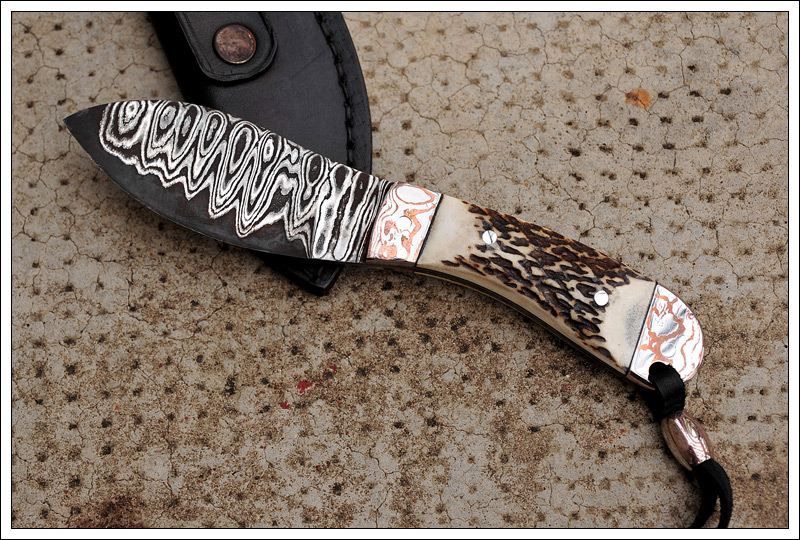

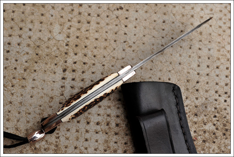

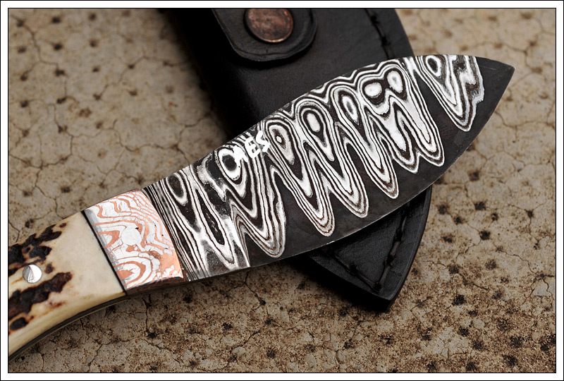

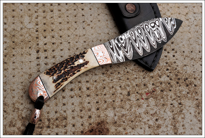

    Latest Nessmuk for a regular customer of mine.
    Semi Stainless Damascus Nessmuk
    San Mai damascus in 1010/304 with a D2 core.
Overall length is 8" with a 3 1/2" cutting edge. 3 3/4" from tip of the blade to the handles. 1/8" thickness.

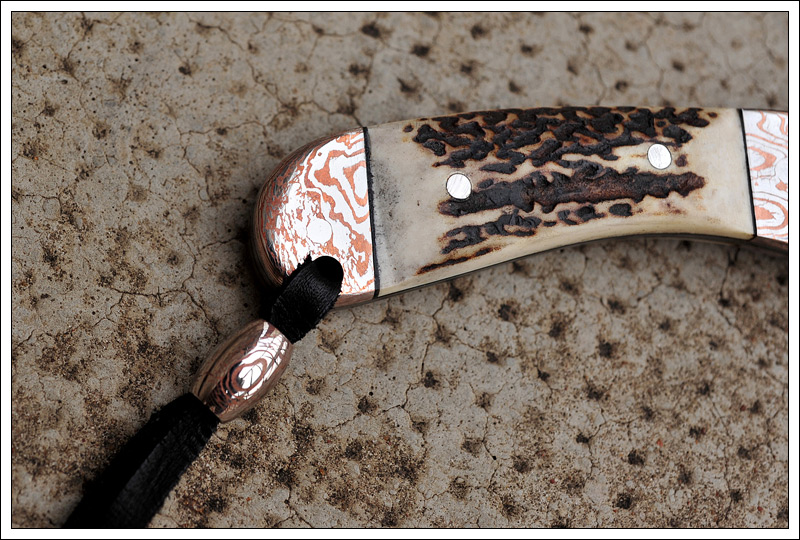

    Stag handle with mokume (copper / stainless steel) bolsters and lanyard bead. Heavy duty hand made leather sheath.

    I am in no way a fan of the nessmuk. I just dont like the lines. With that being said, that is friggin sweet! That is quite possibly the one and only newsy that I would ever own. Amazing!

    I agree that is a totally sweet nessmuk. However, I like nessmucks
