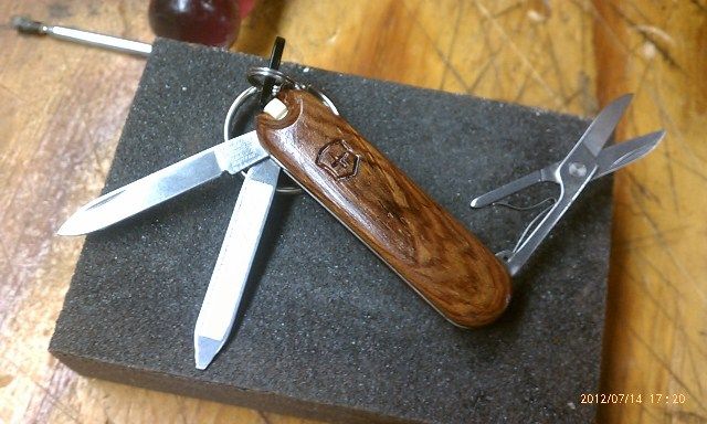

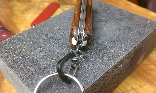

    It is extremely difficult and time consuming. The tolerances for the Sig Lite specifically are extra tough. You have to find that perfect thickness for the pen release. You need to have the thickness just right for the button to be flush and to still operate the light. The holes for placement are also very tricky. I would say easily 3 hours of work. This is after several months of skull training.
    I'm working on Classic scales, but to be honest the difficulty is still there. A lot of trial and error to have the toothpick and tweezers fit just right. And since I'm a touch anal about detail, carving the shield and cross are tricky too.
    All that said, it's not impossible and it is very VERY rewarding.
    Check out my carving thread on the edcforums for more SAK pics. I think they start around page 10.
    http://edcforums.com/threads/wood-me...arvings.95193/

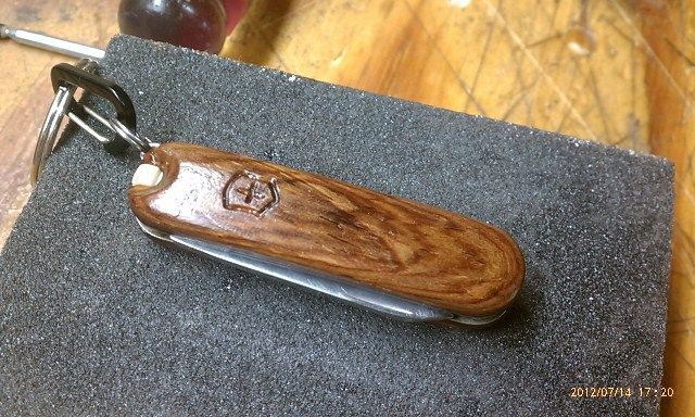

    Here are a few pics of a Classic with acrylic scales. I plan to do wood and thought I'd post these here since the wood will have a similar design. All hand carved. The tweezer/toothpick tab area has an indent on the scale since it's thicker than a traditional SAK Classic. It allows for a slightly thicker scale (very important for the wood models), but still gives access to the scale accessories.

    Here is a quick pic of some Cocobolo scales for the Classic.

    I carve the mounting holes wide enough to be a tight fit. On final assembly I use some loctite. I have no long term data, but the tight fit gives it a mechanical adhesion. The loctite is just a backup.

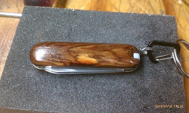

    Here are some near complete Cocobolo SAK Classic pics. I still need to do the final sanding.

    It is probably the most beautiful scales I've made. Light brown with a few spots of gold and orange. Cocobolo is all over the place with color. I typically see rich dark brown, but every once in a while I get something really amazing.
