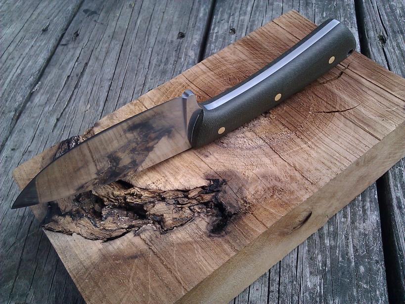

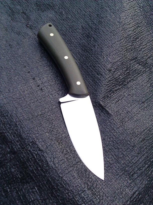

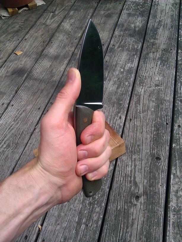

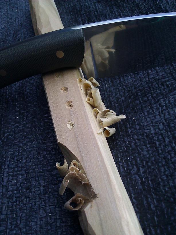

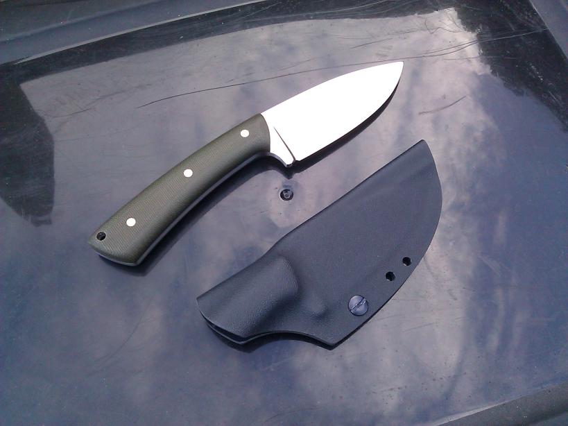

    This is the third full-size Mountain Knife in the series.

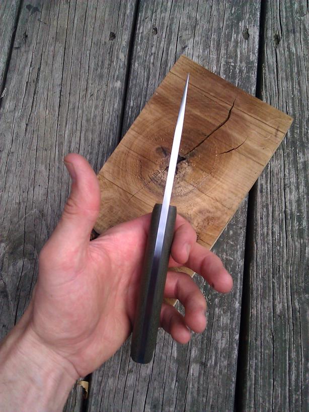

    blade: 3/16" O1, nominal 4" (3.9" actual) length @1000 grit

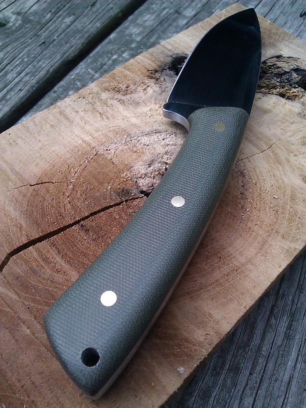

    OD green micarta scales with 3/16" brass pins at 360grit
    Oven foil & oil heat treat, triple tempered

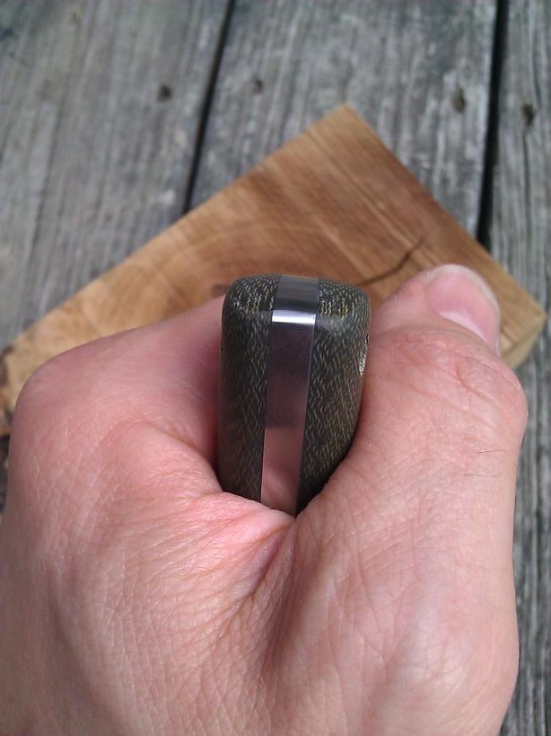

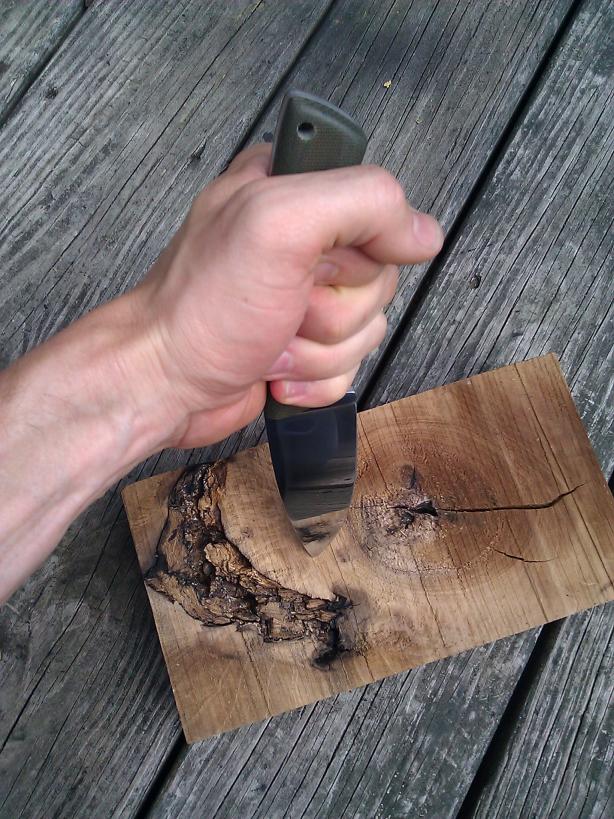

    The pommel is ever so slightly crowned in case a little whacking or chiseling (on/with wood, please) needs to be done.

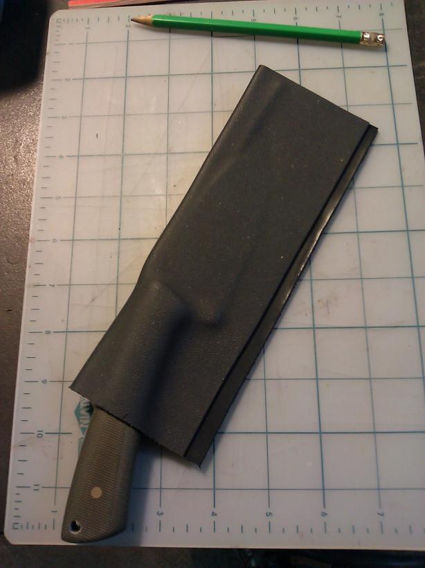

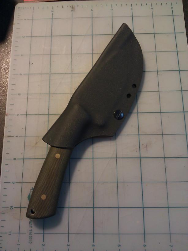

    Sheath is 0.09" kydex with large and small tek-lok compatible holes.
    My grail version of this knife would have a tapered tang, but that looks like such a headache to jig up for scales...
    Thanks for looking.

    Good looking unit!
    Really like the full size handle.
    Well done.

    Nearly exactly my ideal knife!
    Very nice indeed.

    +1!! Came out very clean and looks like the knife is asking to be used. Very nice!!!!!!!

    Really nice. Looks like it can take it and dish it out, perfect size for small and bigger chores.
