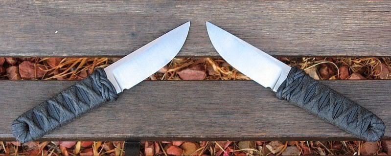

    These 2 are of 1084 and their brother took a beating in the testing and I am now a true believer

    Avigil those two cord wrapped beauties are sick man! Thanks for posting them. Is that a turks or larks head capping off the cord wrap?

    Quote Originally Posted by Erratus Animus View Post
    Thanks EA
    That is a Turks head I made from a cord I got at REI camping. It is "Utility Cord" it is very strong, does not stretch like paracord nor flatten. It makes a nice "Hard" guard on this style.
    I spent hours learning how to do the Turks head.... they can be a little tricky
