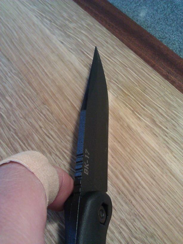

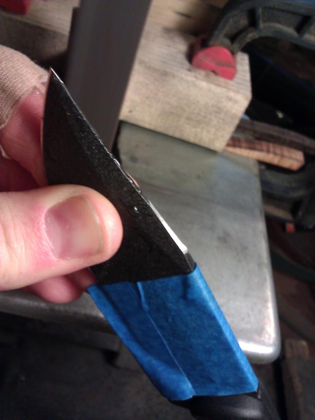

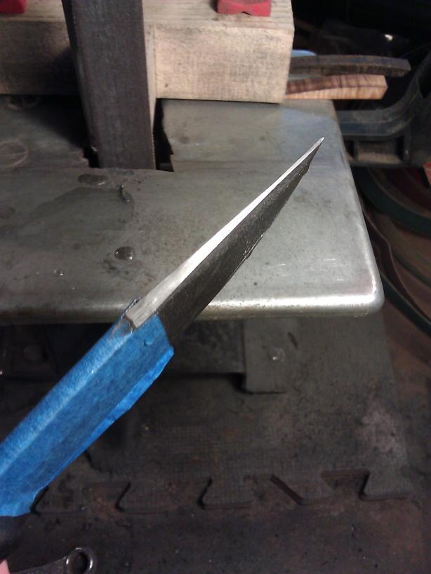

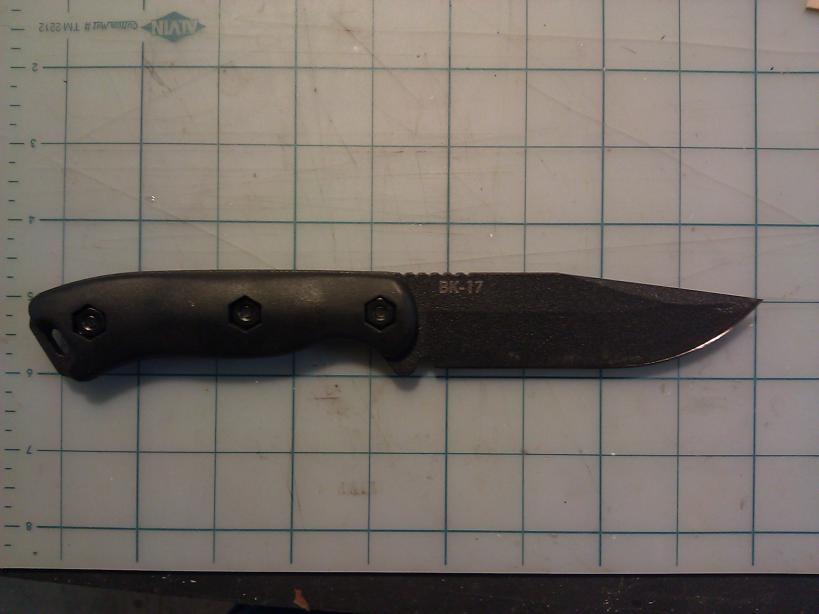

    Did it.
    Do I like the new profile? It is made entirely of awesome.
    on the little 1x42, cold-blued the surface. I broke the sharp edges with some 280g.
    shiny at the tip and back of the clip - these will converge in the middle
    like so:
    and a natural background

    Nice work. When I saw the first photo, I didn't care for it too much, but after seeing the second photo, with the wood background I did.

    it's been 8 days. I ground a knife last night, so I figured a little mod this morning should be no problem!
    Quote Originally Posted by tincansurvival
    Looks great. Seems to have a more definite pointy end. How "stabby" is it?
    it is MORE stabby but a bit stronger. The point is about 0.050" lower, and right where the primary grind and swedge meet. It was a bit high before. One of my usual gripes about concave clips is that the point is too high above the center line. I haven't stuck it in any stumps yet.
