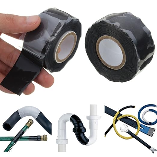

Self-adhesive Silicone Repair Tape Sealing Tape is the way ahead. It's an amazing substance anyway and tolerates a massive temp range. Here's the thing – IT IS NOT STICKY. It doesn't need to be. Because it is for wrapping round things. Provided it touches itself it will fuse. On the roll it is separated from itself by a backing film that you peel off as you wrap. If you didn't have that film you'd be buying a solid puck. The slight elasticity means that when you wrap something it bites down hard on itself and sets there in about 10 seconds. To remove it just cut it off as you would a to remove shrunk-on rubber sleeve. There will be nothing stuck to the knife handle. In fact, if you were minded you could whip a very fine underlay wrap of something for texture and seal it on with this rubber. It'll mend a hot pipe or make a torch more pleasant to hold in an ungloved winter hand [also improves the twatting-stick-ness] of those.
Branded, unbranded, I dunno. I get mine off Amazon for a few quid. Good for stuffs.
Ah yes ..... Tommy Tape (brand name) silicone wrapping tape. One of the handiest items to keep in your car, household repair, and outdoor equipment kits. It withstands a huge temp range, is extremely flexible/conformable to odd shapes, and has high dielectric value (i.e. good for wrapping electrical wire junctions). I have found it optimal to maintain a goodly amount of tension on the tape as you wrap it to insure that it seals down on the previous wraps. Tommy Tape or similar silicone tape is readily available online. I've also seen it at home centers, hardware stores, & Wally World.

Around here that tape is also known as self-vulcanizating tape. It only sticks to itself and requires a certain amont of stretch to cure properly. I have a roll of 3M which works great. I am sure other brands have cheaper alternatives.

I have found since I posted this that there are quite big differences between these self fusing tapes. I had been using the same type for ages [op cit]. That had some stretch but not massive, and whilst that was good for me it exerted no effect on the bonding process. Just laying one bit on another [or irritatingly, touching two bits together when you didn't want to] would do it.
My stock of that type ran out and when I went to get more they had sold out. I settled for a thinner looking one that seemed the same. It isn't. It has way more stretch. I think the label said something like stretch it 300% for best results. The original stuff that I have been using for a long long time wouldn't put up with that much, nowhere near it.
More interestingly, I am accustomed to being able to to up wraps over an original that could have been in place for months, and well handled. It still just fuses into one big lump. That wasn't what I found by mixing these two types. I found that I had added a bit too much top up tweak to a knife handle and that made it overly snug in the sheath. Ho hum, I'd need to cut it all off and start again. Not so. I started cutting only to find that whilst the new layer had fused to itself it had not to the original layer. The original wrap was totally independent. The new layer behaved just like what I would have anticipated an original wrap round a bit of G10 to go like. Splendid. I didn't need to cut it all off at all, just mah over zealous top up bit.

300% stretch sounds like its rubber based not silicone, rubber based tapes wont work for gripping, the oil from your hands actually starts to soften it at least in my experience it is also a lot weaker and cant take anywhere near the abuse silicone can.
PS-Silicone and Rubber will not adhere to each other either.
