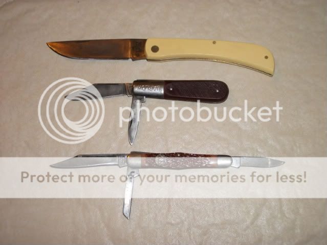

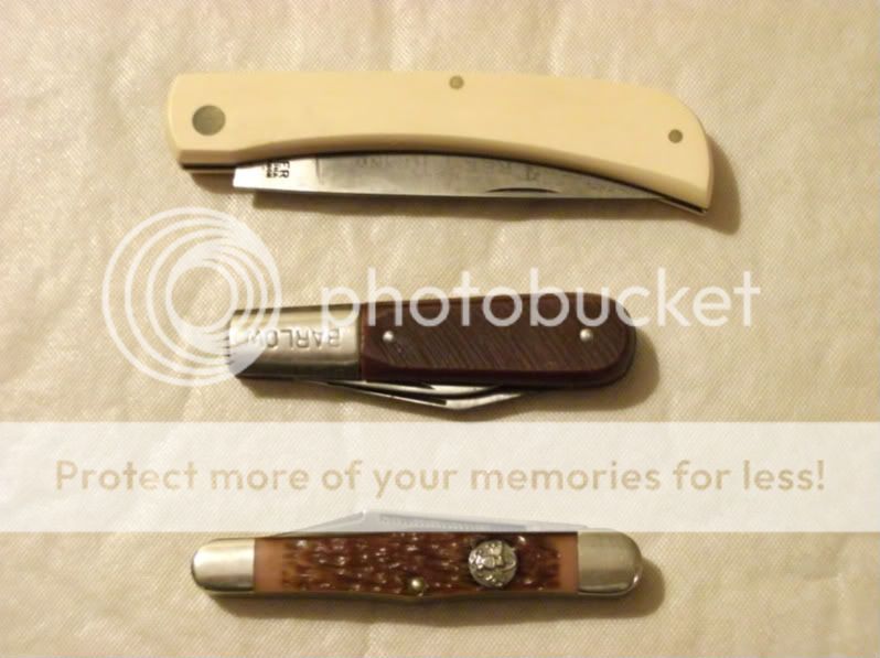

I have to pretty much agree with everything orca said about the handle. Mine has a small gap between the pivot and the scale on one side. It doesn't affect the function of the knife in any way and it has a good snap when opened. It carries well in jeans, but it's a little big for slacks. If you're looking for a large yellow handled soddie with carbon steel it's a good choice. If you want a smaller knife a Case jr will probably have a better fit and finish. Here's a couple more pics for size reference. They're not the best quality, but it gives you an idea of how big the handle actually is.
Shown with an Imperial barlow and a Camillus whittler.
