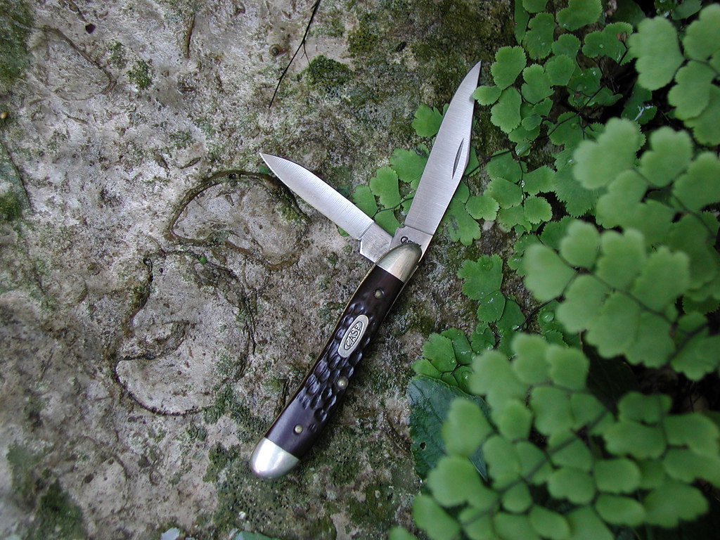

I was just reading the "I blame Stich and Doug" thread and decided to pick up the peanut my sweet heart gave me and take it outside for a bit of whittling. I have not used this knife for anything, other than the usual "opening and closing routine",as I wanted to keep it pristine.
I was going to give Carl's advice a go and put it in my pocket and put it to use.
I admired it a bit, picked up a nice stick of aged walnut, and began to whittle. After a bit of bark and a few feathers, I was satisfied and proceeded to close the blade. Piiiiiig....the spring snapped in half.:eek:
Catastrophic Failure...(internal considering )
It's the stainless model and absolutely new!! I have never had this happen before and since it was a present I want it repaired. How does the process work with case.

WOW, i've never seen a total failure of a backspring on a Case pocketknife. I've pushed some pocket knves pretty hard, but never had this happen. I have no doubt that it was a bad spring, and Case will take care of you. The fact that it broke when it was in the act of closing and flexing, tells me it was way to hard. Improper heat treat.
Carl.
Carl.
+1 The HT was way off. Much too hard.
