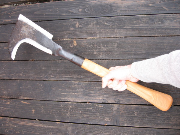

Here's a socketed billhook forged in Italy by Falci Tools.
The straight edge can be used like a cleaver,
or (with a handle attached) like a light-duty axe.
The hooked edge can cut flexible material better than the straight edge.
Both edges have a convex grind.
I carved down and shaped a thrift-store baseball bat to make a handle
(using non-electric tools),
and finished it with raw flax oil (aka raw linseed oil).
Here are some specs:
OAL (head only): 12-3/4"
OAL (with handle): 26-3/4"
Width: 7-1/4"
Straight edge length: 6-3/4"
Weight without handle: 1 lb 13 oz
Weight with handle: 2 lb 8 oz
Thickness at base below hook edge: 4 mm / 5/32"
Thickness at top end: 3 mm / 1/8"
With the handle attached, the balance point is on my finger in the photo:
I secured the head with a screw and look forward to clearing some brush.

Nice billhook, Steve! Excellent job on the handle! Good thinking on thinning down the hitting end and leaving such a nice sweeping swell. I think if you had used the other end, the abrupt swell would have caused some pain. Smart guy.
Clever way you made the handle--I wouldn't have thought of using a thrift store bat!
