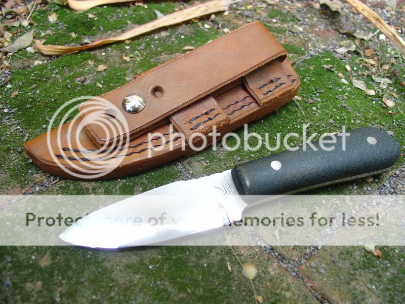

Here's one of my EDC's... The red is awesome:thumbup::D

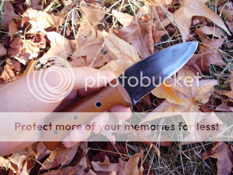

What Mike just posted- the Stead Knife- is my answer to a lot of that.
I need to get more photos of various finished ones. I'm just coming in from doing 18 blades today, kind of scatter brained.
The convex EDC (model 57, now) - is a simple handle without a specific integral guard, but the dropped edge of the blade offers some security. Notching the rear of the edge or leaving a small 1/8 inch segment unsharpened really helps with that aspect. The handles are....most of my handles are straight, but not. There's a slight curve, mostly on the bottom, on most. Simple, but it adds a lot.
The Stead knife like Echo-7 posted, has everything I can put into a simple knife I expect to do farm/ranch chores with, including some meat processing and chicken gutting and such.
The guard section is integral to the handle and not really in the way, but very secure.
The butt end has a bit of a drop to it and helps keep your rear fingers hooked in tight.
The only real different thing about it from the blade profile in your photo is that I keep a straight spine on it, like the front third of a leuku. It's handy for scraping, and the point is strong, but you still get a lot of belly out of it.
the LBK knife is really close to what you are asking, except I broaden the blade significantly to get a thumb ramp in.
On a knife in the 6.5-7 inch range overall (I might try and push you a quarter incho on blade and handle) - the stead knife seems to work best overall. getting a drop point profile that short means a very narrow blade.

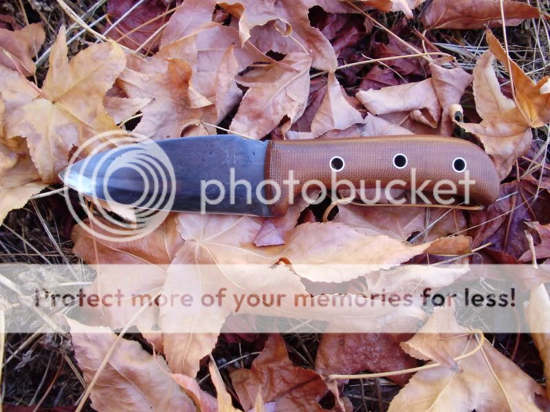

Thanks for the replies. I actually had a couple different knives I'm deciding between. A drop point like in my drawing and one like echo-7 where the blade comes up to the spine. How wide across is that blade at it's thickest?

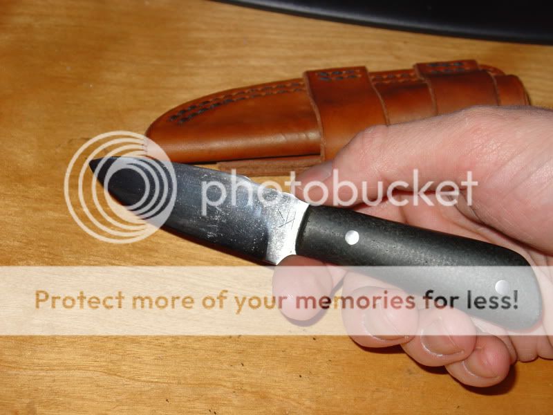

I'll throw in another vote for a stead knife like echo7 posted. I've got mine close all the time.
The blade on this one is just under 3.5" and the handle is around 4.5" the blade is about 1.25" wide.
