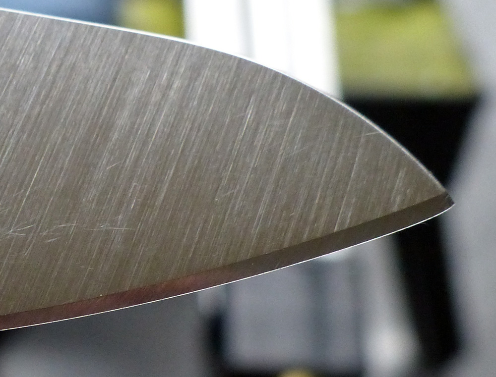

You have already had great advice here. I would add a few minor things regarding burr detection.
There are basically two ways to detect a burr, visually or tactilely.
For visual inspection, you can see a burr with right illumination like below (the white line on the edge is a burr running across the full length of the edge). This doesn't work for a small burr after a fine stone, though. Alternatively, you can use a microscope, which might allow you to detect subtle burrs. I have not used this method extensively myself.
For tactile inspection, you can use either your finger nail or the belly of a fingertip. I am not good at using my nails for this and use fingertip belly. If you rub your fingertip belly with the edge bevel with a edge trailing motion (not leading!) like stropping, a burr would scratch the fingerprint ridges, which you can easily feel. This feeling should go to the other side as you flip the blade. This is how you know that what you felt was a burr (this applies to the visual method as well). I can feel really minuscule burrs with this method.
Hope this helps and a good luck to your sharpening!
