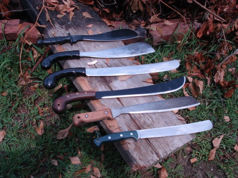

The lines often get a little blurred between the two. Most of the goloks I've seen are typically thicker and shorter, although that isn't always the case. I've also seen more goloks with sheep's foot or almost straight up-curve...basically not much of a point. Parangs I've seen are more often thinner and longer, but again, not always the case and I've often seen more with a distinct point and they are often longer in blade length.
These are all called goloks and you can see a lot of variations:
I don't have any pictures of parangs, but Condor's and even Valiant's both show a heavier blade (1/4") with a significant weight-forward balance and pretty long. I've seen some more along the lines of a machete for lighter vegetation.
The thicker and more weight-forward designs would be better choppers for hard woods...of course they can be a little taxing on using like a regular machete. I think the designs of the golok would make it a more robust blade to baton if needed.
I would make the assumption that names are just that and actual designs and use are regionally more definitive.
