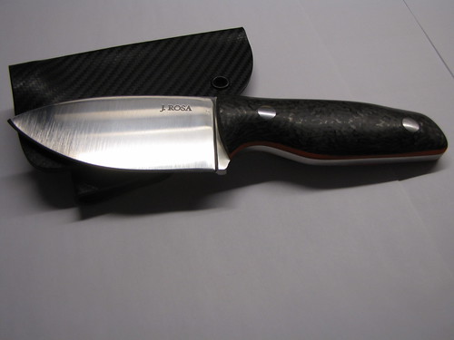

First impression when I received this knife was that it was solid. Its hefty for its size. Second thing is the handle is very comfortably shaped. Everyone who has handled it has commented on how good it feels in the hand.
The kydex sheath Jim Rosa supplied is done in the Carbon Fibre surface textured material and looks really sharp with the carbon scales. It also has a house made loop/clip that allows the sheath to be slipped onto a belt without undoing the belt and the loop holds securely once its in place.
IMG_0884 by rapt_up, on Flickr

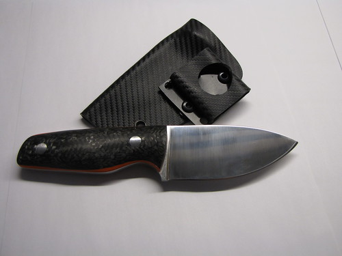

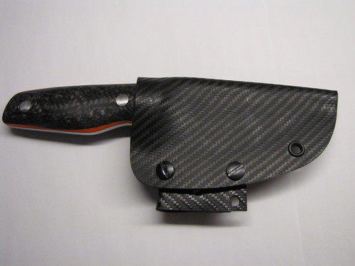

The knife came with a sheet explaining that this is a value priced knife and as such has a lower level of fit and finish to match a working knife and a budget price point. This by no means says it is poorly finished, in fact Its about ideal from my point of view in terms of balance. I have no problem paying for performance, but I dont see the need to pay for high levels of finish I either have to baby or sacrifice when I start using the knife. Since Im a knife user this suits me perfectly and I wish more makers offered this as an option with knives. Certainly a plus in my book and something I appreciate.
IMG_0885 by rapt_up, on Flickr
IMG_0887 by rapt_up, on Flickr
