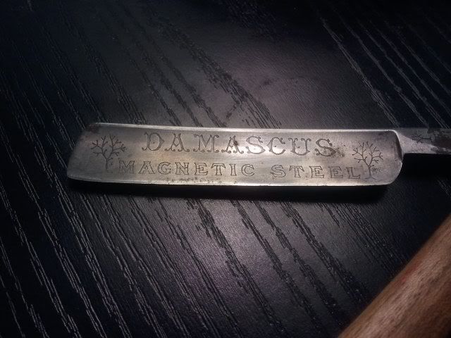

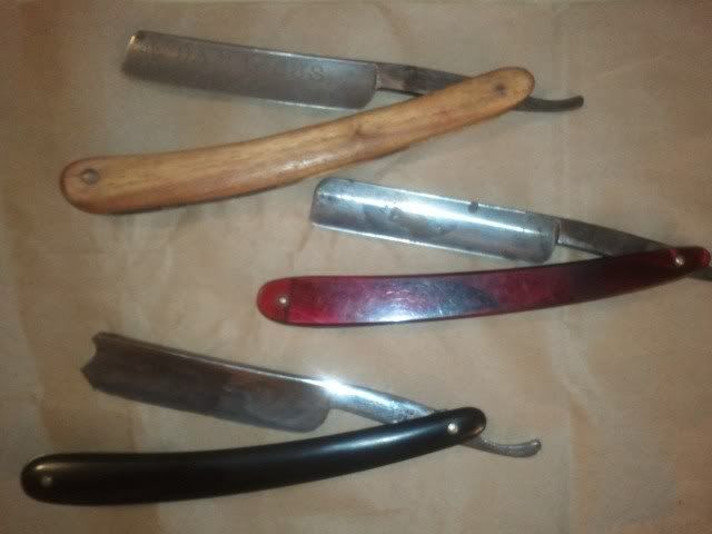

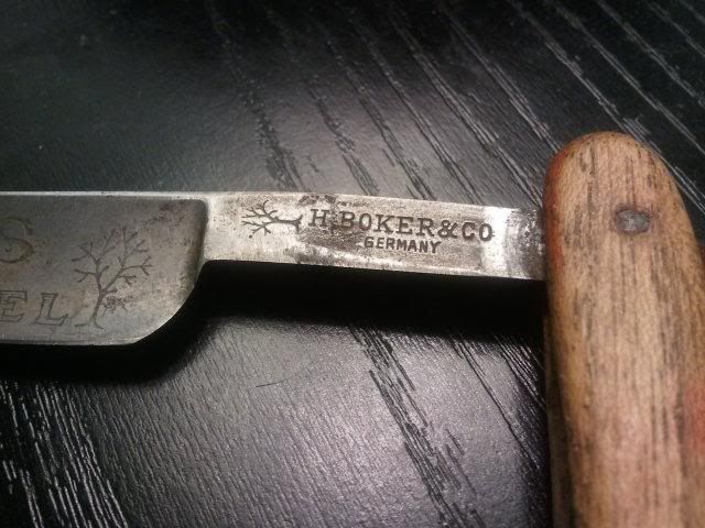

Well I just picked up a few straight razors from a local antique dealer who also is a knife nut. I asked him if he had any that were in need of work because I wanted to try restoring and rescaling. He brought out a couple boxes with maybe 30 razors and let me pick through. I found a plastic handled Case with a chipped blade, a Dixon (Dixie maybe, I can't remember for sure) with warped scales and a H. Boker with home made scales done poorly. The Boker is the one I am interested in first. It is a 5/8 and marked "damascus" over "magnetic steel" with the boker trees on either side, all etched on the blade. Tang stamp is a sideways tree with "H. Boker" over "Germany." I haven't been able to date this one or figure out why it is marked damascus. It looks like a single steel. Was that a tradename of a certain brand of steel?
Because this is worthless without pics, here you go...
The Boker is the top one in the group pic.
Here is the blade etching and tang stamp

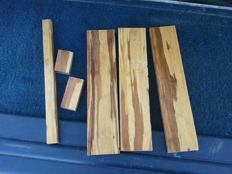

Just for fun, here is what I plan on using for the new scales, bamboo flooring scraps 3/4" thick. Enough to cut it book matched.
If you have any info about this razor that would be cool. Also I have checked out SRP.com and didn't find any info about this specific razor.

I've seen a lot of straights marked "Damascus" that are not Damascus steel as I understand it.
Why do they do this? I have no clue...
But, curiously enough, most razors marked "Magnetic Steel" are actually magnetized.

Strange, I haven't checked it to see if it is actually magnetized or not. I don't understand why they would be, to keep stones/strops from loading with steel particles maybe?

Damascus in this case means layered. The layers are likely all the same steel, but it is a layered process.

Nice score! You should have fun refurbishing these. I suspect the damascus thing was often a marketing gimmick. Because damascus blades tend to have a legendary reputation of being the sharpest of the sharp. It's always nice to associate yourself with the best, even if you are not yourself.
I wonder if the Magnetic Steel on the Boker is a brag about being a true carbon steel blade. Or a reference to magnetic conditioning of the edge that was a popular idea back in the day. A quick google reveals a number of patents for such devices. I have seen a couple devices advertised just a few months ago. I have no idea if such things work or not.

I thought I would include this over here. I got this response from Stacy over in the shoptalk sub-forum, I asked about the "damascus" etching on this blade.
DAMASCUS blades were mythical for several hundred years. Practically no one had one...no one had seen one....no one knew what they were or were not. All most people knew was that they would cut anvils in half, and then precede to slicing a falling silk scarf into confetti ....all with one gentle sweep. How did they know this????? - The people who used the term DAMASCUS on their advertising said so....thus it must be true.....they wouldn't lie, would they?
Since no one had a patent ,or even any real idea about damascus, the term was applied to many things as a selling hype. Sometimes it referred to a manufactured surface pattern (wire damascus shotgun barrels),sometimes to an engraved, machined, or etched pattern ( damascus/damascene on watch movements, fake "damascus" shotgun barrels, and metal work) ...., and sometimes to nothing at all ( damascus razors). Plain ordinary swords and knives....and razors..... had the term applied. The steel industry in Sheffield and Solingen well knew that the public would line up to buy a product named after such a legendary material. And there was no Internet to expose the hype, or government agencies to make them prove the claims.
IIRC, durring the late 1800's and early 1900's, Wilkinson marked a lot of swords and things DAMASCUS as well as implied it by using the "Star of Damascus" (a six pointed star which had no real meaning) on the blades. Most military swords still bear this star for no reason than hype - to imply that the steel is of superior quality.
