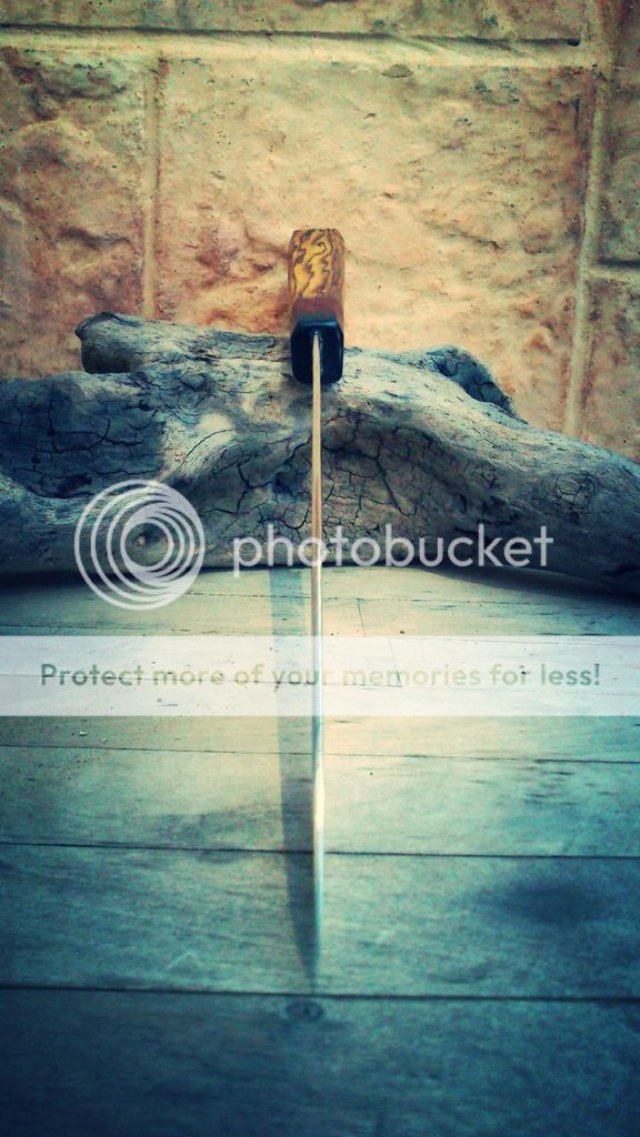

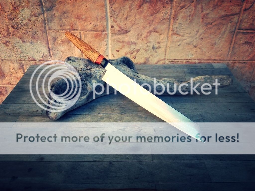

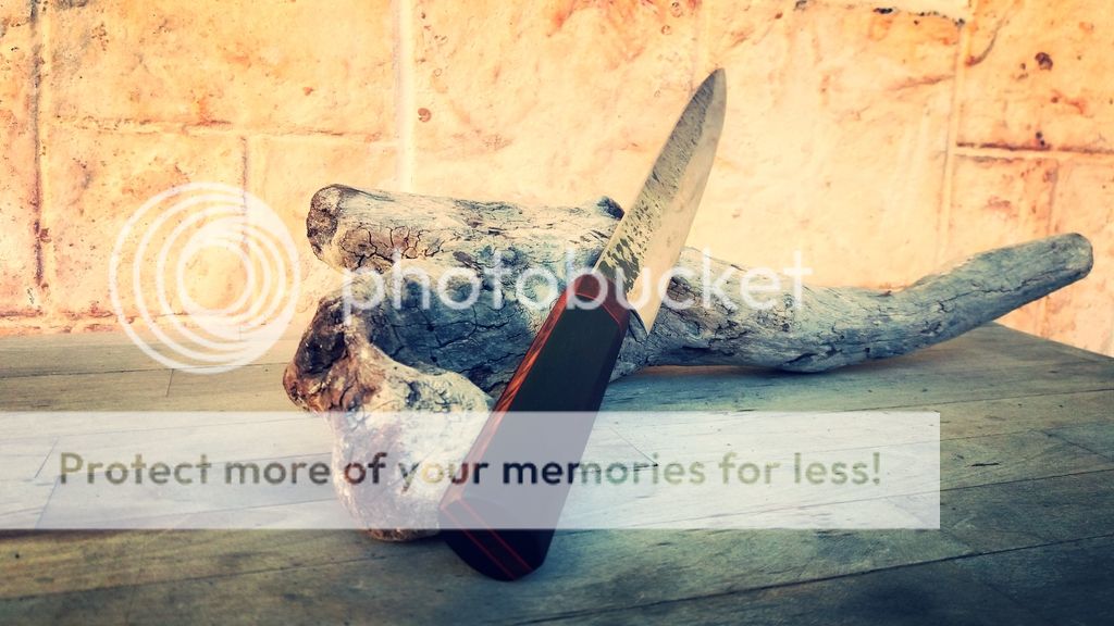

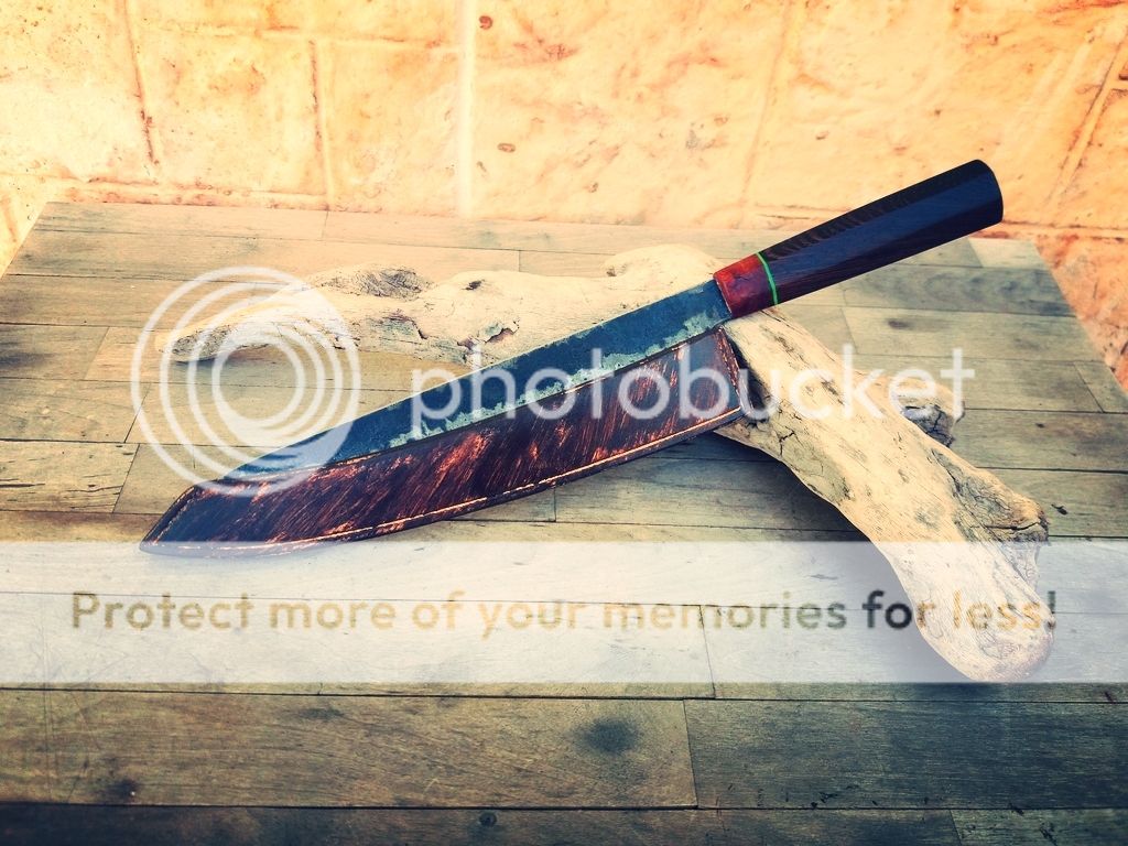

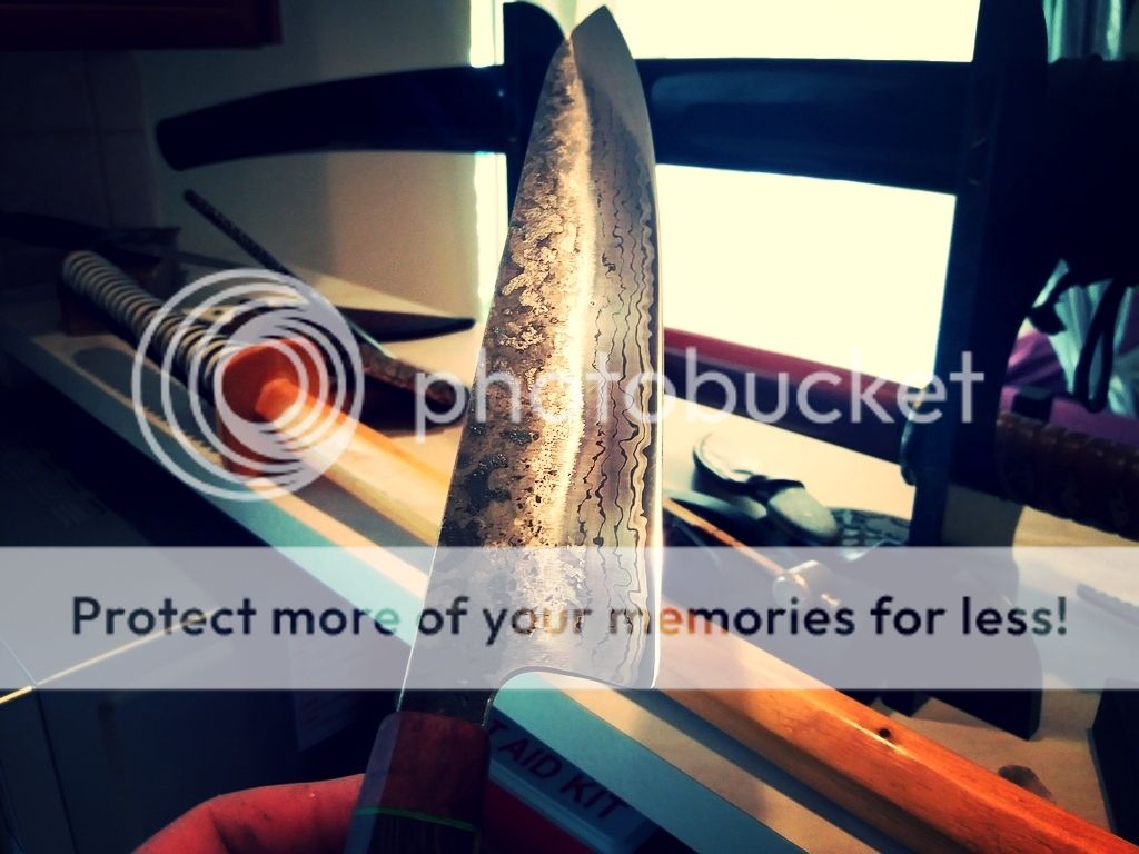

I made this knives from a suminagashi bar stock with a core of "white paper" steel by Takefu.
The first one is a yanagiba 27cm blade length & 3 mm. thickness.
The handle material is ebony,bocote & briar wood.
The second one is a Gyuto knife 22cm.blade length & 2.8mm thickness.
Handle material is bocote ,briar wood & buffalo horn.
The third is a kiritsuke style knife at 24cm blade length & 2.8mm thickness.
Handle material is olive,eucalyptus wood & buffalo horn.
and the last one is a Gyuto at 22cm blade length & 2.9mm thickness.
Handle material is wenge,Iroko & briar wood.
Thanks a lot...

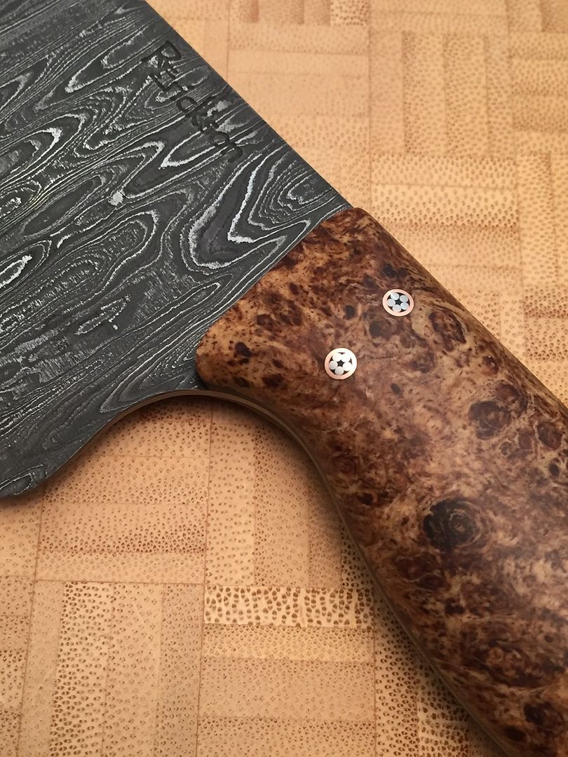

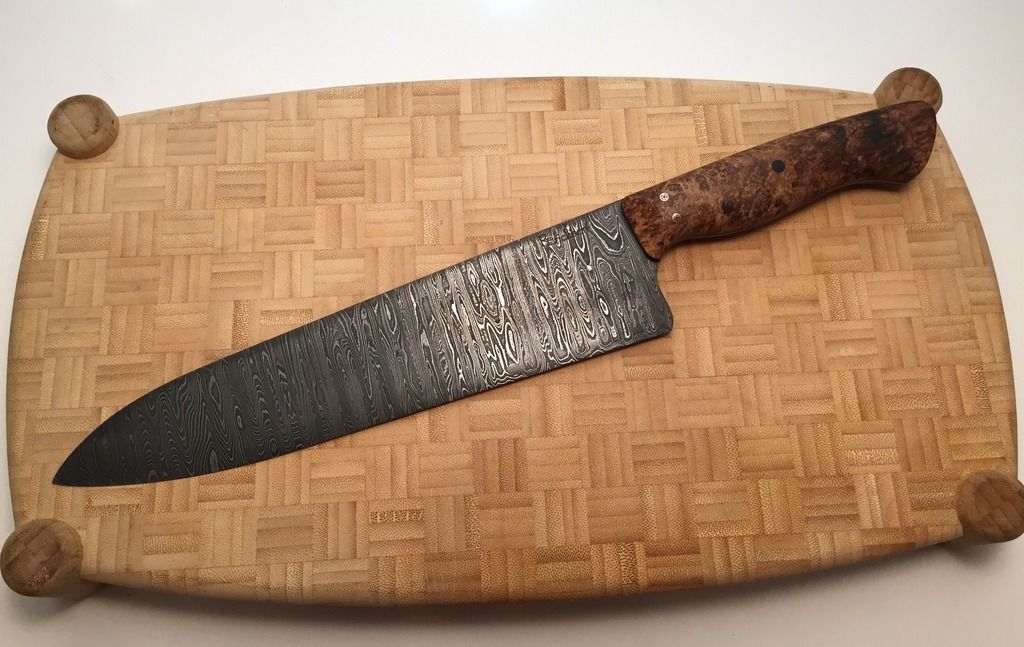

Here's the last chef I finished. 13" OAL, 0.078" Alabama Damascus that has a compound grind (the bottom 1/3 is convex) Spalted Maple Burl handle
