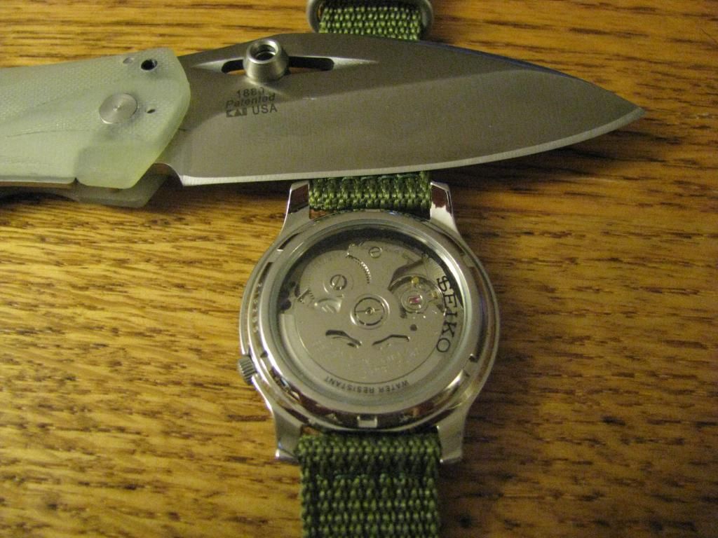

I am interested in this and whetrock might be interested also, can you (or better a watch maker) adjust it if it loses or gains time? I noticed what looks to be two little levers and a "+" and "-" inside mine. The pivot of the two levers is capped by one of the jewels (a pink one on mine). I do not know a lot about watches, I just know I hate dead batteries in watches so I buy automatics now and deal with the precision being not quite as good, but if adjustable, that would be great.
The pink jewel, the levers have gold tips and you may be able to make out the "+" and "-"
Yes, it can be adjusted (regulated) but there are a few things to consider:
- you need to find a good watchmaker first, not somebody in a mall watch store
- to be properly done, the watch must be put on a special machine that listens to the beat in all the different orientations of the watch; the watchmaker must then adjust it for a compromise of all the positions
- most likely, if it's a water resistant watch, and you want it to remain water resistant, the watchmaker will have to pressure test it and then replace any seals if it fails the pressure test
- once you get it back, your wearing habits (sitting still at a desk with your watch hand mostly in the same position every day, etc) may affect the watch's accuracy and you won't get the same accuracy to what the watchmaker has gotten
- doing this to a Seiko 5 will probably cost more than the actual watch
- the movements in a Seiko 5, or other inexpensive watches are rugged little soldiers, that keep on going and going; but they won't necessarily hold a regulation for very long; it's possible that the accuracy of a freshly regulated watch will degrade the day after you get it back
- as everybody will tell you on TimeZone.com, if you want an accurate watch, buy quartz
Good luck,
Lenny
Thanks, I will bump it up when it needs it. No quartz for me, and no expensive tear down either, I have had some bad experiences with "experts" taking my watches apart to replace batteries and so forth. My wife got me a Citizen (quartz) and the battery died. She had the case back engraved and the jeweler pinged it back on with a very fine point instrument. It looks like a little hailstorm hit my watch and it never worked again. It is a shame because I have never seen a classier simple watch.

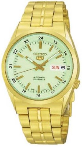

They have something for everyone. Want a gold watch with a 24-hour DayGlo dial? Got you covered, dude.
