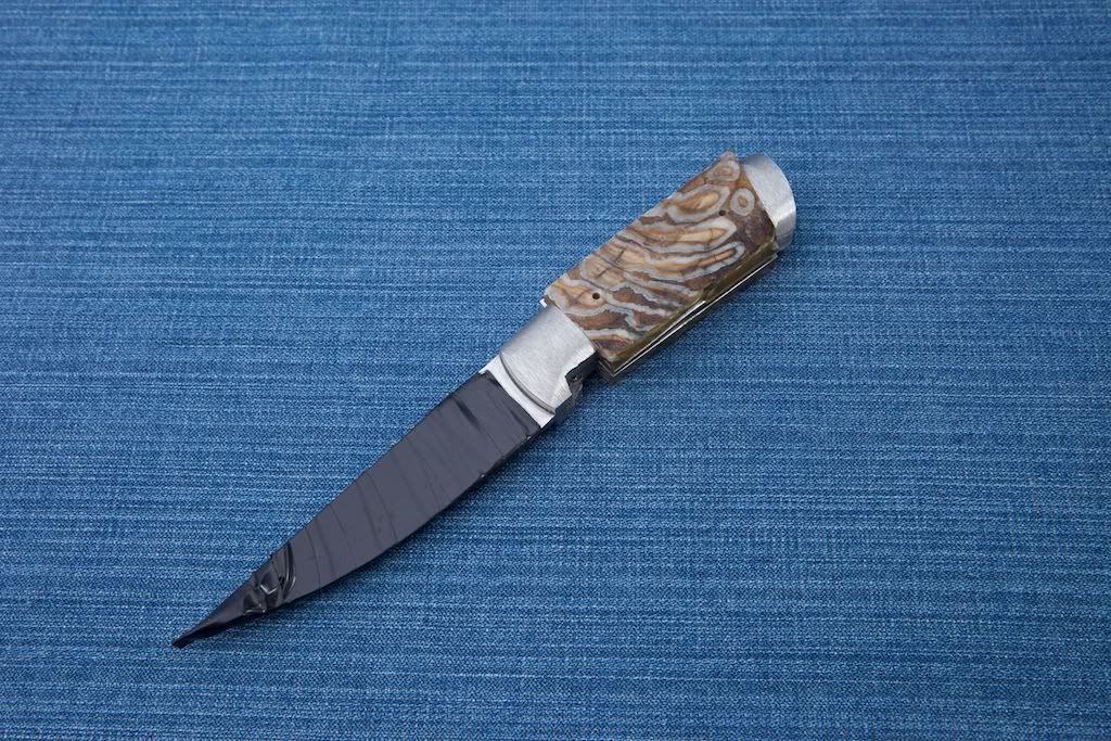

Dang I forgot to update this so here is a pic, I backed this tooth up with a stainless steel liner. With all the suggestions I got here I think this one went pretty well just had a couple little break outs that had to be dealt with. This one is finished when the wife gets done photographing it I will post the finished knife.
In this pic the blade is hand sanded to 1200 grit, bolsters are roughed in and scales are fitted to the bolsters and pin holes drilled. I went so fast I did not get any other in progress pics.
