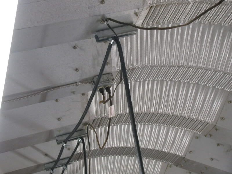

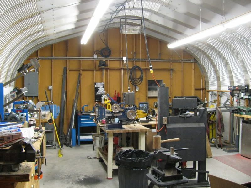

I ran two cords to hang down from the ceiling. One was 110V to supply electricity my workbenches, the other was 220V for the press. The 110V cable cost about 35.00 dollars plus another 10 for fittings. I can not find the receipt for the 220 line and bought it with other stuff at a different time but think it was less than 100 dollars for the cord and fittings.
The cords were run from a junction box in my application, should run from dryer outlet in yours.
Hung by uni-strut to keep them from becoming a tripping hazard and to keep it out of the way.
Here you can see the cords location to the shop. They are out of the way, and I have plenty of extra cord to move the equipment later on if I want to. Also since I am only renting this place it is only a matter of a few minutes work to disconnect everything and take it with me.
Wow nice setups! Is that a TW90?
