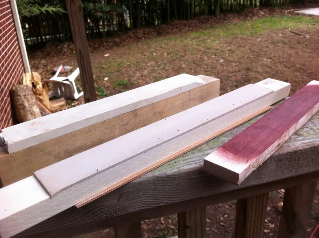

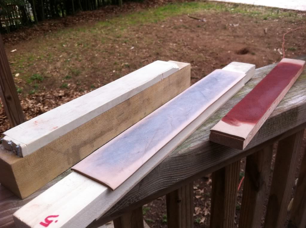

i sharpen all my large blades by hand. Its a little more difficult but not too bad. I just did my NMFBM and it did just fine. I use a piece of balsa wood and I adhere a piece of linoleum to it with glue. (found at art stores and used for carving out the negative part of a stamp) The linoleum has enough give for a good convex edge but is not near as soft as a mousepad. I find it to work much better. I use sandpapers in grits 320 to 400 - 600 - 800 - 1000 - 1500 - 2000. I then use I then use honing pastes that are 6 microns in size then one thats 3 microns in size. After those I use diamond sprays in 1 micron, .5 micron, and .25 micron sizes. For the pastes and diamond sprays I have cowhide glued to a piece of balsa on one side and on the other side I have craft foam for a really soft "mousepad" feel. You can easily stop at 1 micron diamond for a mirror edge, but I'm a little anal about sharpening. Also, and easier solution is after the sandpapers you can just strop on a belt loaded with a hone spray/paste of your liking. Goodwill has real leather belts for cheap. Hope that helps!
(linoleum, foam, balsa)
(linoleum, leather, foam)
