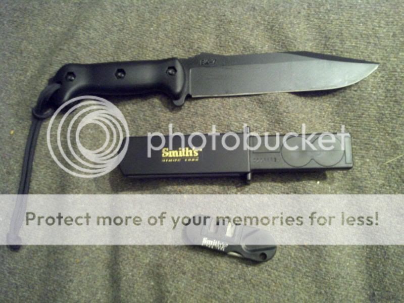

    I use these two thingies made by Smith's. Very inexpensive. The little thing has a carbide "V" and a finishing ceramic "V". I use that if I've nicked or otherwise done bad to my edge. Or if it's a super-dull knife. But there's no way this provides a great edge on it's own. It also has a diamond-impregnated fold-out rod for serrated edges.

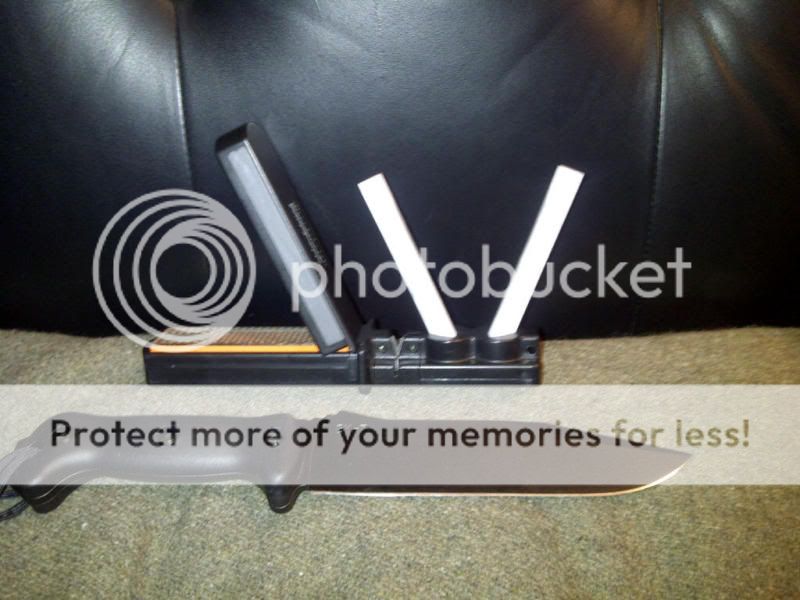

    The bigger thing also has a ceramic "V", as well as two white ceramic rods that fit into the body of the device such that you're provided with a 20 degree angle. The rods have surfaces for straight as well as serrated edges. It also has an interrupted diamond-impregnated surface as shown in the second picture. There's even an un-interrupted portion for sharpening hooks or fine sharpening work. This all fits into the body as shown in the first pic for portability.
    Both are very portable. And can be had for under $30 total at most sporting goods stores. Sure you can get better stuff and spend more, but I've made this work on all my knives to my satisfaction. And it was immediately available. I needed immediate sharpening that day.
    That said, my next step up will be per cjr7. A work sharp sharpener and a strop. All in time.
    Sorry for the poor photo quality.

    @ JES600 that smiths 3 in 1 setup looks pretty good, and small enough to throw in my camping pack, and the natural 20 degree angle of the rods is perfect for the bk7 if i'm not mistaken. Just did a quick search and found both of those items for sale at bestbuy of all places, can pick up both for under $40, for the price I may just give it a shot before I spend big money on a fancy system.
