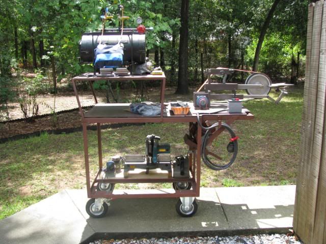

I know you were talking coal forge but my entire shop is on wheels due to space constraint and a bad back! Here are a few examples!
This cart has my forge, my grinder, as well as a host of other items that sit on it!
The cart allows for me to move around the heavy items. Plus it allows me to get my forge outside when in use thus not having a venting problem with fumes. The grinder when I get out in the light outside helps with my ageing eyes!

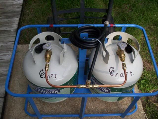

My propane tanks do not reside in the garage when not in use, due to a fire hazard. They are stored in a shed and moved around on this!
This is a container I welded up so I can roll up too it with a dolly, bungie it too the dolly and roll it anywhere. It allows for leaving two small tanks manifolded together to prevent freeze-up and yet it protects the tanks. One hose is all I need to do a hook-up to the forge and it stays with the tanks!
