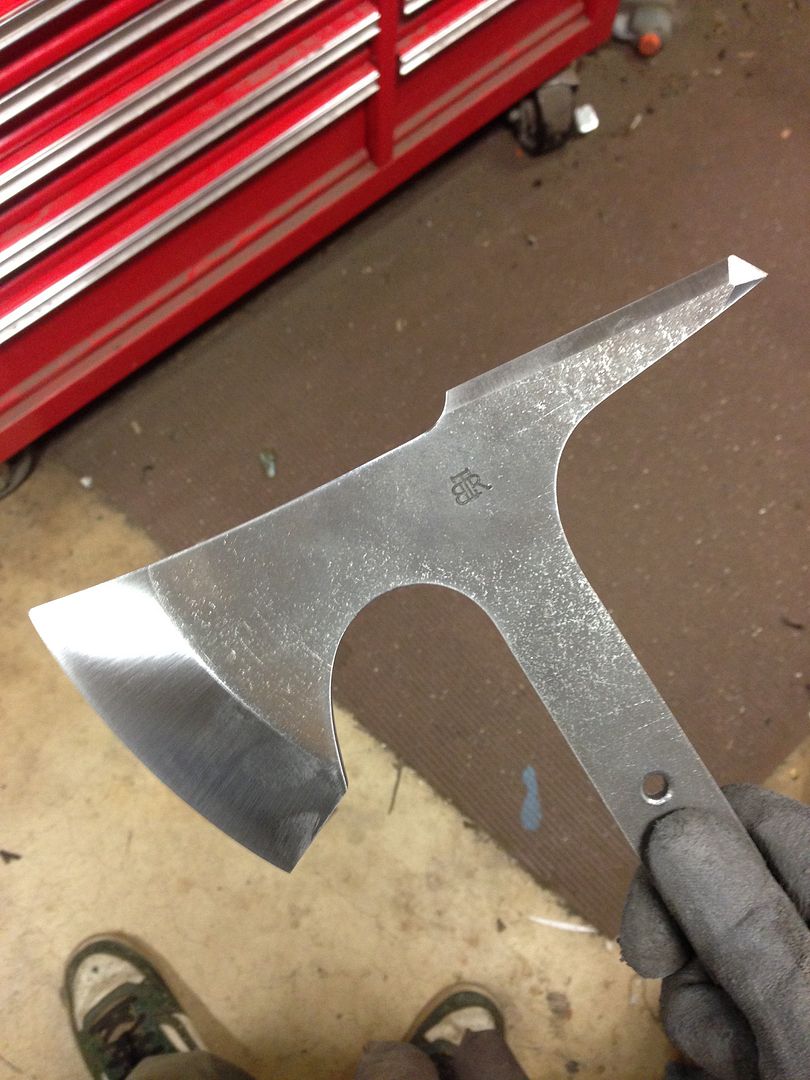

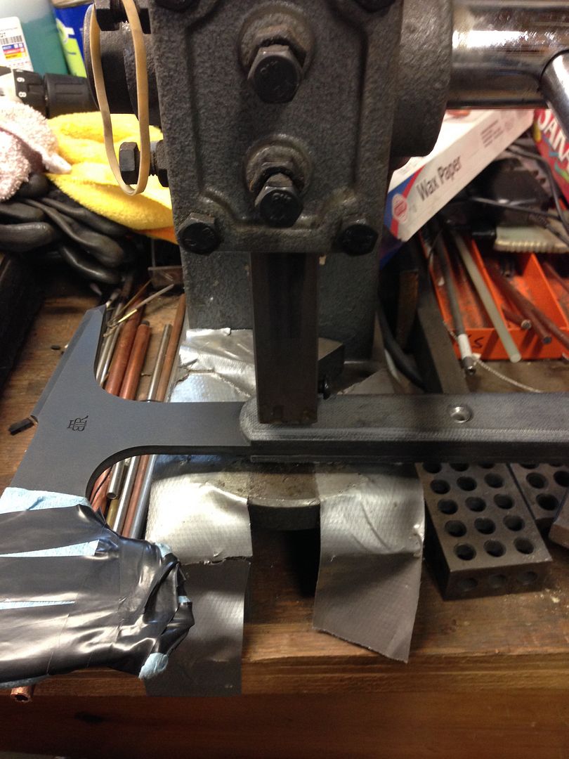

I made a simple little template to mark where I will hard stamp the blades. I use a 12 ton press that I built for the job.
And the results

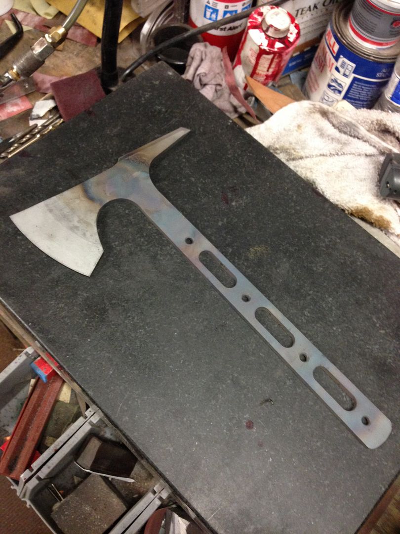

The axes had quite a warp to them for some reason, so I straightened them out prior to grinding. Here is one on my granite surface plate, nice and flat now.

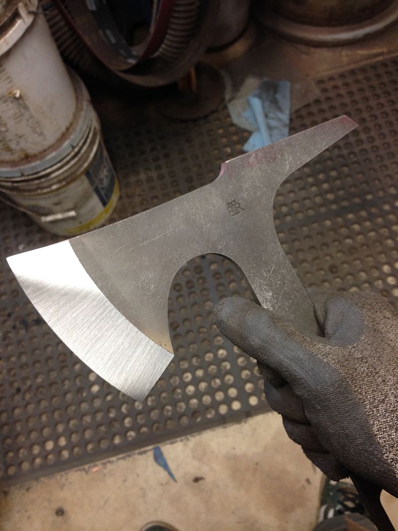

Here I have ground the first bevel.

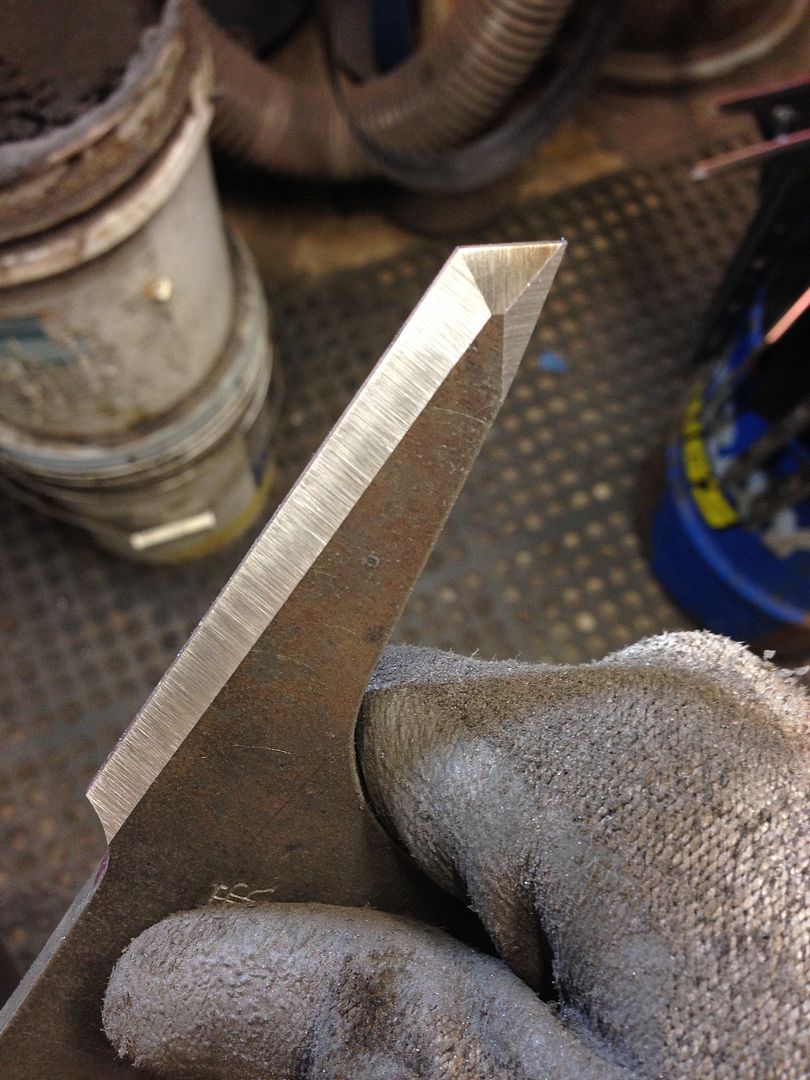

The compound grind on the spike. I wanted a beefy point that would still penetrate very well.
All ground and ready for HT.

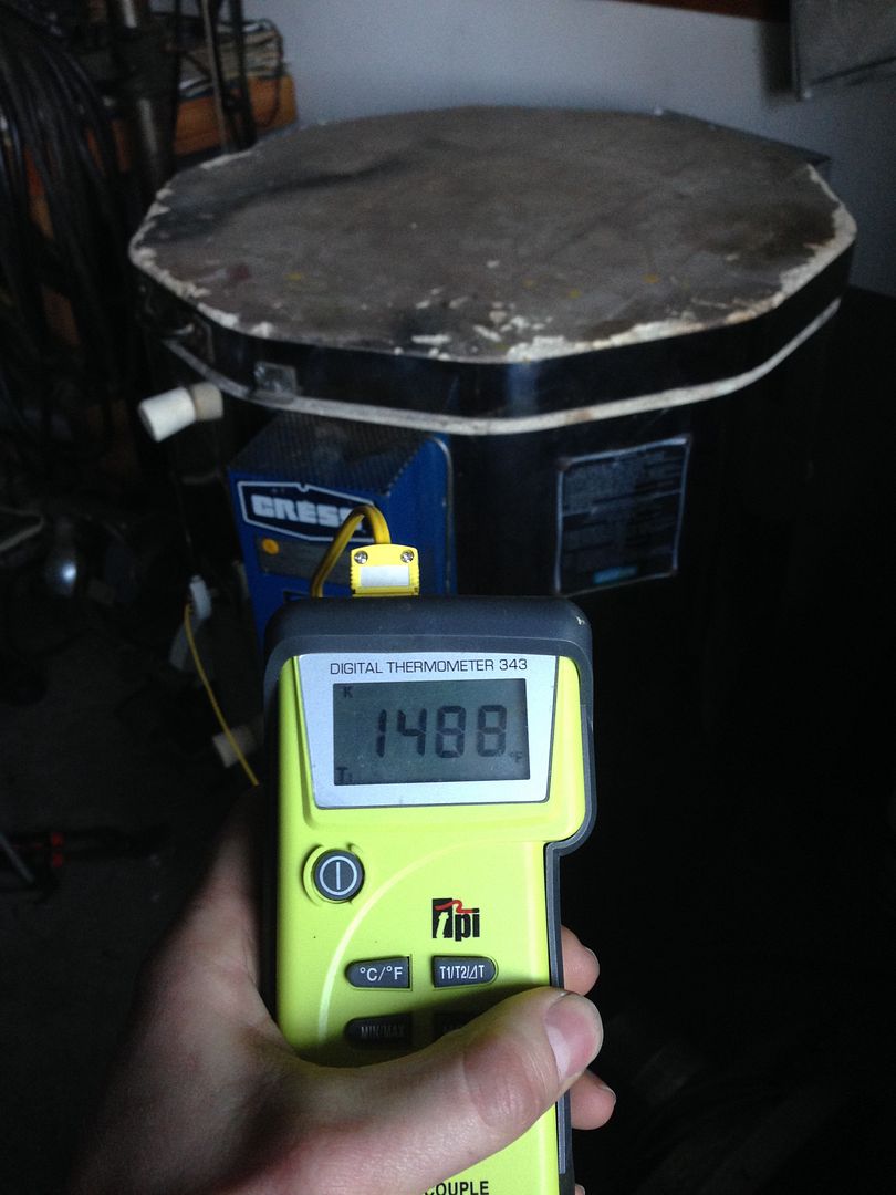

I have a large vertical kiln over at my Dad's place I use for my bigger hawks. Here it is coming up to temp, it takes about 2 hrs to reach 1550.
Opening a vertical kiln is WAY hotter than a horizontal, I need to upgrade my gloves.

After hardening, they get a full temper. I then blast them and then spring temper the tang for extra toughness. This extra step ensures the tough body and tang as well harder edges and spike. The axes can warp a bit during quench, so I straighten them at the same time. This one is nice and flat again.

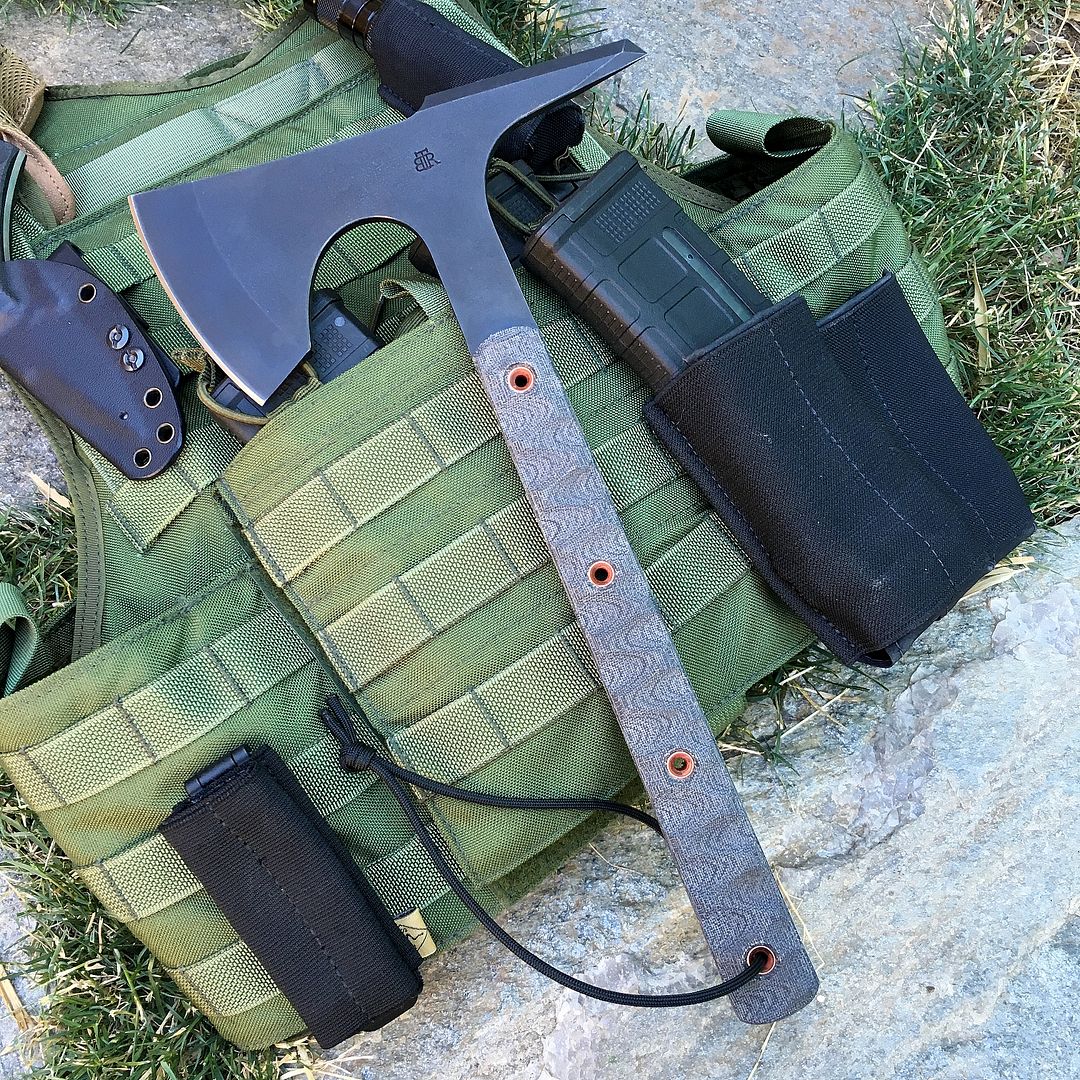

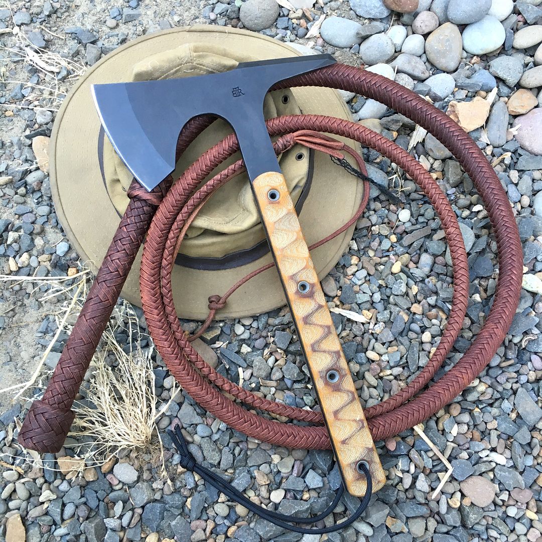

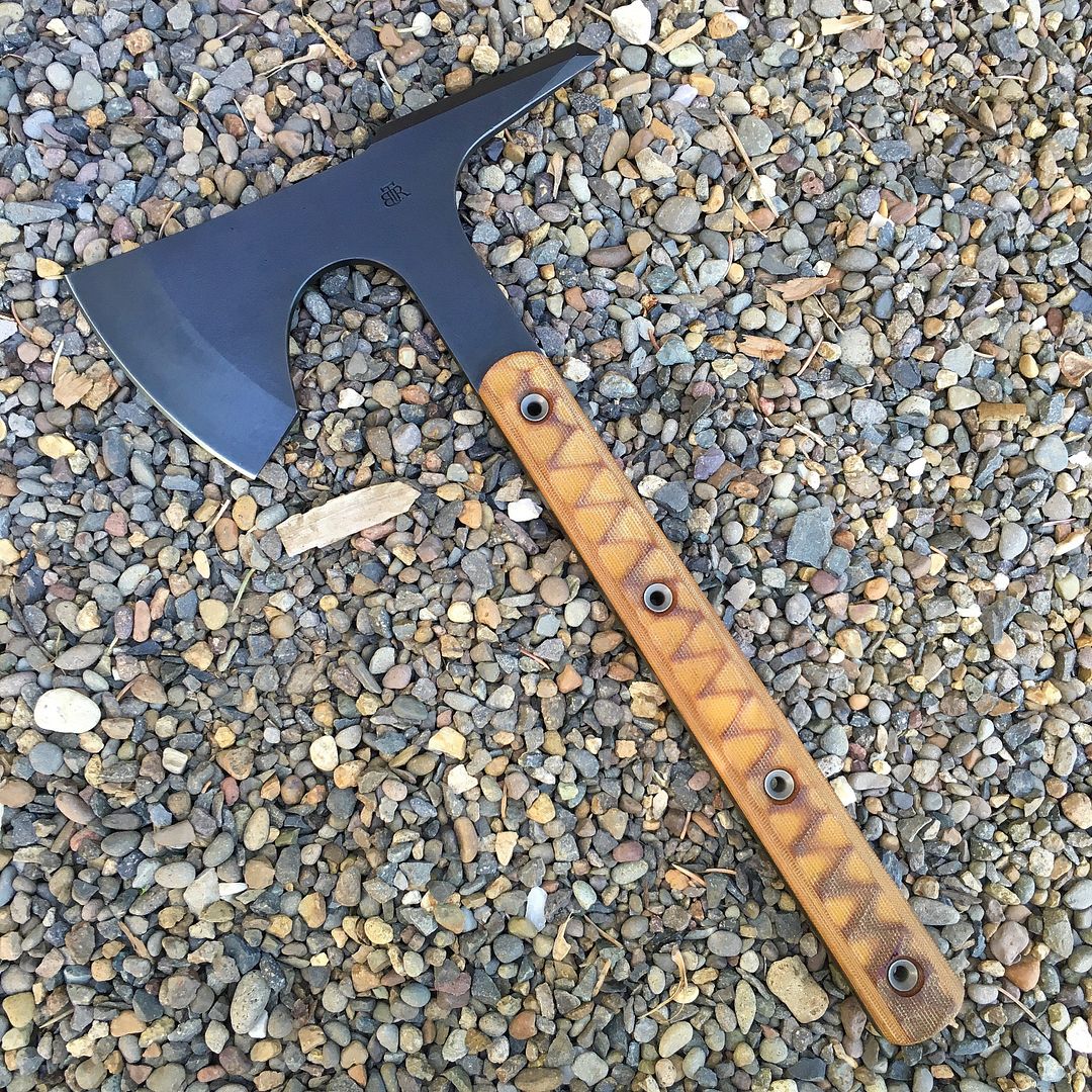

Finally got Photobucket to cooperate. Here is the most recent batch. Just posted these in the exchange. :D
Great WIP. I love the long scales as well as the flared tubes. May I ask if the additional holes offer an advantage or are they just meant to be aesthetically pleasing?
Thanks. Are you referring to the 4 handle tubes? Or the lightening holes under the scales?
