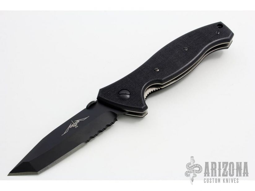

I thought I remembered seeing this occasionally on early Emersons, so I did some looking. It's not uncommon. This is also a '98 model.

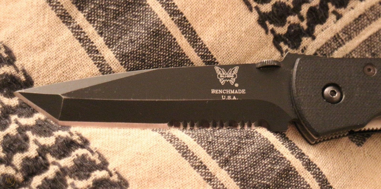

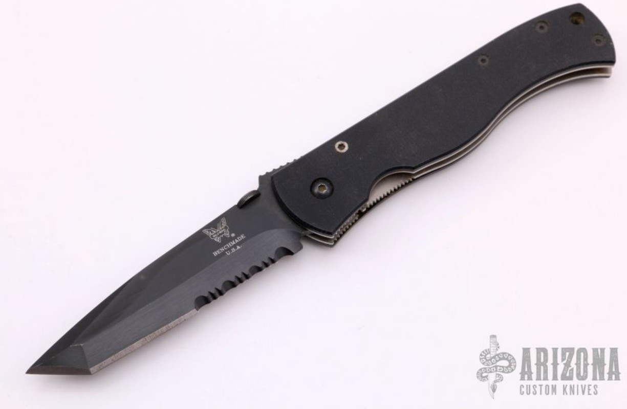

Emerson may have been replicating a technique/procedure he learned from Benchmade. It seems to have been prevalent on the 975S.

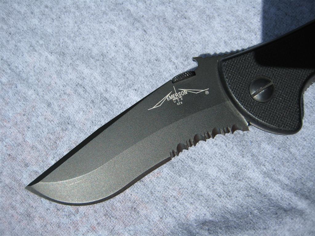

I even found a '99 Commander that appears to have coating on the entire edge.
It may look strange, but I can't see that a coated edge would hurt performance, particularly on serrations.
