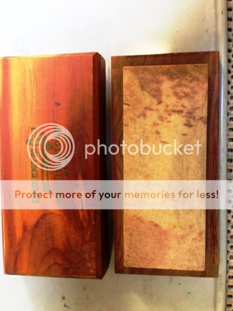

Sorry it has taken me so long to snag a photo...here is my stone.
Yes, that is the Buck model 134, a 2X5" Washita stone. Buck brought that out in the mid 70's. I have one, it will cut steels like 420 or 425M and is slow yet forgiving. I think it's grit is more like 450-500. I finish my stone on a concrete sidewalk and leave it more coarse and I use mineral oil on it to sharpen. You can put diamond slurry on the stone to improve it cutting abilities. Yours looks to be in good shape. DM
