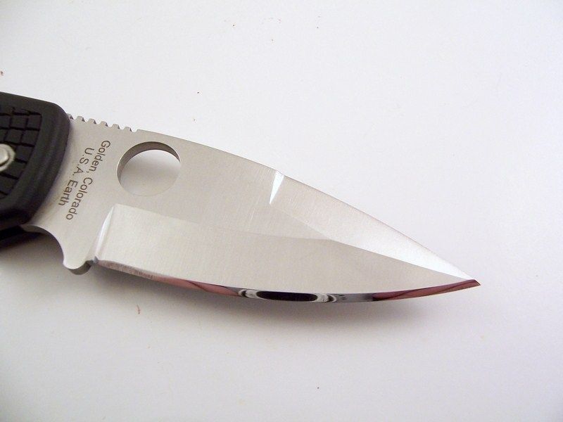

Hard to get an edge like this with that though. Yeh, I know...you don't need or want an edge like this. :p
Not my pic, but you get what I mean. ;)
