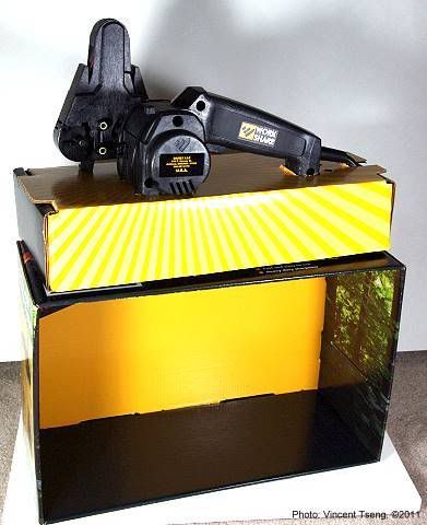

Presentation quality packaging -
I've remove the insert and put it on top of the container box -
just a little tricky until one realizes the tabs protruding on the sides of the insert go into the slots inside the sides of the box.....

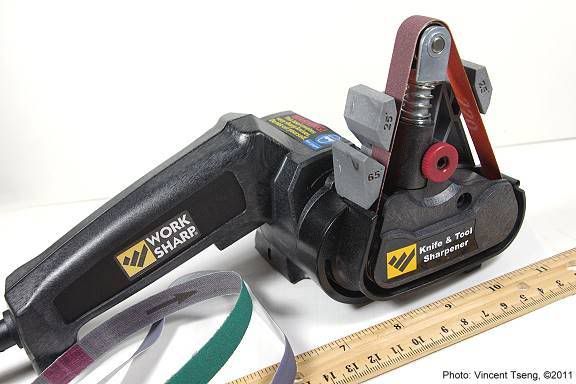

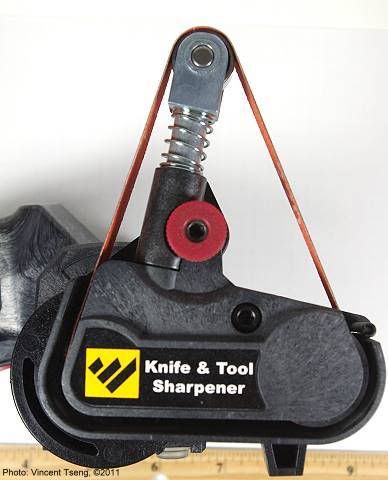

The Work Sharp sharpener

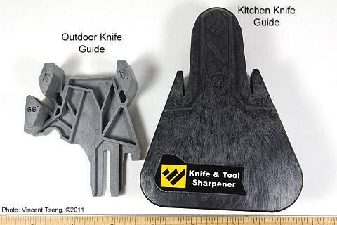

the outdoor knife guide is installed

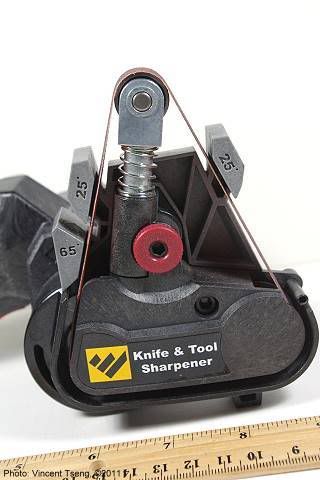

Mini belt system with guide removed -
when experienced/skilled enough one can just use it like this without any guides.

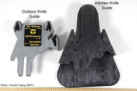

Outdoor Guide in place -
Guides - front -
Guides - back -

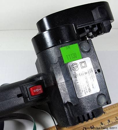

Switch:
under the handle - both momentary/hold for on, and lock on......

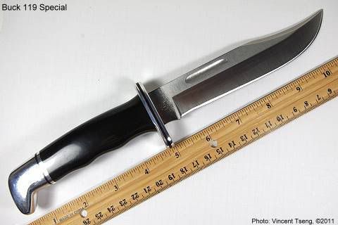

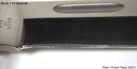

One of my biggest purchase disappointments was a
Buck 119 special - bought in the 1990's -
why was I devastatingly disappointed with this famous brand - well early versions of the Buck 119 Special had the famous Buck edge which was a kind of semi-convex - really sharp - my sample had a typical machine plain bevel no convexing - whatsoever.
I tried to give it a reasonable working edge - but it was so difficult - took me hours - and eventually I just gave up - so I knew this knife was going to be my "acid test" for the Work Sharp.
Detail of edge Before:

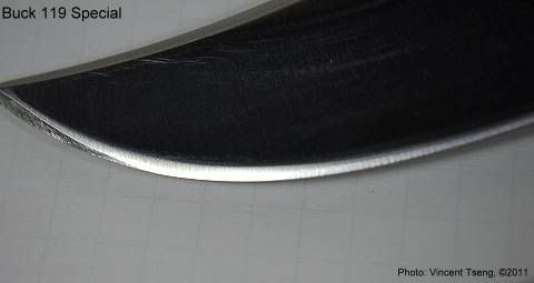

After 3 passes of medium grit belt - then 3 passes of fine grit belt each side -
this pic may not show how good the convexed edge is.......
But nearer the tip does:
Yes, I realize the very tip has not been ground - and still shows the original obtuse edge - but look at the rest - that is incredible for just a few minutes' worth of non-work.

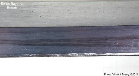

So what about something that's just not supposed to be sharpened -
I have a Swiss Bayonet - they are for sticking not really for cutting and the edge need not be sharp -
but being obstinate, I want to see if it can be sharpened -
Edge before:

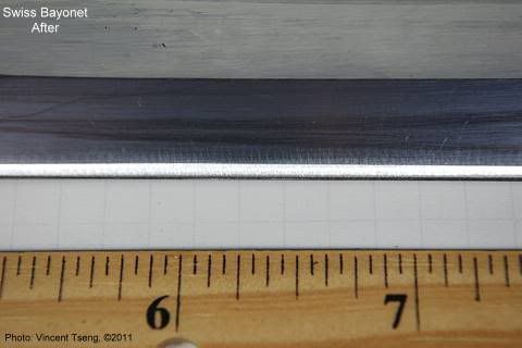

Swiss Bayonet edge after:
Yes, it was "harder" I had to resort to using the coarse belt -
but I had never been able to put anything like an edge of this thing - after only minutes - I won't quite claim it's sharp - but the progress is astounding....... I am just so impressed - this is not really a "fair" test" since bayonets are not supposed to be knife sharp - especially not this type.

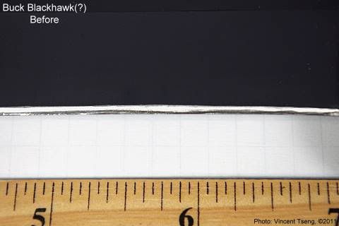

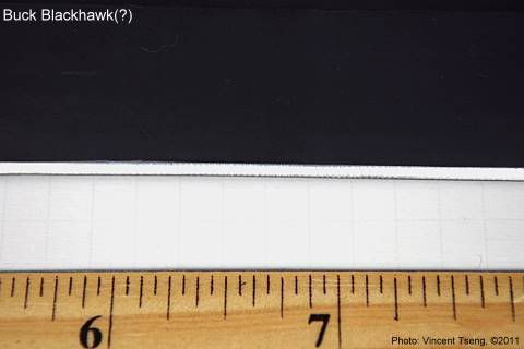

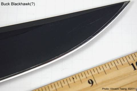

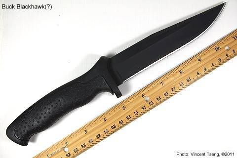

I had an old Buck Blackhawk(? I think that's what it was called)
again one of those knives I have never managed to sharpen well - I did attempt at putting on a convexed edge - but the blade toward the edge was just too thick (my excuse) -
Before:
hopefully one can see my attempt at sharpening....
Few minutes later from the Work Sharp -
again this may not show the convexing that well -
but this one is easier to see:

Thanks for reminding me about these......there was one posted in the Busse Forum and when thread sunk off the first page I had forgot about these
Hi, Vincent. I always enjoyed your reviews on CPF, and this one is great too, and with excellent pics. Thanks.
I have likewise been enjoying my new Work Sharp. I'm still mainly practicing on cheap knives, but did do a little polishing on one nice one. This is an impressive little machine, particularly for someone who doesn't really have a good place for a full size belt sander.
One question: When I use the 40 degree "kitchen knife" guide, and place the blade in the left slot, flat against the left guide as advised, the guide tilts to the left several degrees (~ 3/16"). Is this normal? I can get the guide to remain in place by placing my thumb on it and applying pressure to keep it from moving left, but this is a bit awkward. Anyone else have this issue?
Thanks, and thanks for the review.
Andrew
Andrew - many thanks for the response and kind words.
I really don't think a wobbly guide should be normal -
the outdoor knife guide is a lot more stable and stays put.
I noticed that too on the kitchen guide.
Although holding/putting pressure on top will stop it from moving - this is awkward as most people do not have three hands. One also could "jerry-rig" something like taping the guide in place - but really one shouldn't have to do that.
I managed a work-around - mostly it's because the belt runs upwards on that side and we put a bit more pressure on the blade to keep it in place - and with my early inexperience - that results in more pressure on the guide and pushing it out of place.
Once I realized what I was doing - I simply put less side ways pressure and used/allowed the knife's own weight to apply the pressure.
In other words a very light pressure on the side of the guide is enough - don't press hard because when the belt runs it will result in the guide tipping out of place.
However this is something Work Sharp ought to look at as the kitchen knife guide ought to be as stable as the outdoor knife one.

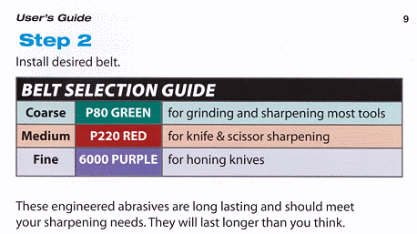

In the kit Work Sharp supply 2 sets of 3 belts -
The three grits are:
P80 (coarse)
P220 (medium)
6000 (fine/polishing)
Scan from the manual -
They are standard 1/2" x12" belts -
so ought to be commonly available -
except for the 6000 fine polishing grit which are specially made for them.
I am by no stretch of the imagination a grits expert
(I thought it was some kind of cereal :p)
but the Wikipedia has a very nice table of grits.
P80 - is the finest grit of "Medium (sanding bare wood in preparation for finishing, for gentle removal of varnish, also used for skateboard grip tape)"
the next finer grit listed in the Wikipedia table is P100 - "Fine (sanding bare wood in preparation for finishing, not suitable for removing varnish or paint from wood, use for cleaning plaster and water stain from wood)"
So P80 seems very well chosen to be just coarse enough to "remove varnish from wood" - since it is a powered belt and on steel this seems to me (remember I am not an expert) just the right grit for removal of steel to re-profile.
P220 - is again the finest grit in "Very Fine (sanding of bare wood)" - again to me well chosen for a powered belt - to sharpen steel.
6000 is not even on the table (for wood) being an ultra fine grit - but it does polish well.

Thanks for this review Vincent! Your detailed report and pictures really tell the story about our tool.
Your advice to AFAustin is spot on. Using less pressure on the guide is the best way to minimize its movement when sharpening.
You can also tighten the fastener on the back if you wish a snugger fit. Light pressure in the guides always nets the best results.
We have a new sharpening guide on the website! (see Sportsman's Sharpener --> Accessories)
This new guide is a 20° angle like the Kitchen Knife guide, but designed in the style of the open frame Hunting Knife Guide.
This has a snug fit and delivers the 20° bevel angle and an additional scissor sharpening guide.

2) The new "open" 20 degree guide looks interesting. What are its advantages over the included "closed" 20 degree guide?
I am not Work Sharp - but here's my 2 cents -
the main difference between the outdoor and kitchen guides - is the outdoor guide allows sharpening right up to the choil - whereas most kitchen knives do not have a choil, so WS can have a more covered guide for kitchen knives - the more covered kitchen guide would stop any knife from being sharpened right up to the choil.
However not to take anything away from the sales of the new 20deg outdoor guide -
there is an extremely easy way to get a 20deg convex edge using the WS.
Keep the outdoor guide in place - it helps -
now instead of placing the opposite face against the guide -
keep the blade vertical - the angle is now exactly 20degs as long as the WS is on a level/horizontal surface.

As for tightening that fastener, use a 3/8" SAE wrench or your multi tool pliers.
We are indeed listening to you guys and exploring other guide angles, belt options and more.

In the review I did a Buck Blackhawk which has a black finish -
and the blade was pretty thick (one of my complaints) -
there was no damage to the finish -
which would really show in the photos
I also did sharpening of a Swiss Bayonet which has a really thick blade -
in fact as I mentioned it is not even really supposed to be sharpened.
Although the before and after pics have different exposures
(as I wanted to show the edge better in the after pic) -
I can't see any marring of the surface.
If you use the guide and go carefully at first there ought to be no danger of marring the surface -
if in any doubt - I was advised - practice on something that's a beater -

I jumped right into sharpening that Buck 119 Special -
without any prior practice
and within what seemed like moments I had a beautiful convex edge -
as shown in the pics - I really do not have any special skills with this sharpener,
and I was a rank novice with my first sharpening -
for me it was effortless -
I was just so p*ssed it was that simple -
what would have taken me hours by hand
(and I had actually given up on that Buck 119 Special years ago)
was done in what almost seemed like matter of seconds -
alright, alright, a few minutes at the most -
can't see any marring in the pics.
Also, how close to a mirror finish does the 6000 grit belts get? I love how the edges look with a Wicked edge. Are there after market belts that I can get that could help?
6000 grit is supposed to be a lot (4x?) finer than 1600 grit -
and using a high speed belt/machine should give a much, much finer polished finish than any hand honing with 1600 grit........
Thanks!
Could happen depending on your skill. I made one hell of a wide bevel on the tip of my Strider WP-C because I failed to take into account that it would be thicker at the tip, and thus a more obtuse angle is needed for the tip than for the rest of the blade.
The 6000 grit is too fine to put a mirror finish on the edge from the P220 belt. It might polish it slightly, but you need a lot more belts in between the two if you want a good mirror polish. I don't see the point though. Because it's a convex edge, you really don't appreciate the mirror polish as well because the curvature distorts the reflection and makes everything look "smaller" so to speak.
