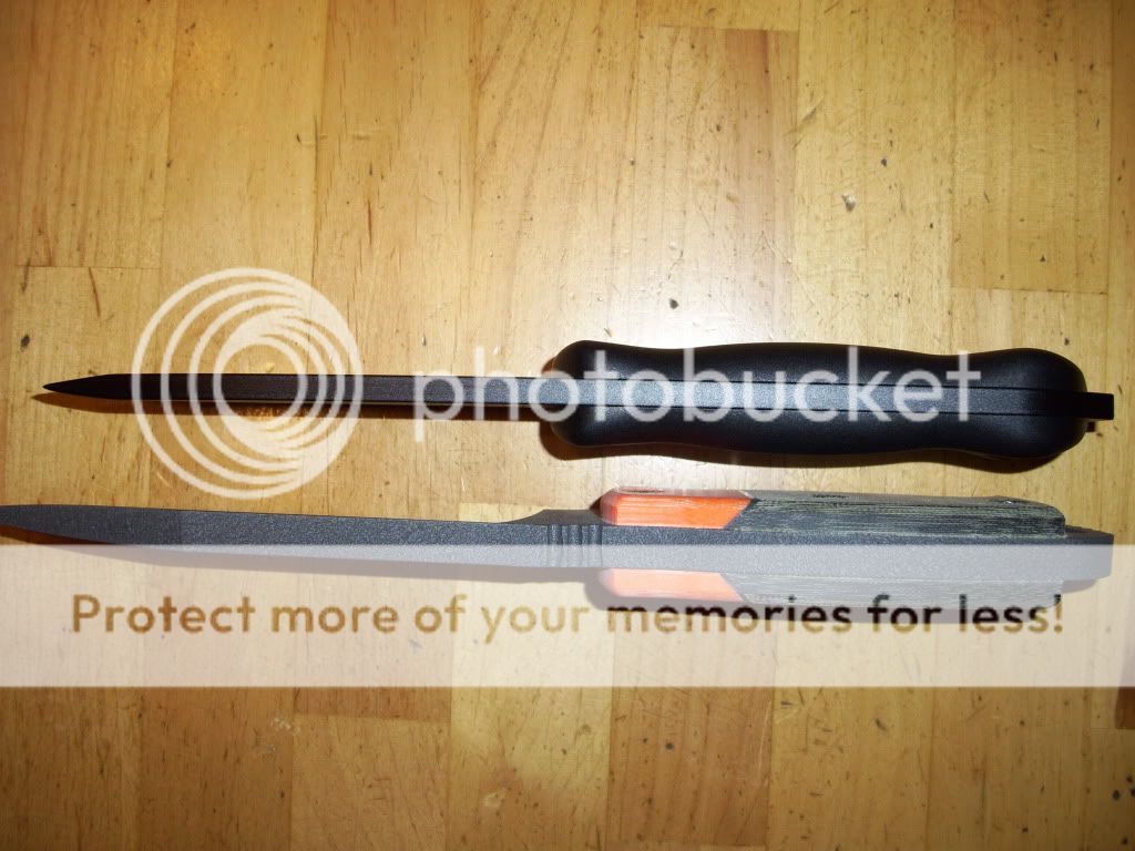

Here's one that's 1/4" thick, a Busse Custom shop Badger Attack. It's a great knife to have on you if you're out and need to skin a buick or pry open a bank vault- don't think there's any sort of abuse that it wouldn't be able to handle.
For full disclosure, as I haven't skinned a Buick since my sedan hunting days, I ended up selling this one off- but it was a monster in hand.

I haven't measured the spine, but I'm sure it's close to 3/8". It makes my nmfbm spine look thin.
