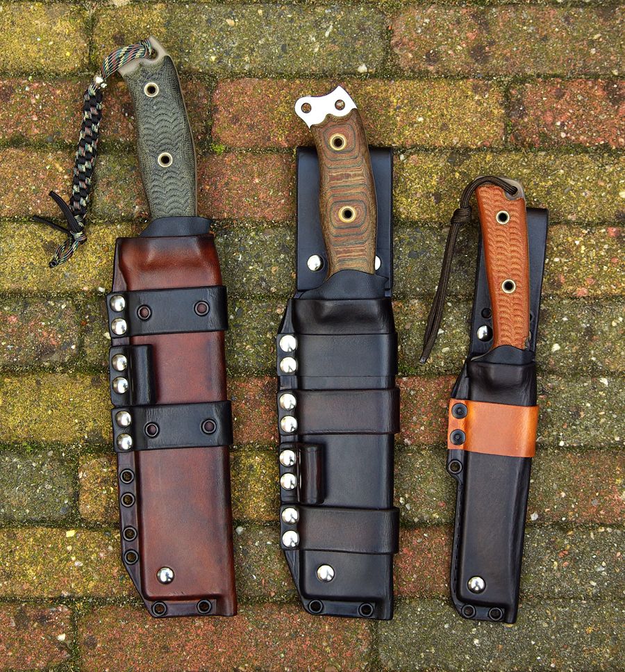

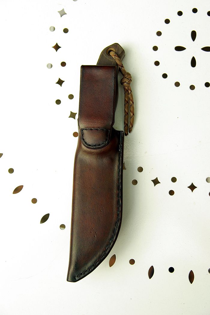

I recently finished these three..
They all have removable kydex liners, and a modular set-up. All pieces are detachable, and movable to suit as many particular carry needs as possible.
Kydex is 0.093”, and the leather is 2.5mm halftanned.
Kydex backplate is 0.125” kydex.

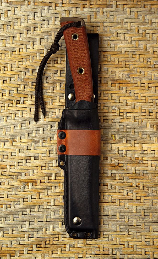

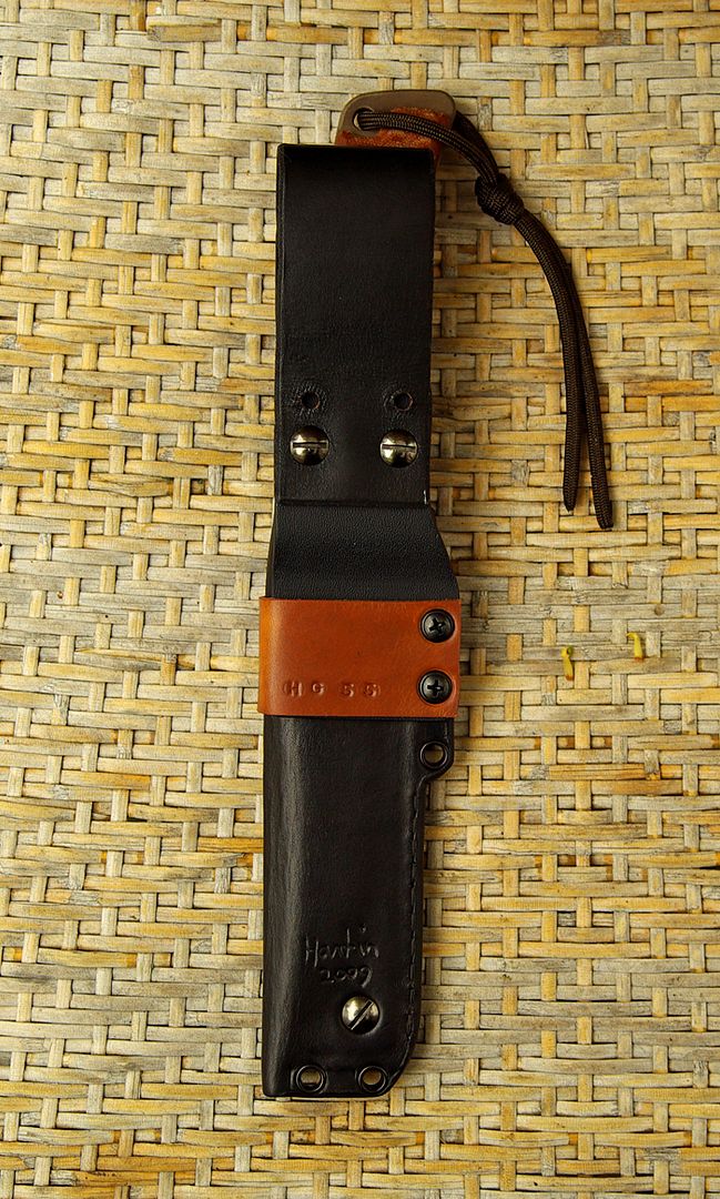

HG-55
This one takes a teklok, droploop or IWB loop.

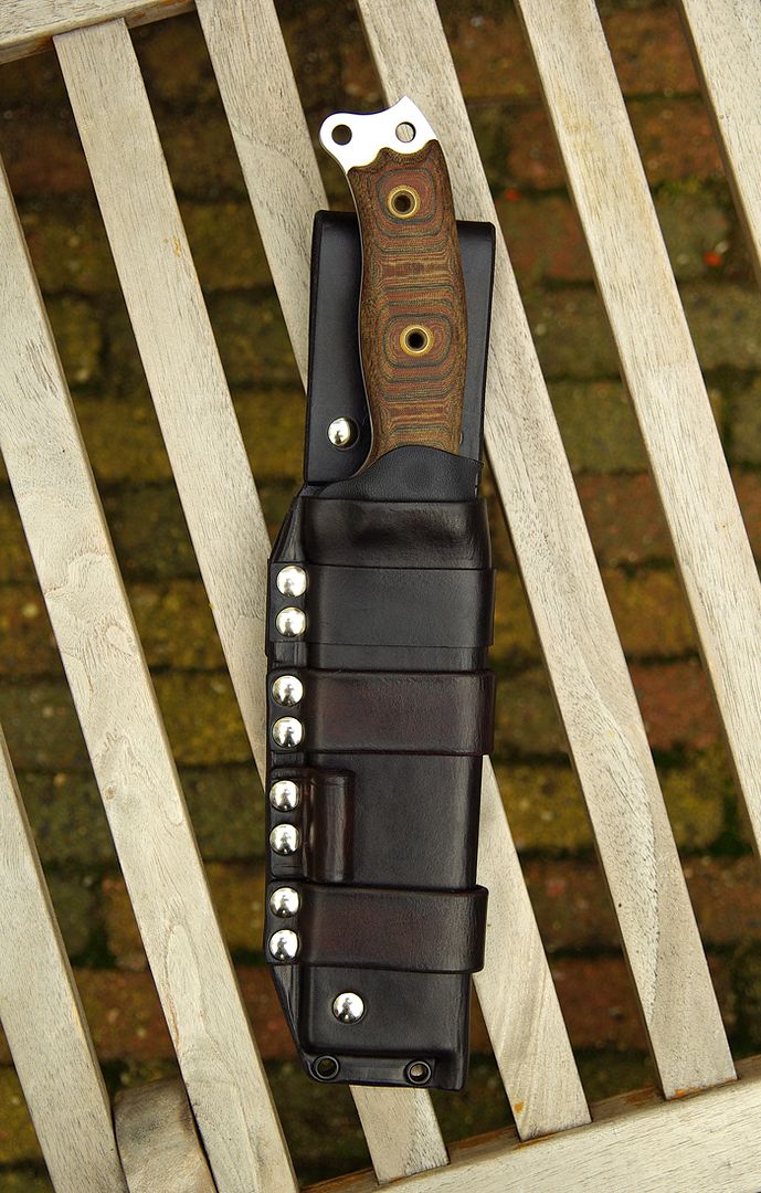

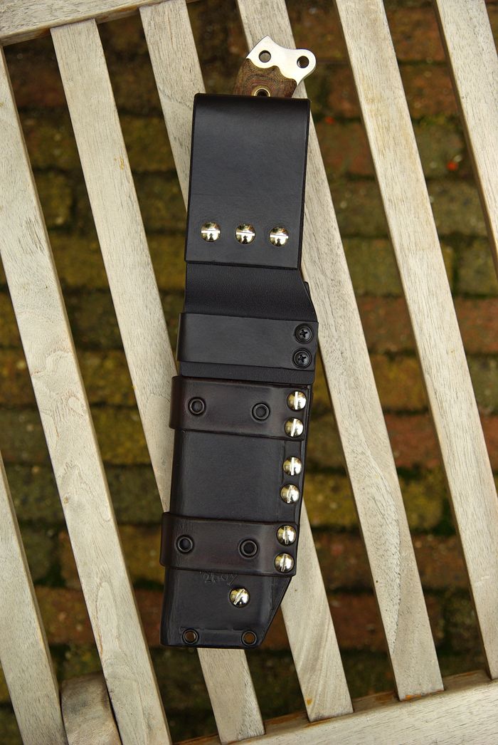

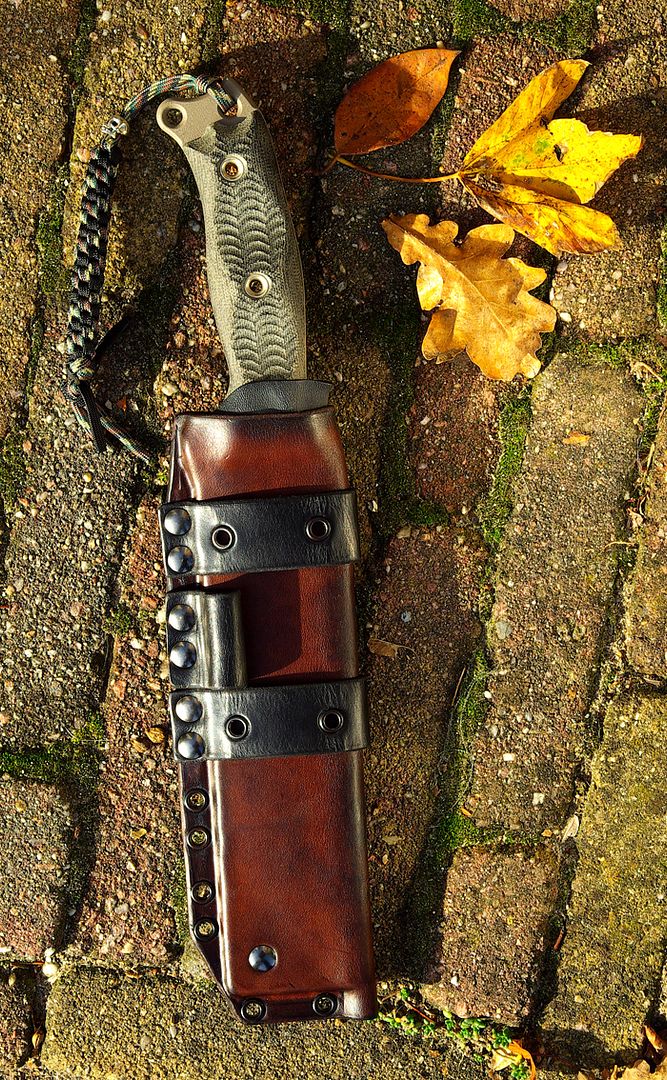

SFNO LE
The kydex backplate and the pouch will take a large teklok. The back of the loops can be mounted with long molle loks.

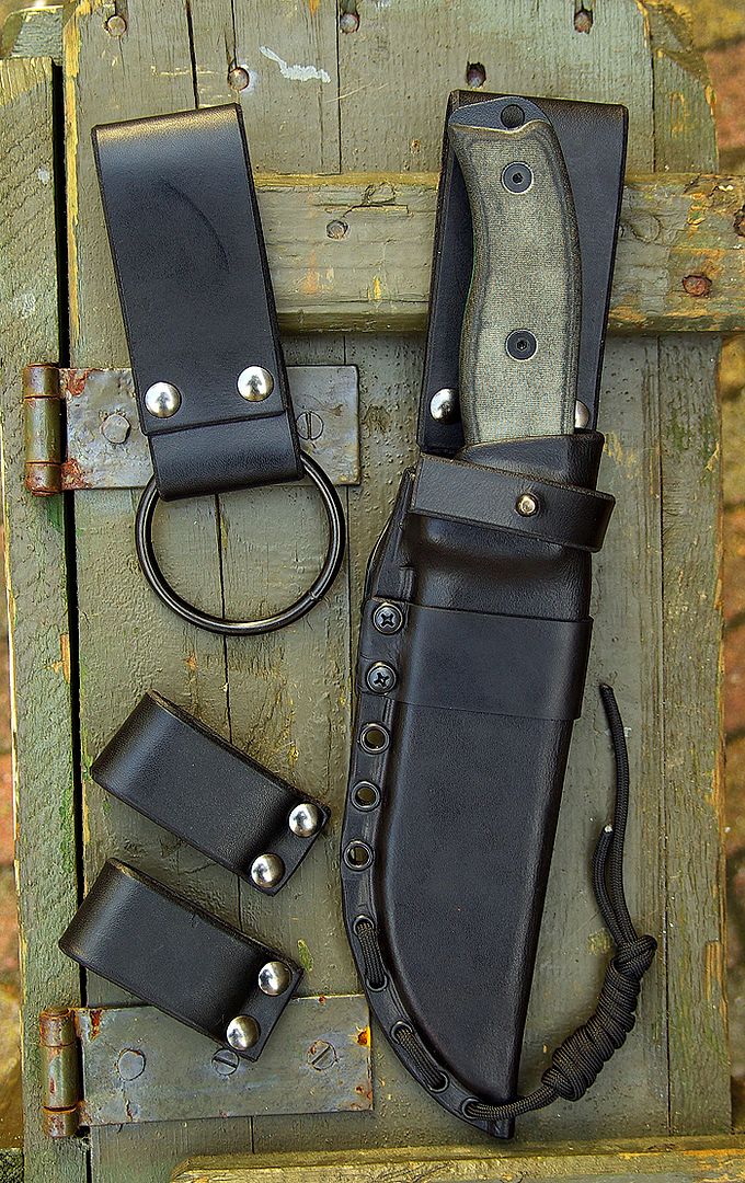

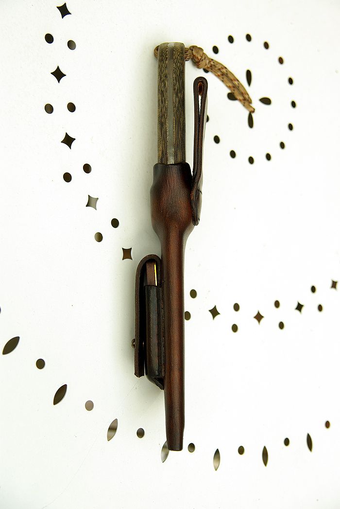

NMSFNO
This one symetrical too. The eyelets in the loops take tekloks, large or small molle loks.
I hope you like them.
looking great.
I made two leather sheaths last week, one for a GW, and one for an SS. Leather work is just that.......work. I can't believe how hard it is to punch through four or more layers of 10-11 ounce leather (or maybe it was 11-12 ounce).
I have looked at your page a number of times and absolutely love the look of your sheaths. Fantastic work man, really!
