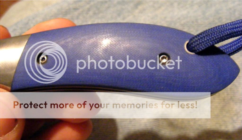

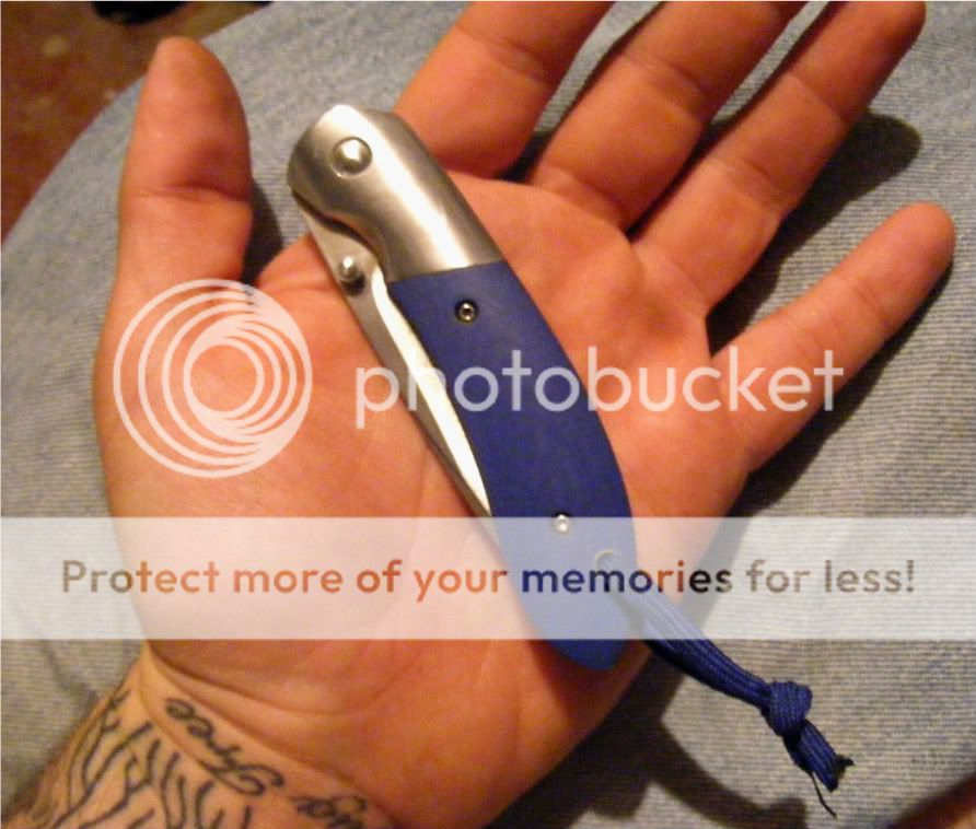

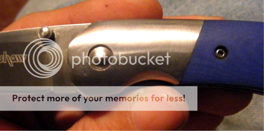

The Handle: The Crown comes in at 4-1/4" closed and weighs 3.7 ounces. The handles are stainless steel with micarta insets. The stainless bolsters on mine came pretty dull, but polished up readily with some simichrome polish.
The micarta came perfectly matched to the handle; no overlaying or underlaying spots, no rough patches. The grain in mine looks really nice, and most of those at the store looked nice as well. I'm thinking about roughing them up with some fine-grit sandpaper and then sealing it to bring out the grain, but it looks pretty darn good as is. There's a small swell near the butt of the handle so your can get a good fit to your hand. A lined lanyard hole is provided.

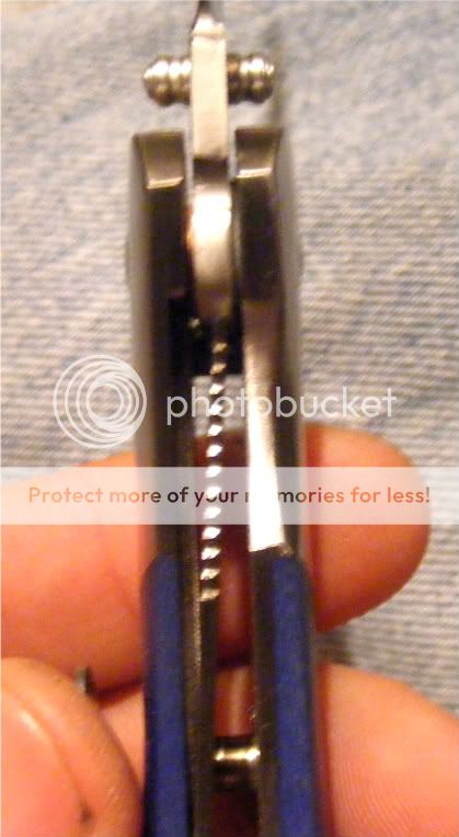

The Crown locks via linerlock, which sports some jimping. Lock-up on mine is great, with no play in any direction.

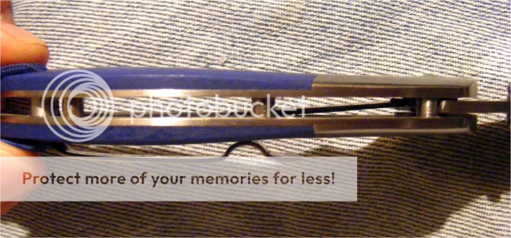

The linerlock is easy to get to, even with gloves on. The knife has an open back; good for blowing out pocket lint or other debris.

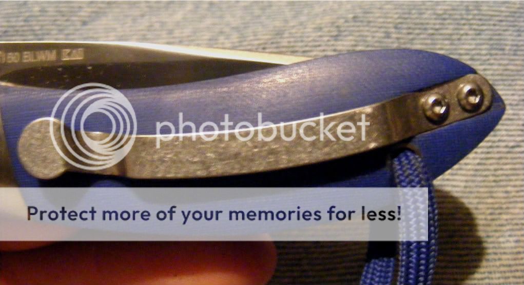

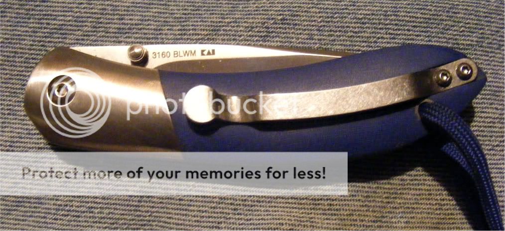

The Crown comes with a removable pocket clip. It's stonewashed, and has a contrast to the rest of the polished knife that says "thrown on" to me.
The clip itself is right-hand tip-up and can be taken off via two Torx (T-6) screws, but cannot be positioned in any other way on the knife. Retention, for me, is a bit loose. Even bending the clip a bit didn't help. The problem is that the metal used in the clip material is just too "bendy". Still, it's never left my pocket without me wanting it to.

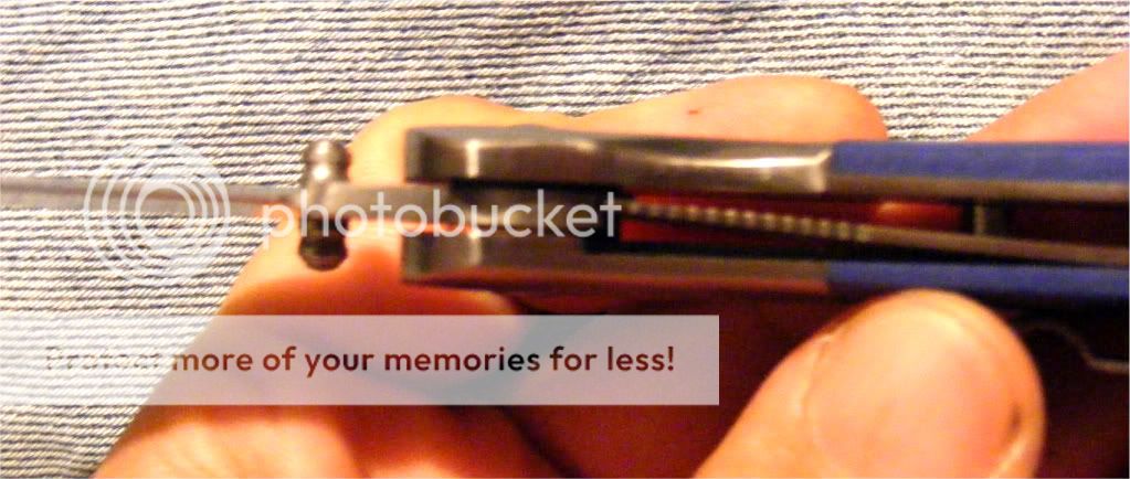

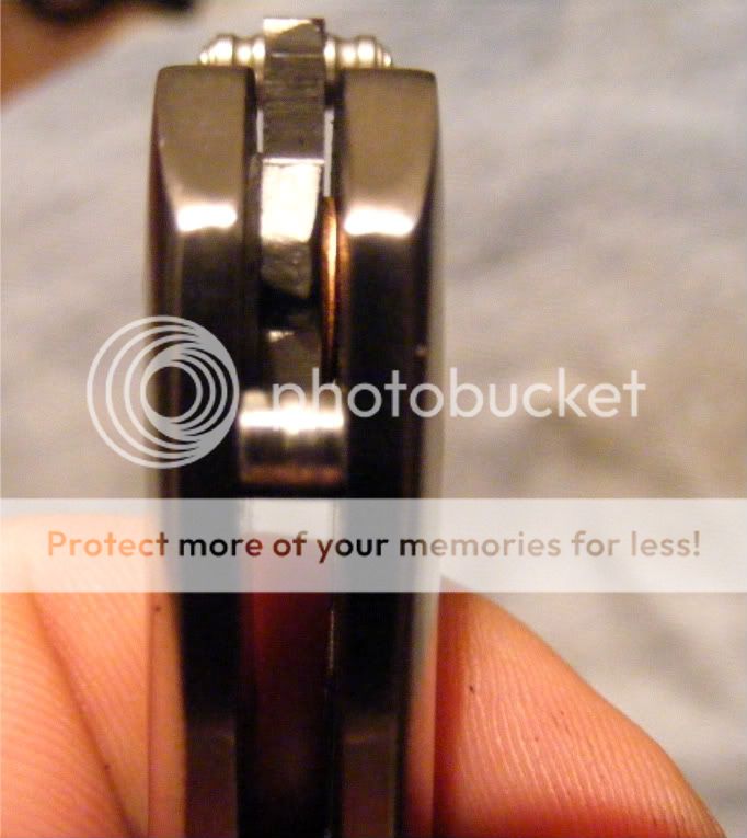

This view is from the back, showing the stop pin and phosphor bronze bushing that the blade rides on. The other side of the blade has a white nylon bushing.

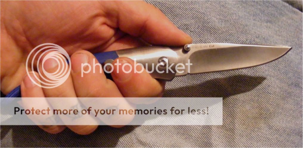

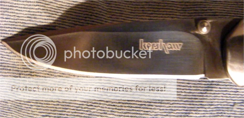

The Blade: The Crown sports a 3-1/4" blade made of hollow-ground 8Cr13MoV stainless steel. Mine tested at 57 on the Rockwell scale. The blade is a clip point with a smooth belly. It came out of the package pretty sharp, and needed only a light stropping to shave hair. A little polishing really brought out the "niceness" of the blade.

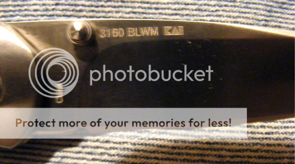

The model number...

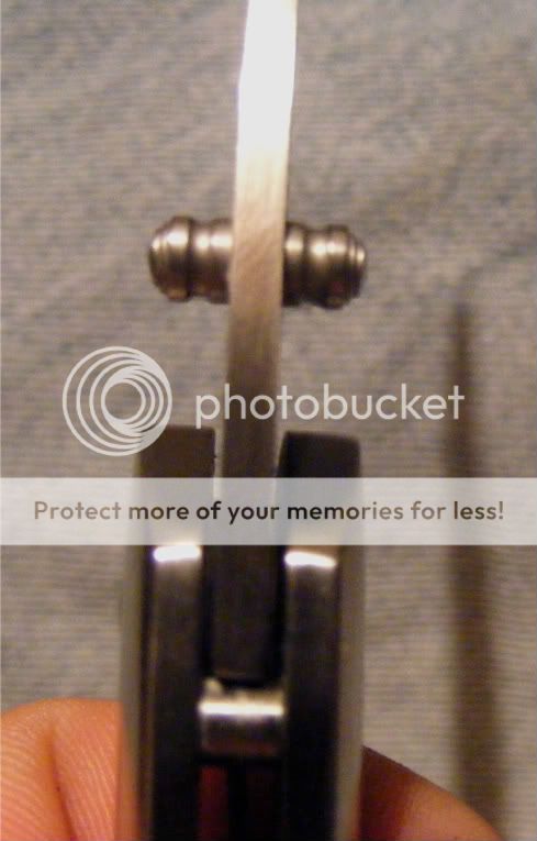

The blade is deployed with thumb studs, one on each side of the blade. I've found no real issues with them, but some might not like the flared shape.
Mine opens really fast, with only a "loaded" thumb flick. No wrist action required. The blade is just long enough for most EDC tasks, while still being short enough to not intimidate non-knife people. Oh, if you want to adjust the tension in yours, it takes a Torx (T-8) bit. Like I said, lock-up on mine is solid.

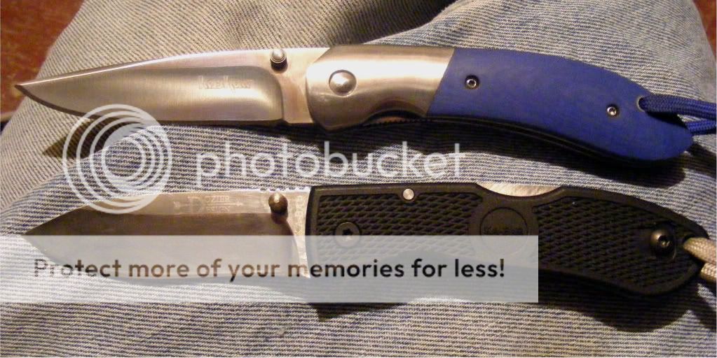

With a Kabar Dozier for size reference...
