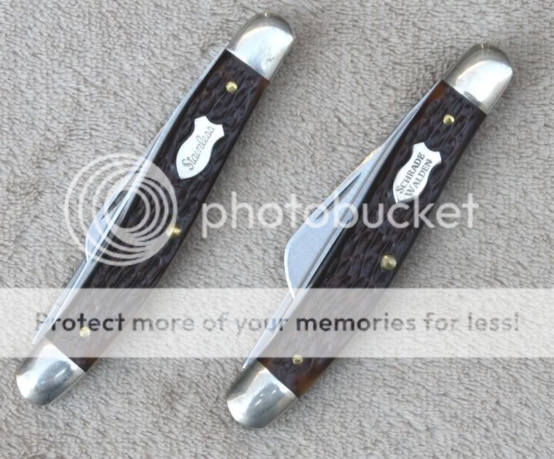

Filing the kick is something easily done with a Dremel too. As it has been mentioned, care must be taken to not file of too much. Then the blade edge could hit the spring or you loose the nail nick (like on a stockman sheepsfoot or spey).
My GEC 73 Tractor Green point stuck out a bit after I rounded the top of the handle to make it more smooth. I easily took care of this the way previously mentioned. The tape on the blade helps also. I also sanded in a notch with the Dremel so as to make it an "easy open" as the spring is strong and I like to pinch the knife open anyways. Since it's a user an not a safe queen, it suits my use just fine.

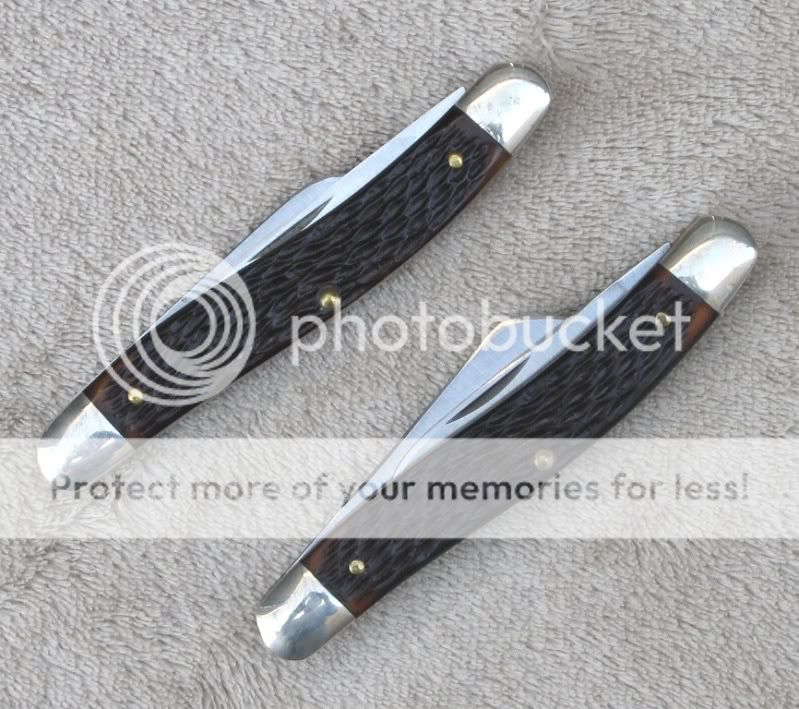

Here you can see how the modification affected a Schrade serpentine stockman. The sheepsfoot on Schrade stockman ride pretty high by nature, and this one shows a modified spey blade as well.
Two like knives front view.

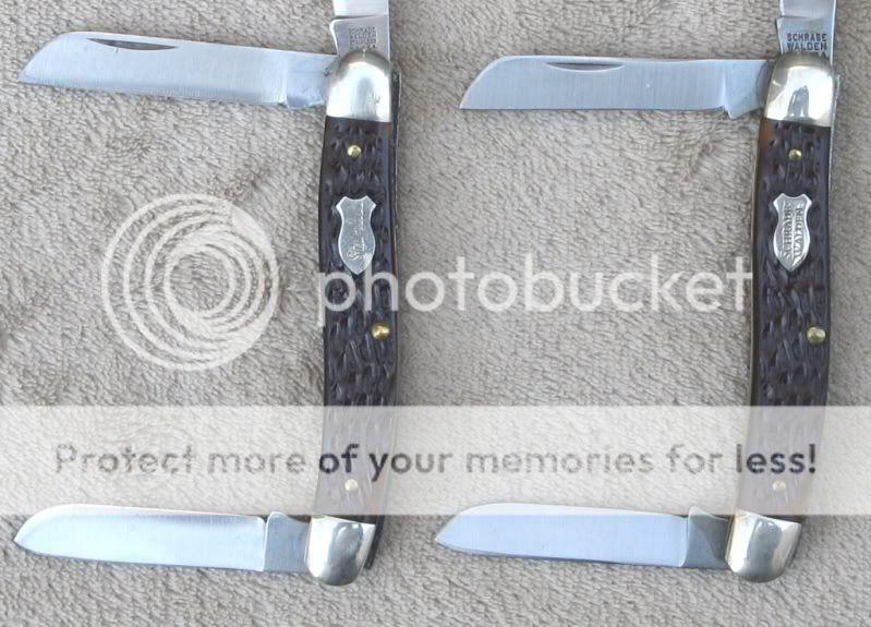

The back view, notice clearance of nail nick on the spey blade.
View with blades open, and easy to see where the kick was taken down a bit. Very small amount on the spey blade.

The work appears minimal, though I did not do it on these knives (something I noticed right away when I got the modified one), and could surely screw something that simple up. It sure gives the modified knife a sleek appearance, and still provides plenty of room for access to the nail nicks.
