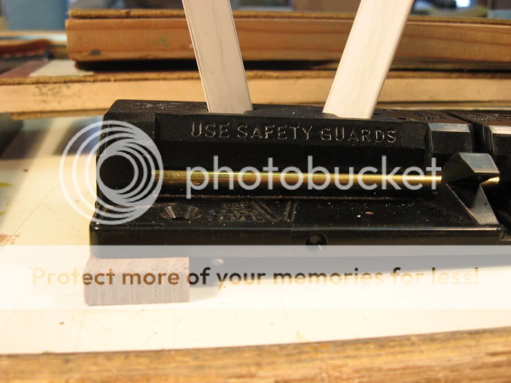

No pictures at the moment, but I've heard of guys putting one of the stones you are not using at the moment under the sharpmaker base (perpendicular to the base) in the v-groove slot there. THis creates a see-saw-like base. WHen sharpening the left side, you hold the left side of the base to increase the angle, or the right side to decrease the angle. Then you hold the opposite side when sharpening the right side of the knife. I forget which angles are obtained.
I use a 1/4" wood spacer under one end of the Sharpmaker base. I have each end marked because, using a protractor, I determined exactly where to place it to decrease my angle (using rods in the 15 degree holes) to 12.5 degrees. I'll sharpen say 15 strokes on the left rod, then switch the spacer to the right side (under the marks in the base that I etched there), and sharpen the right side of the blade.

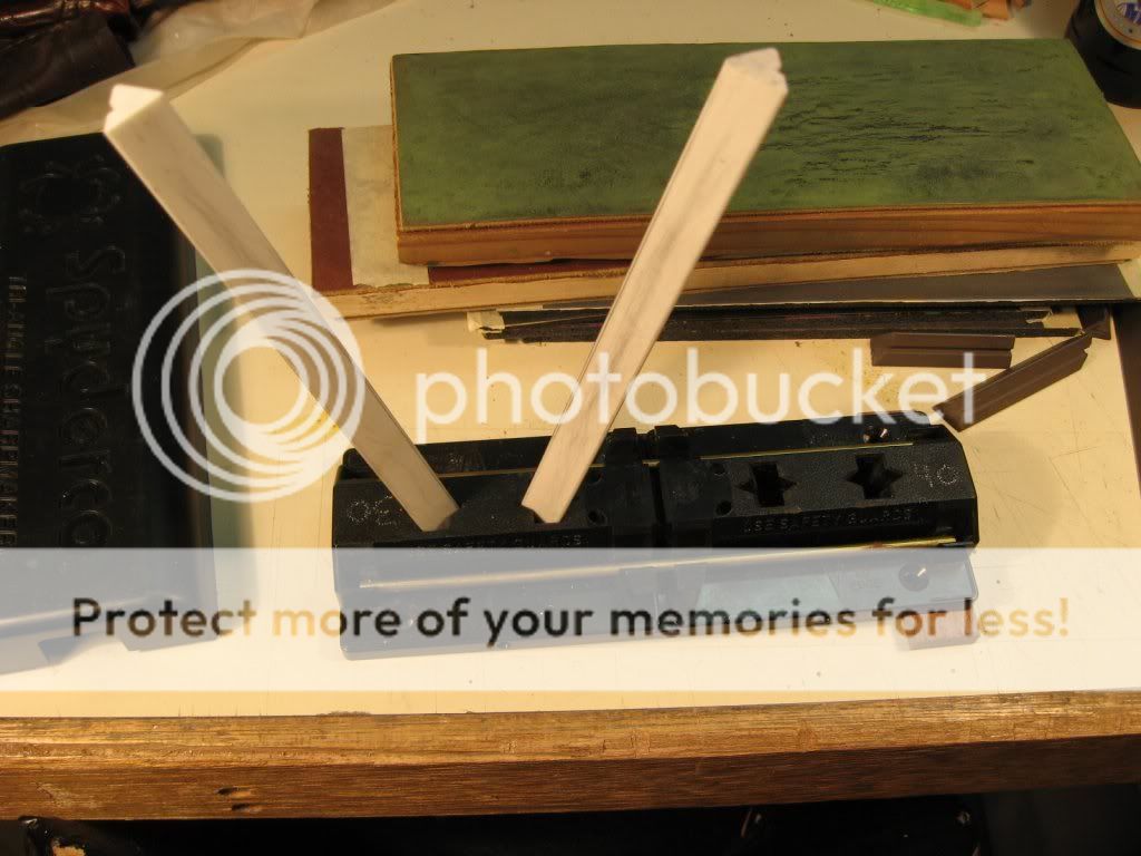

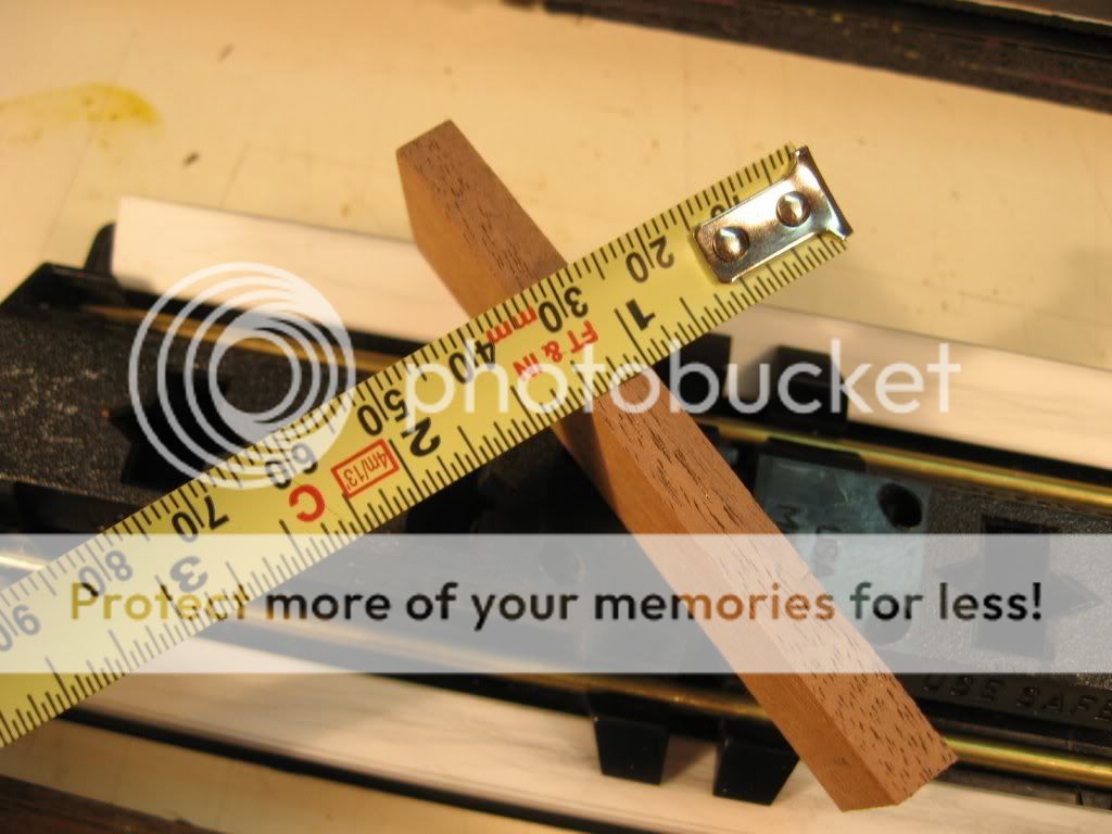

Here is a 9/32" piece of wood that I use on the Sharpmaker. When it's flush with the end, it gives me 12.5 degrees (25 inclusive). I'll stroke 10 or 15 or 20 strokes, swap the spacer end for end, and do the other side, and on and on.
I hope this is what you were looking for in the way of pictures. Sorry this took so long. I used a protractor to measure the angle and adjust the spacer.
Hmmmm. I'm just thinking of something I haven't considered before. I hope I haven't sharpened my knives this way before when re-beveling. The spacer must go in the middle if not on the end!!! I think this is right!
