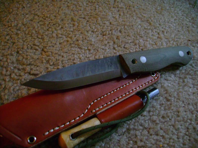

I'm psyched to get my second Bushcraft. It'll be saved for my oldest boy, when he's old enough. Pic of my current user...
