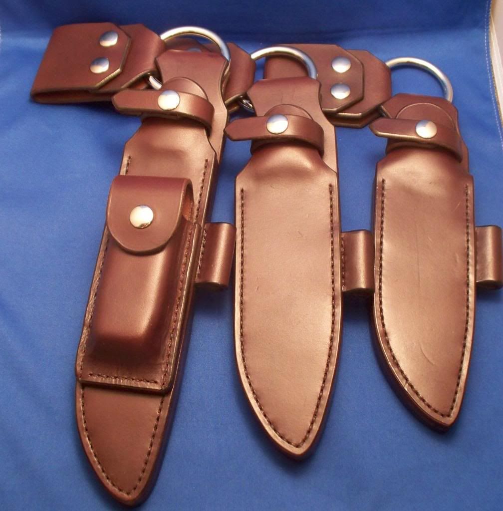

Contact Talfuchre. You can find him in Wilderness & Survival and probably on Sheaths & Such. I'm sure he makes a dangler strap you can put on or take off. Great idea, really.
What I do is thread a toy carabiner onto my belt, and put a big round split ring through the sheath loop. Then I can snap it on or off the carabiner at will.

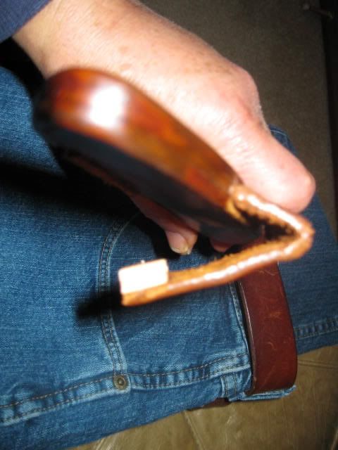

I've been "engineering" an idea in my mind all week....I'll be doing a prototype of it this week-end. I'll post pictures soon as I can.
As above, I'd go with a D ring and an extra bit of leather or canvas and some snaps and/or velcro. It's easy to do...everything can be done by hand...all the materials can be found for cheap. With my sheaths I've always added the dangler...personally I just really like that style.

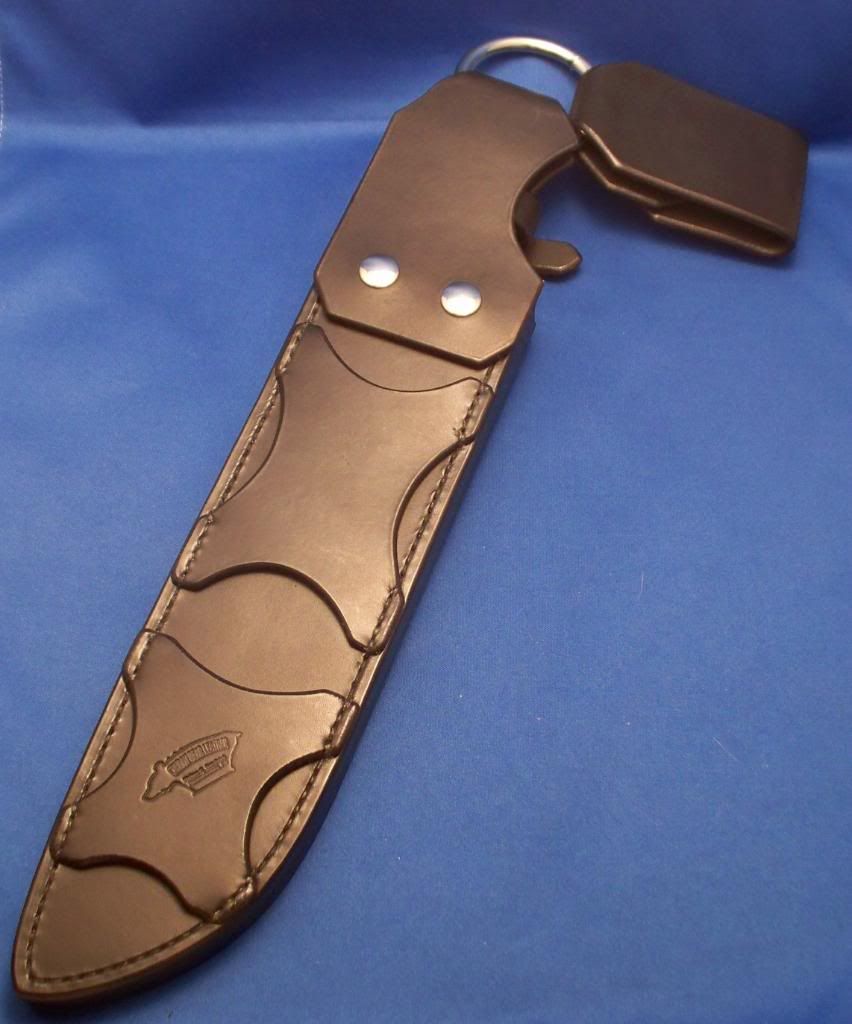

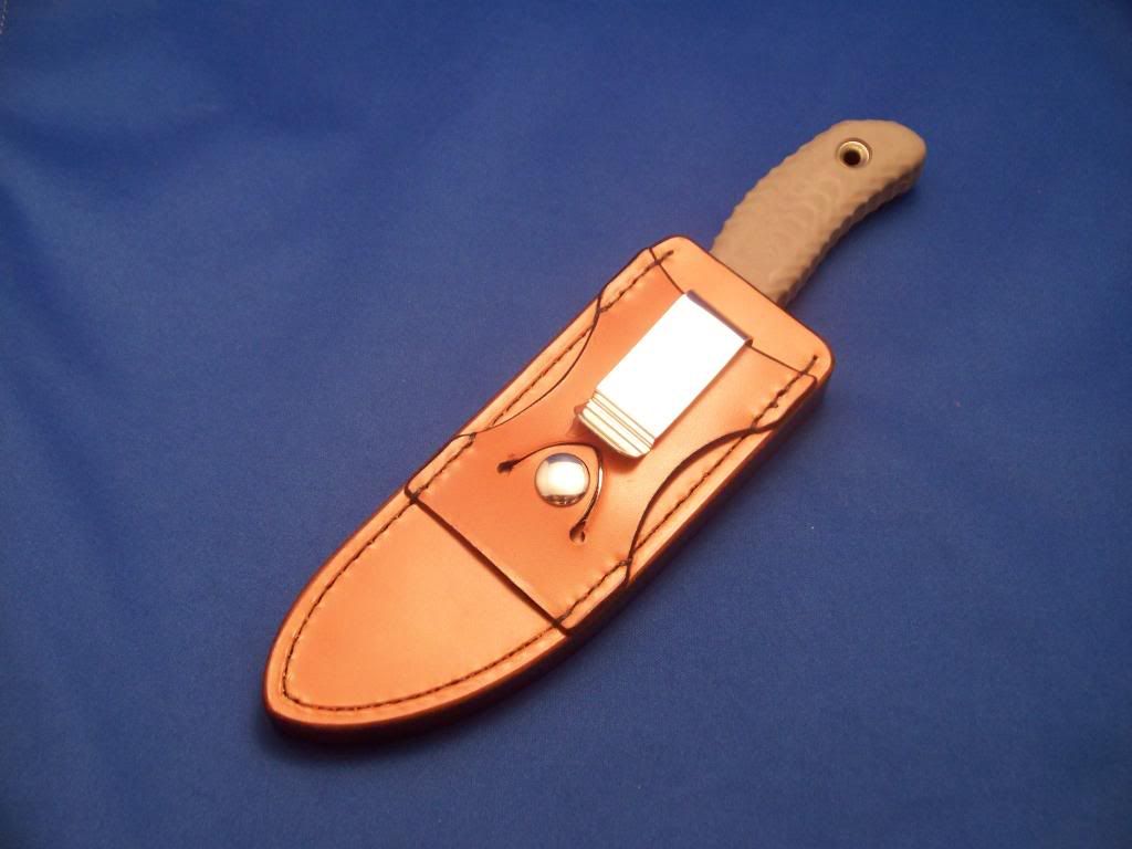

Something else to consider would be an integral clip on the sheath itself, if one were wanting to get fancy. Example : the Glock field knife. (BTW: not advertising any particular website with that...it was just the best pic I found on the fly...)
I imagine a similar construction could be done with kydex.

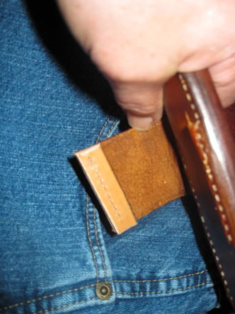

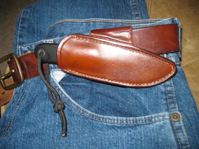

Here's one I'm field testing today....while this is a cross draw, I'm sure the same concept will work with a drop-leg style sheath.
I glued/stitch a couple layers of leather to the belt loop, the tension of the belt against your waist will hold the sheath in place while you extract the knife.
Since today is wear-sloppy-jeans-casual-Fri......I'll test it out and report back later this evening.....:D

You could even take that a step further if it shows potential by making the second piece of leather a little wider than the first, essentially forming a leather "hook" that will catch under your belt when pulled on.

If you have a kydex sheath, I can source a dangler (also sometimes called a dropper).

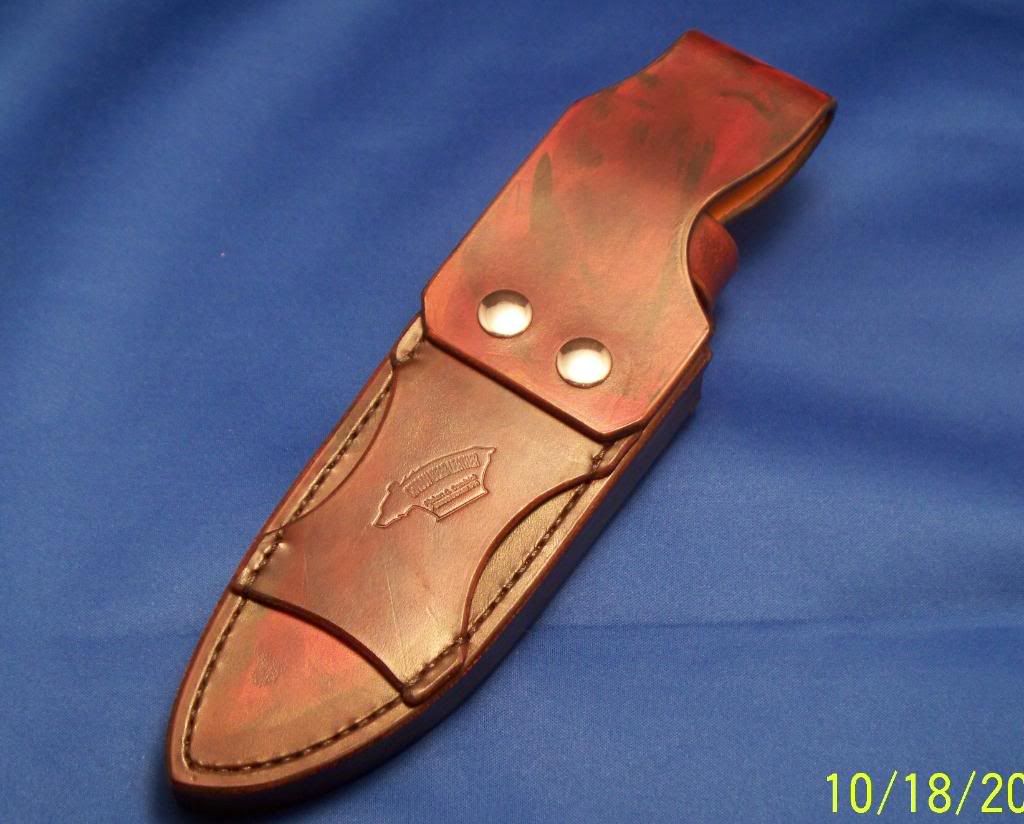

Well I use a simple toggle on the loop on my Scandi sheaths:
Or maybe a hook; the twist helps 'bite' into the back of the belt:
Or a a multi-carry option:
Crossdraw
Or Dangler/Dropper

Hoops...I agree, that would certainly lock it in....but after wearing it all day yesterday, I can assure you it's not needed.
The sheath stayed in place very nicely, and never shifted around on me at all.:thumbup:

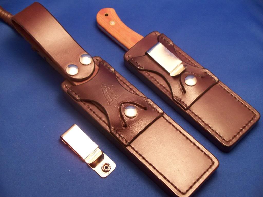

kydex? knife kits sells "clip over" belt loops, that can be taken on an off w/o removing the belt. might be a little too close to a Tek Loc, though, which i know you said you don't want. i've bought a few of them, for upcoming projects, haven't used them yet. they appear to be high quality and really handy. check 'em out if you haven't seen them before.
Chuddy Bear - OMG, those are some good looking sheaths!
