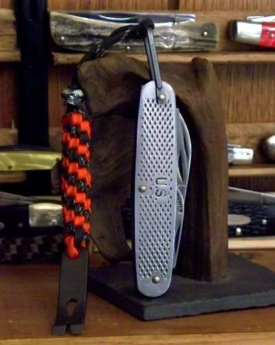

I'm talking about the stainless steel scaled scout pattern that Camillus and Schrade used to make.
If so, how good are they? I'm thinking about getting one to carry at work, since my 1967 Camillus would be so hard/expensive to replace.
I recently acquired one (Camillus) for a work-carry knife. In a nutshell, it's built pretty bombproof. You'd really have to go a long way to mess one up. I think it can take a lot of work/abuse. Construction is strong, all tools have strong snap and nothing wiggles or has any play in it. I like the main blade, its wider than a Vic Farmer blade and sharpened up pretty well, though the edge wasn't too bad out of the box. The standard screwdriver is much longer than the one on my Farmer, kind of like the old electrician's knives. The awl was ground to a razor tip and it actually cut me pretty good when it snapped shut on a finger. :o
Then there's that long bail. I don't know what to think of it. It's mostly in the way when not folded back along the handle. Not sure why it has to be that long. Not a show-stopper.
The finish is, well, pretty sad. Handle slabs out of the box were pretty darn rough around the edges and almost dead sharp from being stamped. I ended up knocking the edge off the handles with a 3M Scotchbrite wheel so it didn't wear my pants pocket out. And I gave the handles a satin finish on a buffing wheel just in attempt to make it less of a toolbox tool and more of a pocket knife.
In the end, you'll get what you intended: An unpretty workhorse that won't make you cry if it gets lost.

I don't have an Ontario, I have a Camillus, a 2006 knife. However, they appear to be made the same, and yes, they are bullet proof tanks. They do have a reputation for having bad back springs. Apparently the Back springs are made from the same steel as the rest of the knife, and have a tendency to break. However, I read somewhere that they had fixed this problem. The bale is rather cumbersome, but I kind've like it. It is a secure lanyard holder that won't break on you. It is a poorly finished knife, but it was originally made for soldiers to take out into the field, so it was meant for rough work. It's stainless steel body is built to take a beating, and all the tools are pretty hardy. The steel, at least on the Camillus, is ok at best. It holds it's edge ok, but that's it. However, if it's just a work knife, then a strop on your jeans during the day, and a small touch up on a stone or diamond every few days should be plenty. Some folks don't like this knife, and would rather have a Wenger SI, but me personally, I like the "Demo" knife. It is heavy and big and poorly finished, and ready for some get down and dirty type work. I agree, though, at $65, it's a bit pricey. I got mine for $30, and STILL thought it was a bit pricey. Check the bay and look for a better deal.
