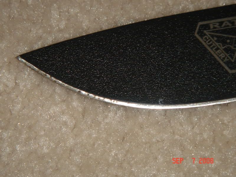

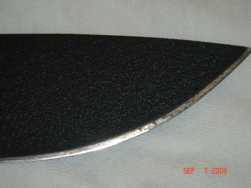

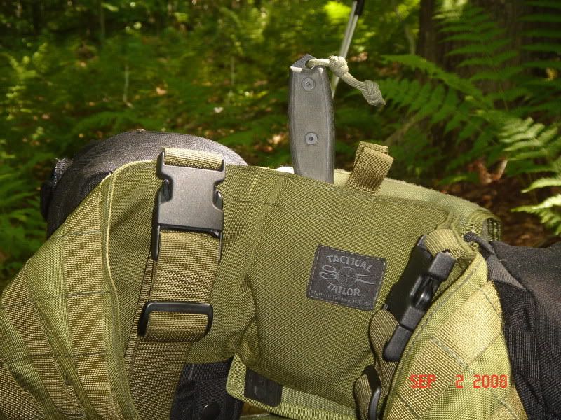

I did 5 days on the Susquehannock Trail in PA last September carrying my RC-3. It rode on my chest in a TT MAV and got plenty sweaty. It was used mainly for food prep. Daily maintenance was basically wipe clean with water. All that resulted were some rust spots along the sharpened edge. No big deal. They were gone after a few swipes on my sharpener when I returned home.
The ride...
http://i93.photobucket.com/albums/l45/gander6/STS080901009.jpg
The specks...
http://i93.photobucket.com/albums/l45/gander6/STS080901074.jpg
http://i93.photobucket.com/albums/l45/gander6/STS080901071.jpg
