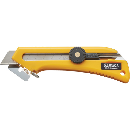

Best knife for cutting cardboard: Stanley 99E (~$5USD). Replacement blades come in bulk packs of 100 for $10 and you can get a pull-through sharpener for ~$5. A $20 bill will give you countless work hours of cutting cardboard.
There's various information here to consider, and I thank you all for it. There seem to be three major strains of thought:
* Use a boxcutter.
* Use an even super-er supersteel.
* Use a less refined (i.e., toothier) edge.
The first solution makes me sad, because the majority of my knife use is for cutting boxes. I don't hunt or skin animals or use my knives all that much for food prep at the office, and I'm not a leather worker or nautical rope cutter or wood whitler, so, it's mostly boxes. If I moved to a cheap boxcutter, my knives would get even less use and become little more than show pieces.
The second solution is reasonable, though of course it makes me wonder what to do with all of my existing knives.
The third solution presents a way for me to continue using my knives, so maybe this is for me the best solution.
