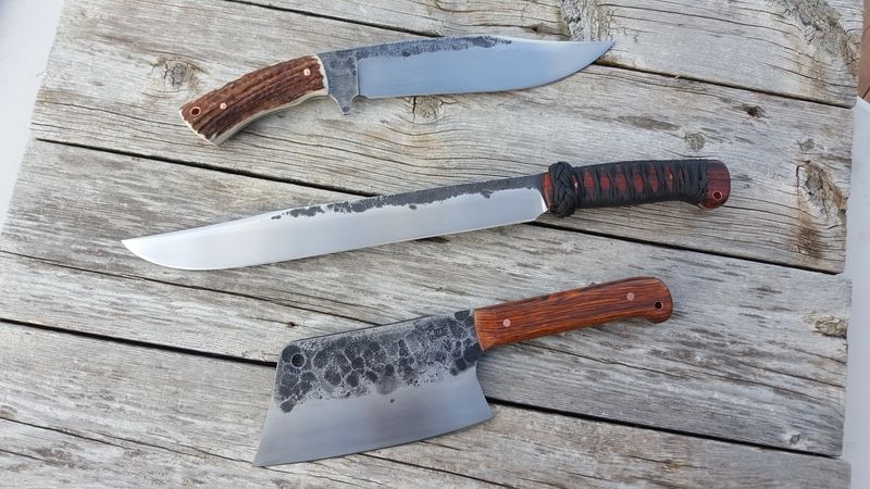

I don't know if there is an overall best....I think it depends on several factors - heat treat capabilities, if you need stainless or carbon steel, what you are chopping, cost, etc...
Here is a cleaver in 52100:
A chopper in L6:
And a bowie in 1084:
Then after the moose antler test here they are finished out:
I have also used 5160 and like it too:thumbup:
Next order from Aldo I'm gonna try 80crv2:)
