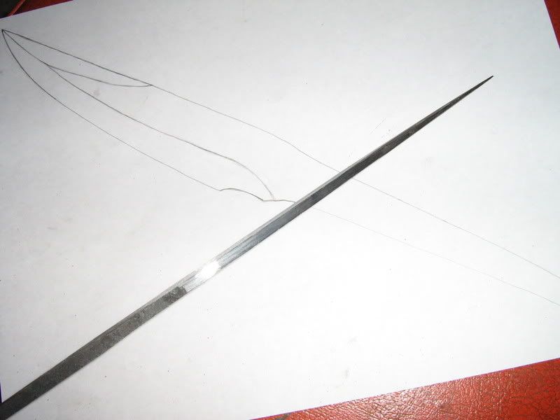

and from my post above:
Distal tapering refers to a blade's cross-section thinning from its base to its tip....meaning the spine (not sharp side :P) of the blade is thinner at the point than where it joins to the handle.
Tapered tang is referring to doing the same thing only tot he knife's tang. If you were looking at just the spine of the knife it would start thin at the tip and get fatter as it approached the handle. When the handle starts the spine (which is no referred to as the tang) will start to get thinner again.

Distal Taper
spine is thin at the point and fatter as it approaches the handle
Fill tang left...tapered tang right
