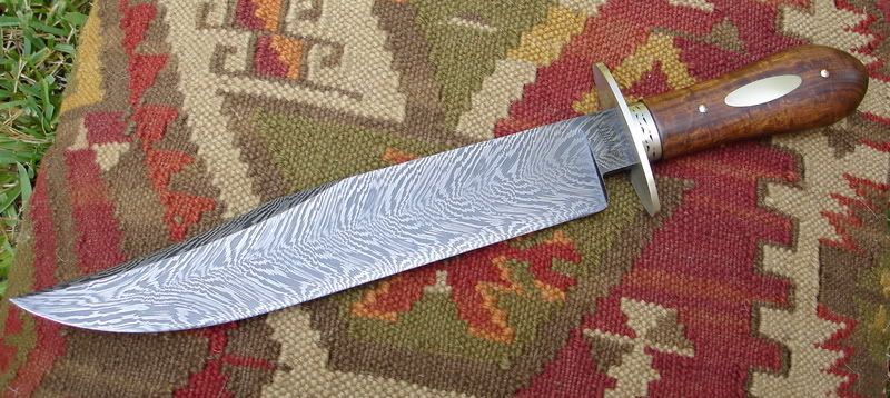

A good client and nice guy fell in love with a Ring Gidgee handled carbon Southwest Bowie I presented as one of my Master's knives in '04, and asked for a Damascus version. Here 'tis, 10 inches of 1084 and 15n20, with N/S fittings, and a beautiful piece of Ring Gidgee given to me by Sean McIntyre.
The Damascus was great fun to make, and rewards a closer look. What at first glance looks a standard two-bar twist, is in fact two four-bars, each made up of two high and two low count "W" billets.
Do you like that little shoulder where the handle meets the collar?
