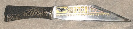

Here's a bonus pic of knife that I gave the full treatment to. the style of knife is called a "seax" (Beoram, pay heed), the 8th century Anglo-Saxon answer to the Bowie knife. I carved the handle, made and inserted the copper pins, etched and gilded the blade in copper and gold. 8-10 inches overall.
