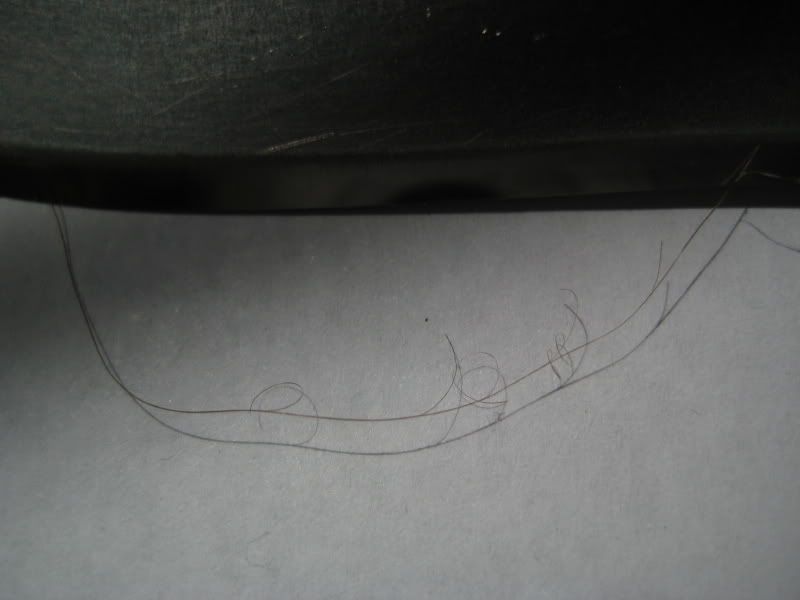

I've had good results with the older Buck 110s with 440c blades. Here's what I did with one today:
