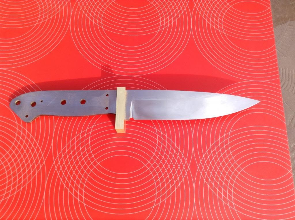

I wasn't able to acquire the TC before the weekend so I used the melting salt as a guide. Worked really well. Hardened and tempered well for me.
Just need to shape the guard more, and finish sanding and polishing. Those are just tape marks on the blade.
I'm very happy with this one.<a href="http://s1177.photobucket.com/user/weedwhacker1/media/my%20knives/knife3.jpg.html" target="_blank"><img
BTW the guy at Canadian Knifemaker Supplies told me the 1084 is Pickled and Annealed. 95% spherodized carbides.

Looks excellent.
Try and "round" things a bit more on the handle. Those hard 90° angles are way too blocky, and will be uncomfortable in use. The guard should have a taper toward the tip, too.

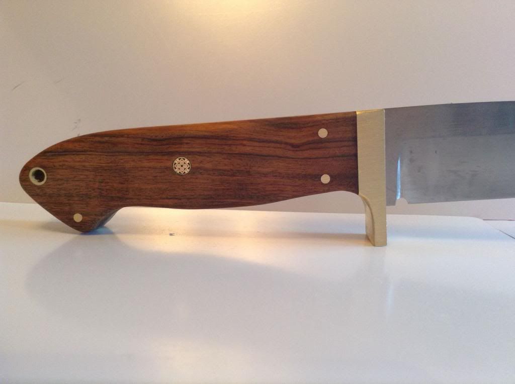

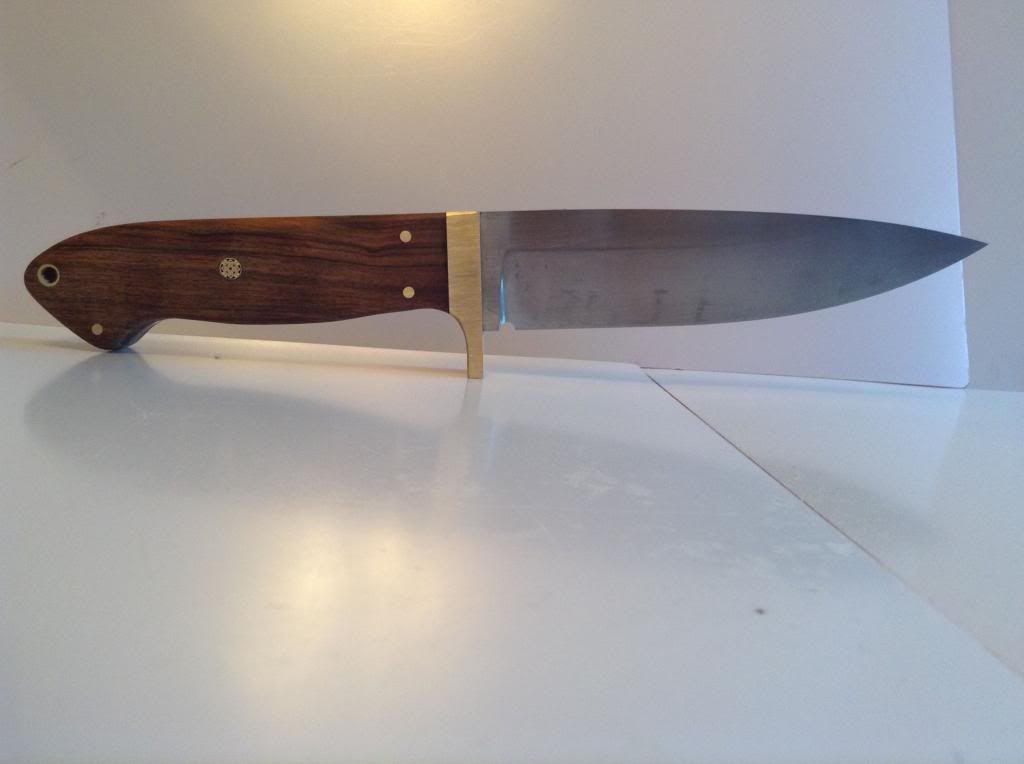

Finished the knife! Even finally got my user name changed...took a while but done.
All rounded out and less " blocky ", tapered as suggested etc. Used the melting salt trick for temps on the 1084 and also used a squashed pipe as a muffle. Sharpened beautifully and just glides through writing paper.I'm very pleased with the results and know how I can improve on my next blade.

Nice knife, although it suffers from the same ailment that many of us beginners inflict on our knives... blocky handle syndrome! You should round the edges more and make it sort of "Apple seed" shaped when viewed from the butt, with the edge side being the pointy end of the "Apple seed" other than that, it looks pretty darn good! Keep it up!
I like to call my blade edge an apple seed ( convex grind), and my handle shape an egg (ovoid). Handles are most comfortable when smaller at the bottom than the top, ...... much like my old girlfriends :)
