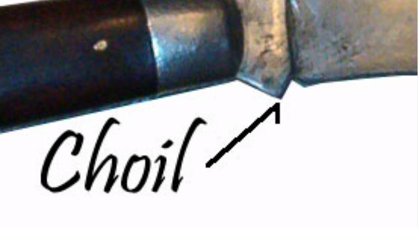

I can see why some people want choils on certain knives. Sometimes they make sense. Here are a couple that fall into the practical use of choils:

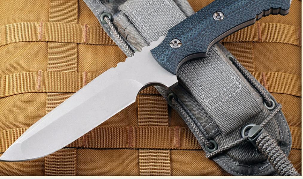

But can anyone explain this and what sense it makes on this kind of knife:
Is there anyone who wants a 5 inch blade with a 3 inch cutting edge? Why not just carry a knife with a 3 inch blade and cut the weight? Its not like it's a big chopper that's hard to control and it's not made for delicate work. I'm trying to wrap my head around it.

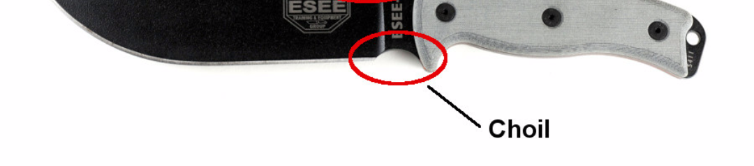

I love my ESEE 3, and have cleaned quite a few birds with it, but have no idea why anyone would use that choil.

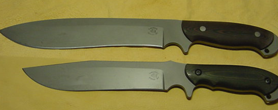

Choils are useful on larger knives to allow you to choke up on the blade for detailed or more nimble cutting . The amount of blade loss is not significant and will not impact the overall usefulness of the knife. Why to many machetes have choils? I like choils, but I do not require them.

I am a huge fan of choils on any blade over 3.5 inches...
You just get so far away from the blade with knives that size that you have little control if you want to do anything that requires more delicate type work.
Just an example, but if you want to open a package and need to cut close to the item inside, then a choil is a huge help in keeping that tip and edge where you want it.
I have no issues with a 4 inch blade that has 3.5 inches of cutting edge and a well designed and comfortable choil.....
