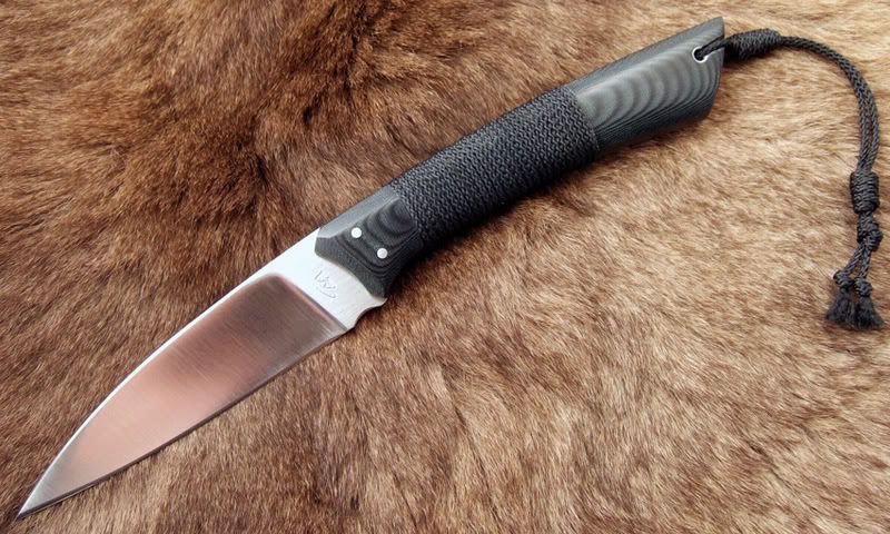

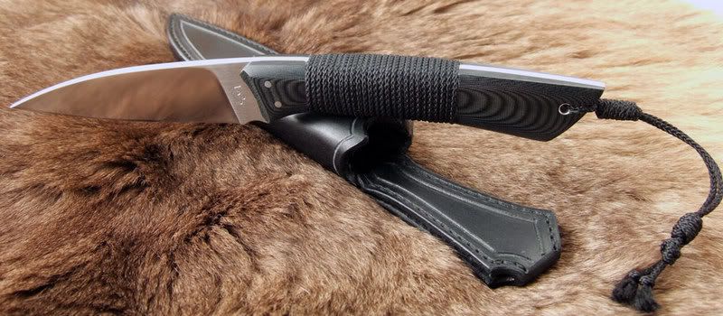

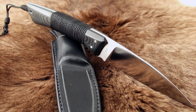

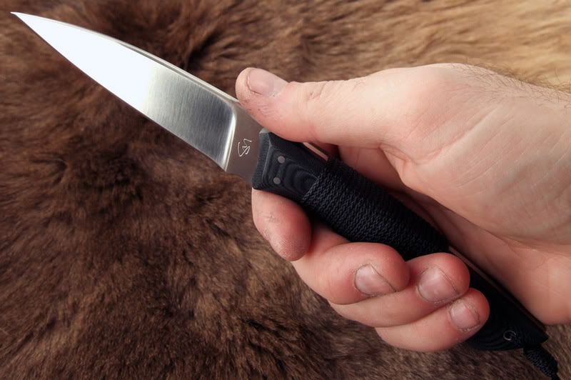

Blade made by Stuart Mitchell (UK)
I could not help modifying the blade ever so slightly.
A bit of a grind at the bottom of the ricasso and on the spine.

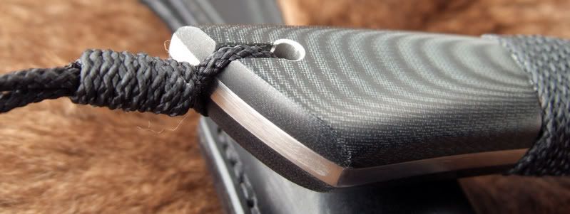

I used black linnen micarta and stainless pinns for the handle.
I filed down the handle where the wrap is, almost as much as the cord is thick.
It is "nautical" cord that is supposed to be very hard wearing, it really ads to the grip of the quite slippery micarta.

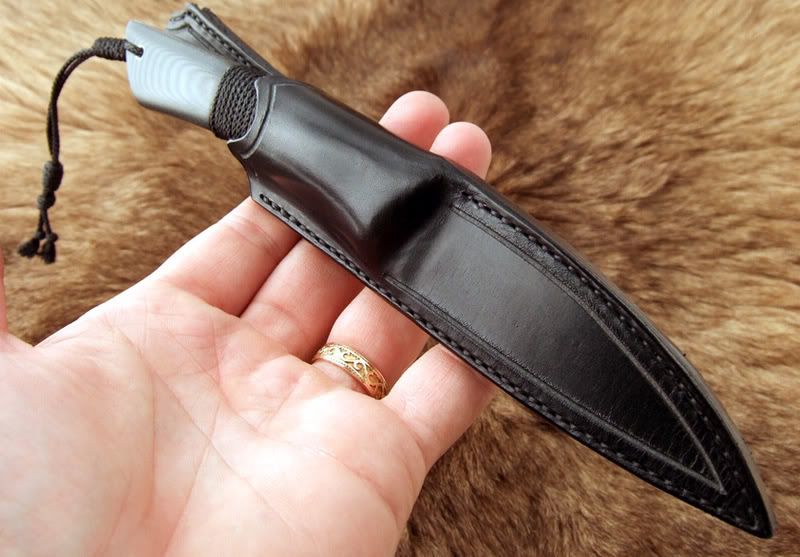

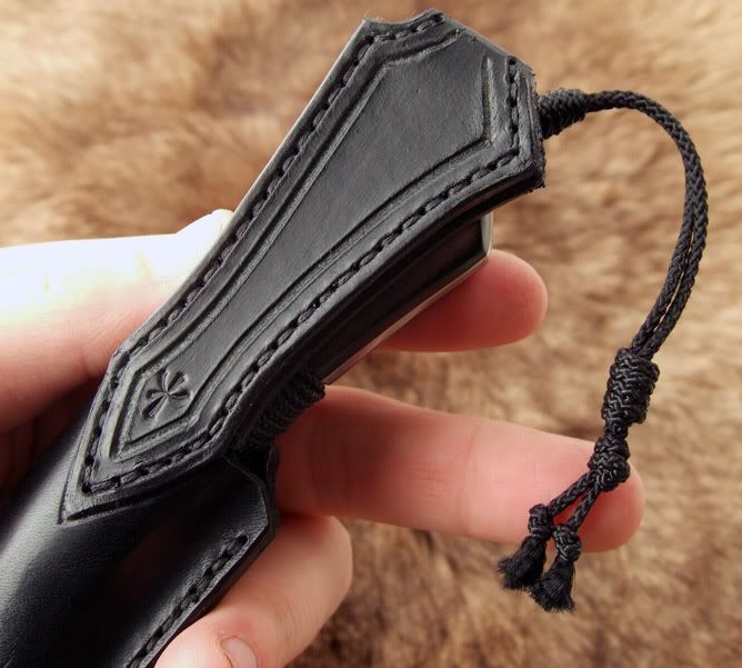

Wetshaped "pouch" style sheath.
What do you think?
Thanks for looking.
